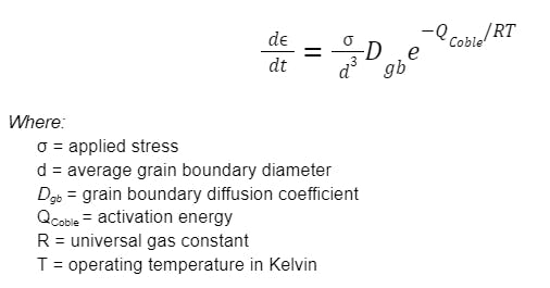

How Is the Coble Creep Rate Derived?
The Coble creep rate, like all other types of creep rate, is defined as the change in strain over time due to constant applied stress. However, in Coble creep, the diffusion of atoms is the main mechanism for deformation. The equation for the Coble creep rate is shown below:
coble creep rate derived
Coble creep equation.
From the creep equation, it can be seen that the rate of strain is directly proportional to the applied stress and inversely proportional to the grain boundary diameter. Therefore, both higher stress values and smaller grain boundary diameters lead to higher strain rates.
