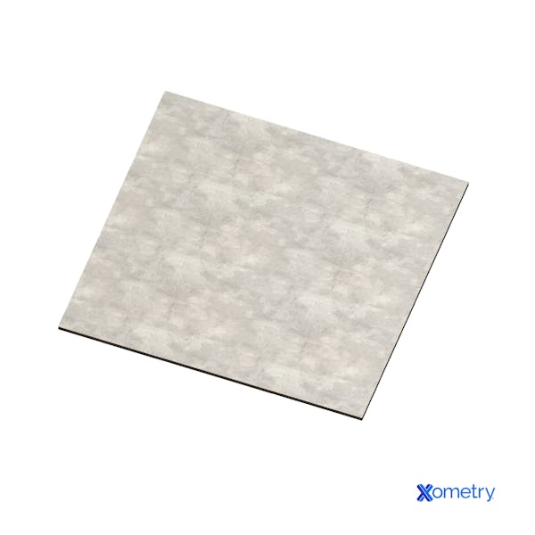

What Does Galvanized Steel Look Like?
Galvanized steel often presents a distinct silvery-gray appearance, frequently characterized by a crystalline pattern known as spangle in hot-dip variants. The surface texture results from the cooling of molten zinc after the dipping process. Individual crystals vary in size depending on the cooling rate and chemical additives used during manufacturing. Newer components exhibit a bright and reflective sheen while older pieces develop a dull gray patina over time. Smooth finishes are common in electrogalvanized variants used for automotive panels or appliance housings. Hot-dip variants show a thicker and more rugged texture suitable for heavy-duty industrial use. Visual identification remains simple due to the unique metallic flakes visible on the surface. Maintaining the aesthetic quality requires minimal effort because the zinc layer resists unsightly rust streaks. Professionals recognize the material by its characteristic weight and industrial luster. Every component presents a unique surface signature based on the specific cooling environment.

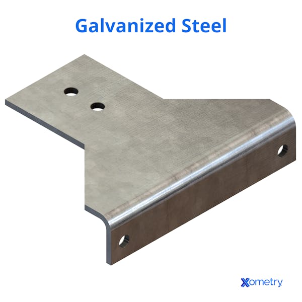

Galvanized steel bracket at Xometry
