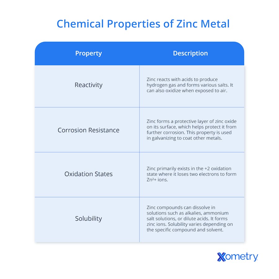

What Are the Chemical Properties of Zinc Metal?
The chemical properties of zinc metal are defined by moderate reactivity, amphoteric behavior, and controlled oxidation in atmospheric environments. Zinc reacts with dilute acids (hydrochloric acid, sulfuric acid) to release hydrogen gas and form soluble zinc salts (ZnCl₂, ZnSO₄). Zinc reacts with strong alkalis (sodium hydroxide) to form zincate ions (Zn(OH)₄²⁻), demonstrating amphoteric chemical behavior. Zinc forms a thin protective oxide and carbonate layer in air. The Protective oxide and carbonate layer commonly consists of zinc oxide and basic zinc carbonate after exposure to moisture and carbon dioxide.
The oxide layer further converts to zinc carbonate in the presence of moisture and carbon dioxide, limiting continued corrosion. Standard electrode potential equals −0.76 V relative to the standard hydrogen electrode, supporting sacrificial oxidation in galvanizing and electrochemical activity in alkaline batteries. Chemical reactivity enables alloy formation with copper to produce brass containing 5% to 40% zinc. Controlled oxidation and compound formation define the industrial chemical performance of zinc metal.
