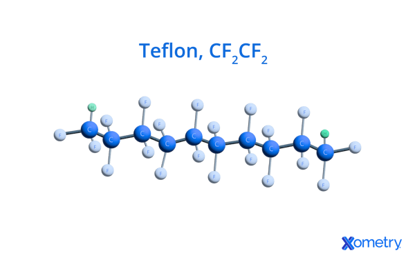

What is the Chemical Composition and Structure of PTFE?
The chemical composition and structure of PTFE follow the formula (C₂F₄)n, which indicates a polymer composed of tetrafluoroethylene monomers. Each carbon atom in PTFE is bonded to two fluorine atoms and two carbon atoms in a repeating chain. The carbon-fluorine bonds create a protective sheath around the carbon backbone of the polymer. The high electronegativity of fluorine prevents other molecules from reacting with the carbon atoms. The specific arrangement results in an inert material that resists chemical attack from acids and bases. High bond energy ensures the polymer maintains integrity under extreme thermal conditions. The uniform distribution of fluorine atoms creates a smooth surface with minimal intermolecular forces. Such a configuration explains the characteristic non-stick performance and hydrophobic behavior. Engineering designs utilize the unique Structure of PTFE to prevent adhesion in mechanical systems. Synthetic polymers with the specific bond structure provide superior insulation for electrical wiring. Chain length (molecular weight) influences mechanical properties, but density is primarily determined by crystallinity and processing conditions.
Teflon chemical structure
