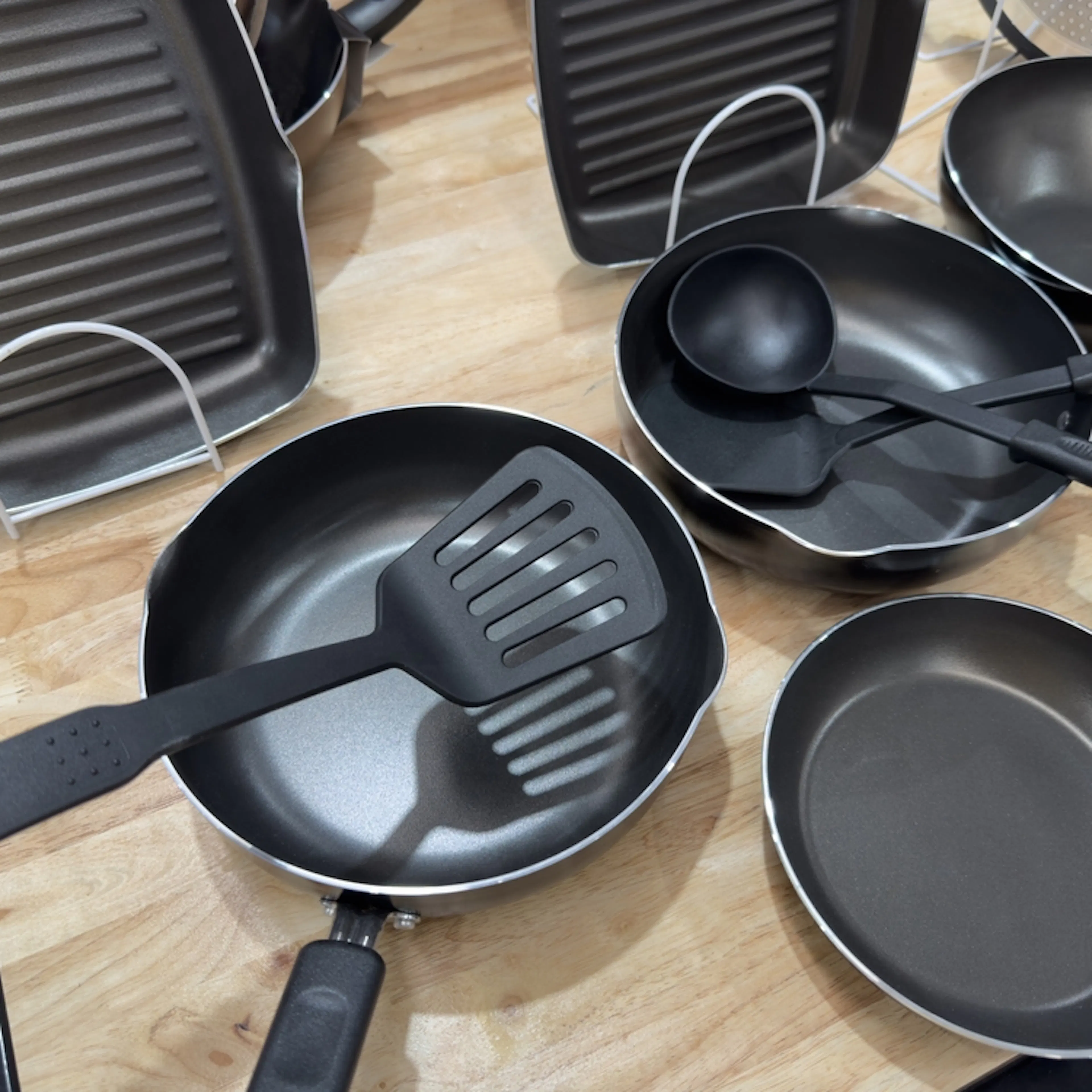

Teflon coated pans. Image Credit: Shutterstock.com/socrates471
Teflon™ coating is widely found on nonstick surfaces in cookware such as frying pans and pots. Teflon’s useful properties were discovered in 1938, and it was quickly commercialized. In the early 1950s, research indicated that although Teflon itself is inert and safe when used as intended, a compound used in its manufacture, perfluorooctanoic acid (PFOA), could be released from the finished cookware during normal use or generated when the Teflon coating is overheated. After 2014, manufacturers phased out the use of PFOA in Teflon production. The current version of Teflon is widely considered by healthcare professionals and manufacturers to be safe to use.
This article will discuss what Teflon coating is and whether it is considered safe to use.

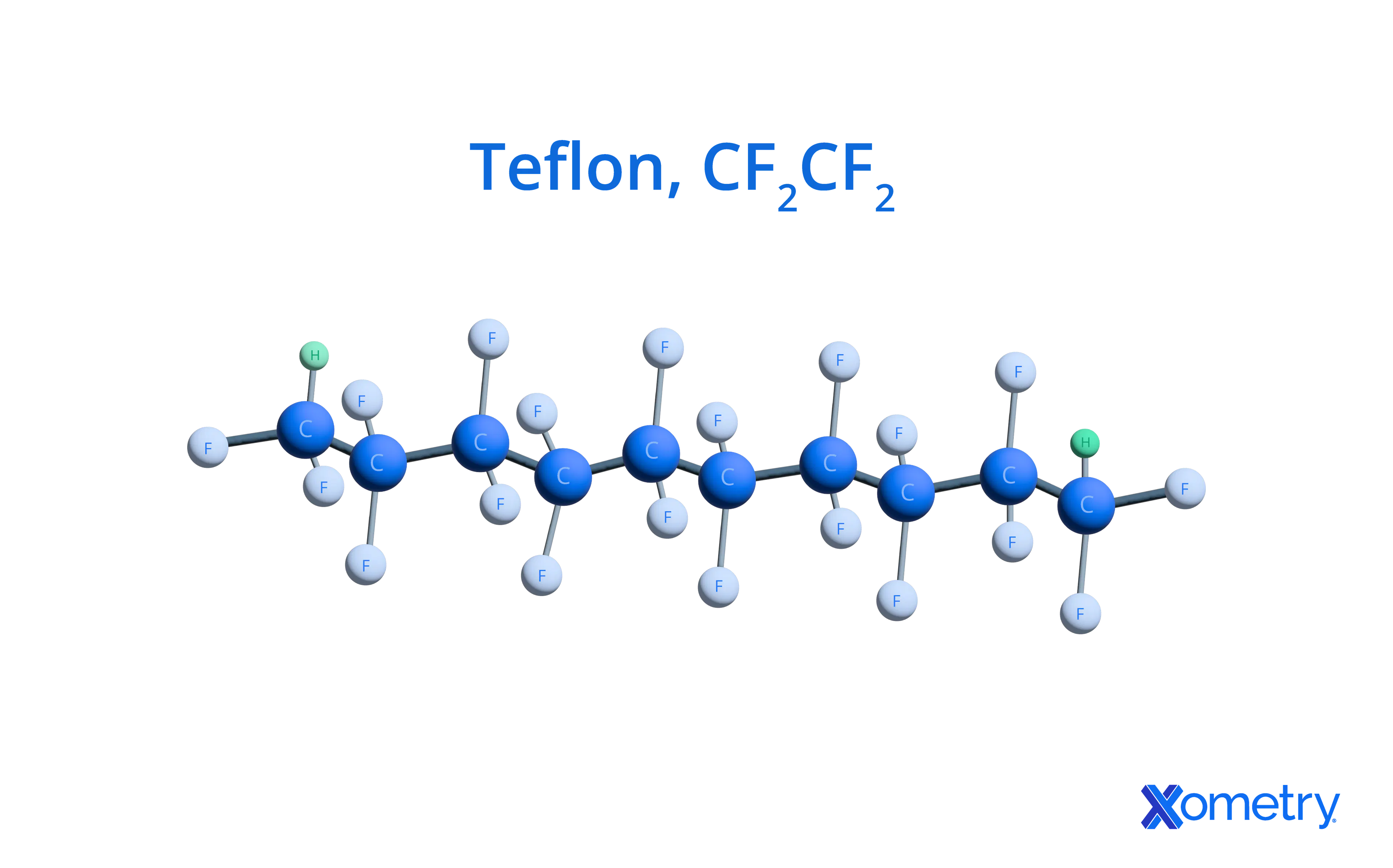

Teflon or polytetrafluoroethylene (PTFE) is made from the elements carbon (C) and fluorine (F). These elements are arranged in chains of carbon (C) atoms single-bonded to each other to fill two of the four bonding sites on each carbon atom, with the other two bonding locations each filled by a fluorine (F) atom. Figure 1 shows the structure of the fluorocarbon chain that makes up Teflon:
Teflon chemical structure
Teflon is made by first synthesizing the building blocks of the polymer chain and then linking them together. The individual “links” in the Teflon polymer chain, called monomers, each consist of two carbon atoms double-bonded to each other, with each carbon also bonded to two fluorine atoms. These monomer molecules form a compound known as tetrafluoroethylene (TFE, with the formula C2F4). While this is the general process, the specific industrial methods for synthesizing TFE can vary and are often proprietary.
TFE can be made by reacting sulfuric acid (H2SO4) with the mineral fluorspar (CaF2) to form hydrofluoric acid (HF) at a high temperature. The hydrofluoric acid serves as a source of fluorine atoms for a reaction in which the chlorine (Cl) atoms are stripped from chloroform (trichloromethane, or CHCl3) atoms and replaced with fluorine atoms to yield tetrafluoroethylene (TFE) monomer for Teflon.
TFE is an explosive gas, so it is normally processed as soon as possible into the final PTFE polymer by radical polymerization. Radical polymerization is a process in which a small amount of a so-called “radical initiator,” e.g., ammonium persulfate, (NH4)2S2O8, acts as a catalyst to kick off the polymerization process. The exact procedure is usually guarded by manufacturers as a trade secret. The processes used can yield PTFE in the form of grains that are processed into molded pellets or a milky paste that is processed into a fine powder.

Are Teflon Pans Toxic?
No. Modern (post-2014) pans coated with Teflon, used as directed, are not considered toxic. Before 2014, a chemical used in the manufacture of Teflon, PFOA (perfluorooctanoic acid), was found to present several potential human health risks. It was replaced by alternative compounds in the PFAS (per- and polyfluorinated substances) family, which are considered to be safer during Teflon production. In most major markets around the world, manufacturers phased out PFOA around 2014. The nonstick Teflon pans produced today are widely accepted to be safe for everyday cooking, with the condition that they are not used at temperatures over 500°F (260°C).

Although modern Teflon products are considered safe when used as directed, following proper care guidelines can help maintain the integrity of the nonstick coating and minimize any potential risks. There are several ways in which the potential risks posed by Teflon-coated cookware can be minimized. Nearly all of them relate to taking care not to damage the coating. Below are 6 ways to reduce the possible risks of Teflon coatings on cookware:
1. Never Heat an Empty Pan
Heating an empty pan results in the pan itself getting very hot, much hotter than if the heat were transferred into food being cooked. This is important because the hotter the coating gets, the more likely it is to give off toxic gas fumes. When heated over 660°F (350°C), the coating has the potential to deteriorate. However, by heating the pan only when the food to be cooked is already in it, this risk is reduced.
2. Keep Your Kitchen Well Ventilated
Stovetop areas should be installed with proper ventilation, consisting of a hood to trap fumes and a ventilation fan to route them outdoors or to filter and recirculate the air. The exhaust fan is intended to direct smoke, grease, and moisture out of the kitchen, but it can also eliminate any chemical fumes that might be given off by overheated Teflon-coated cookware.
3. Replace Old Pots and Pans
When pots and pans have reached roughly 3000 baking cycles, the coating on them will start to break down. It is currently understood that the small pieces of coating that chip off of old pots and pans are safe to consume. However, it is good practice to replace old pots and pans, as it wasn’t realized that PFOA in pots and pans had the potential to be toxic until they had been used for decades.
4. Use Wooden, Silicone, or Plastic Utensils
Using wooden, silicone, or plastic utensils is safer than using metal utensils since they will not scratch or flake off the Teflon coating on your cookware. Wood, plastic, and silicone are all softer than the Teflon coating, which means that the coating is more likely to wear away the utensils than vice versa. This reduces the potential risk of any of the coating contaminating the food.
5. Cook at Low and Medium Heat Settings
Since Teflon is known to begin to decompose and give off fumes above a temperature of 500°F (260°C), it is best to use Teflon-coated cookware at low and medium heat settings. For example, it should not be used for broiling.
6. Hand Wash Your Cookware
Hand washing cookware can minimize damage to the Teflon coating to a certain extent, as using a dishwasher or abrasive pads has the potential to scratch the Teflon coating, which is then more likely to chip and contaminate food when cooking. However, Teflon nonstick pans are designed to have a coating that is guaranteed for the life of the pan. The engineering of the nonstick coating is designed to resist peeling, chipping, and flaking. Therefore, it is not essential to hand wash your cookware as it can withstand the high temperatures of the dishwasher and will not be eroded.
