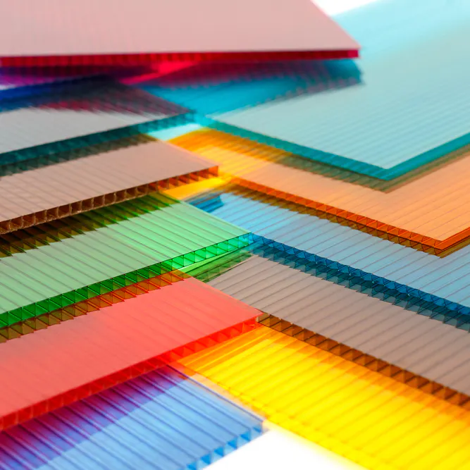

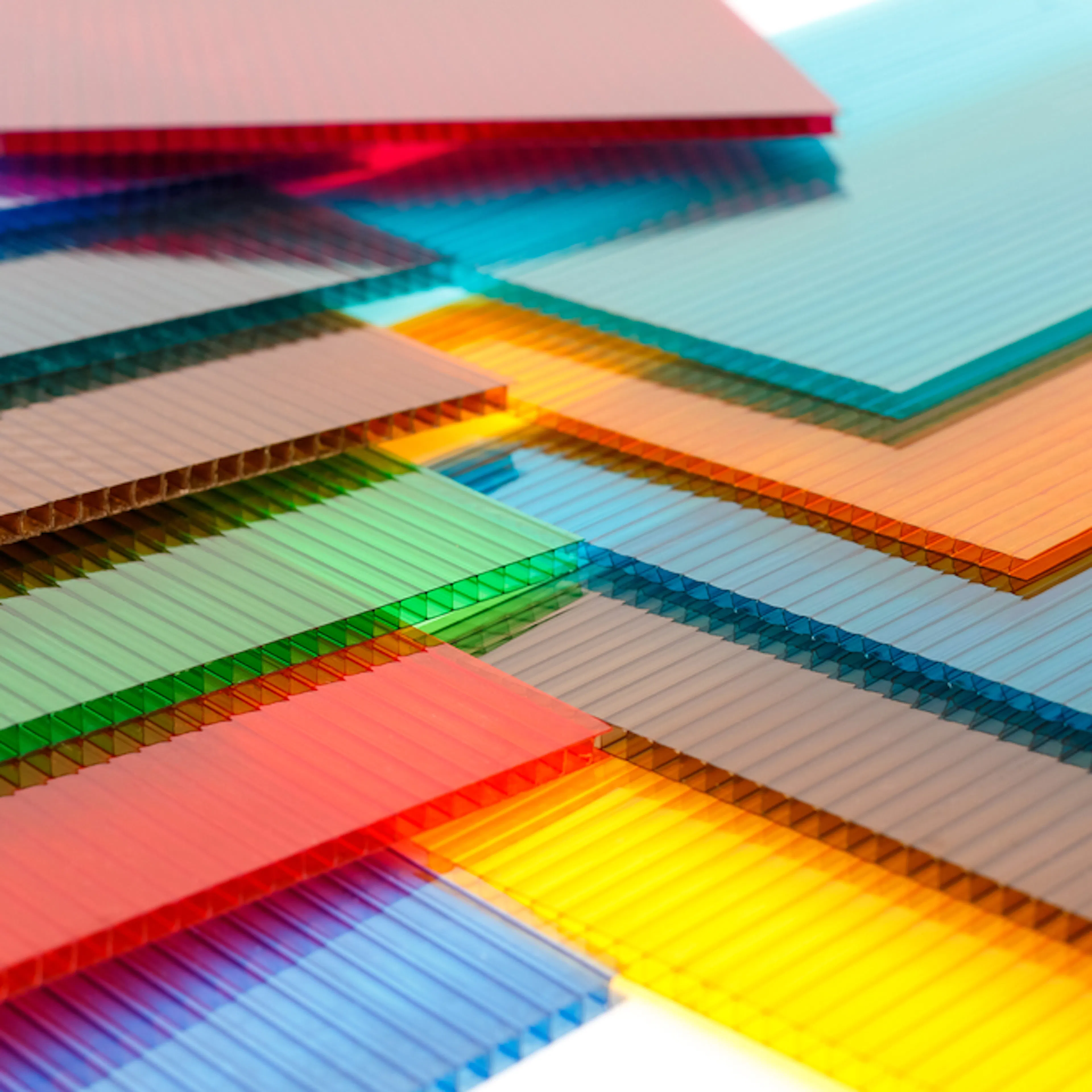

Colorful stack of polycarbonate sheets. Image Credit: Shutterstock.com/Cat Us

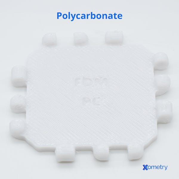

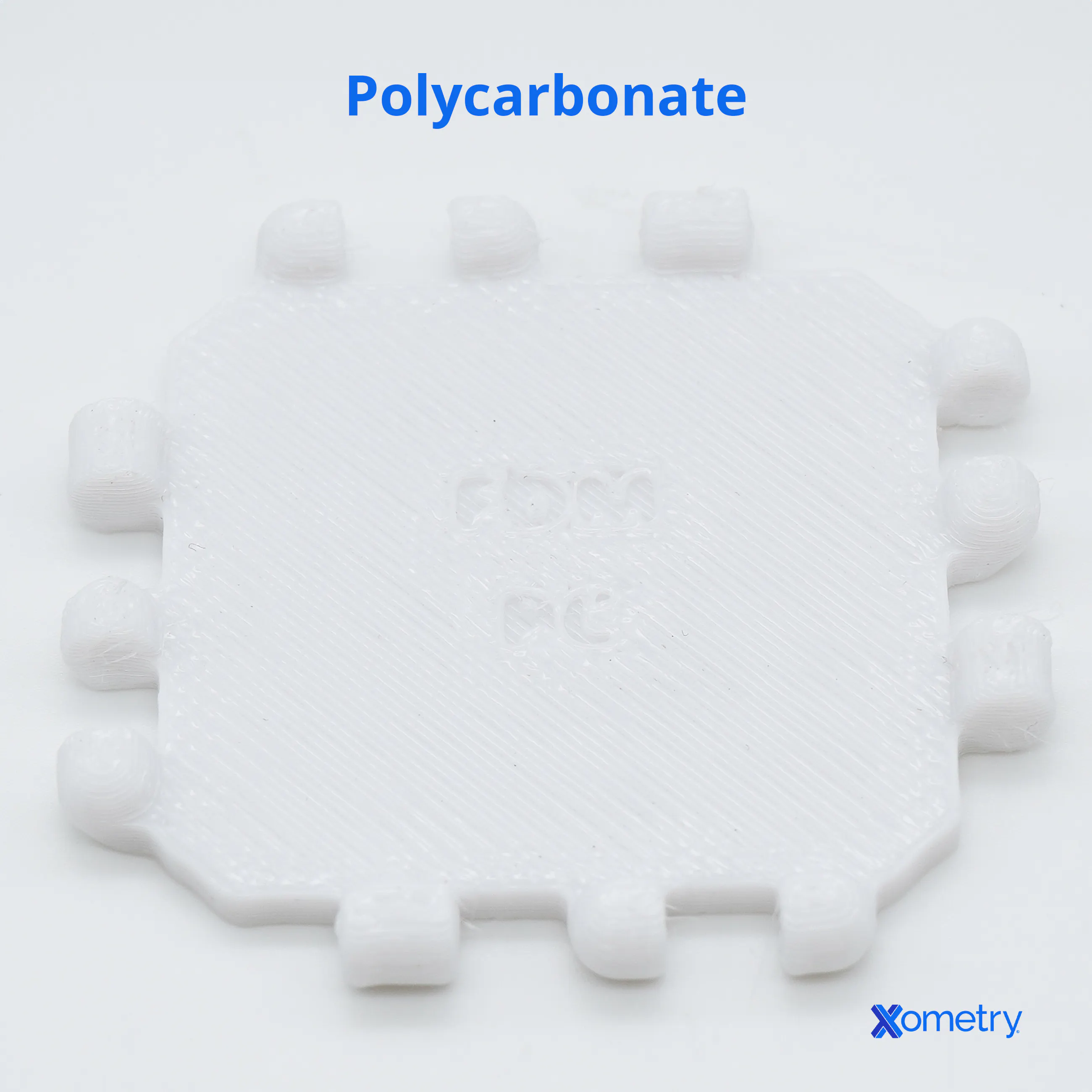

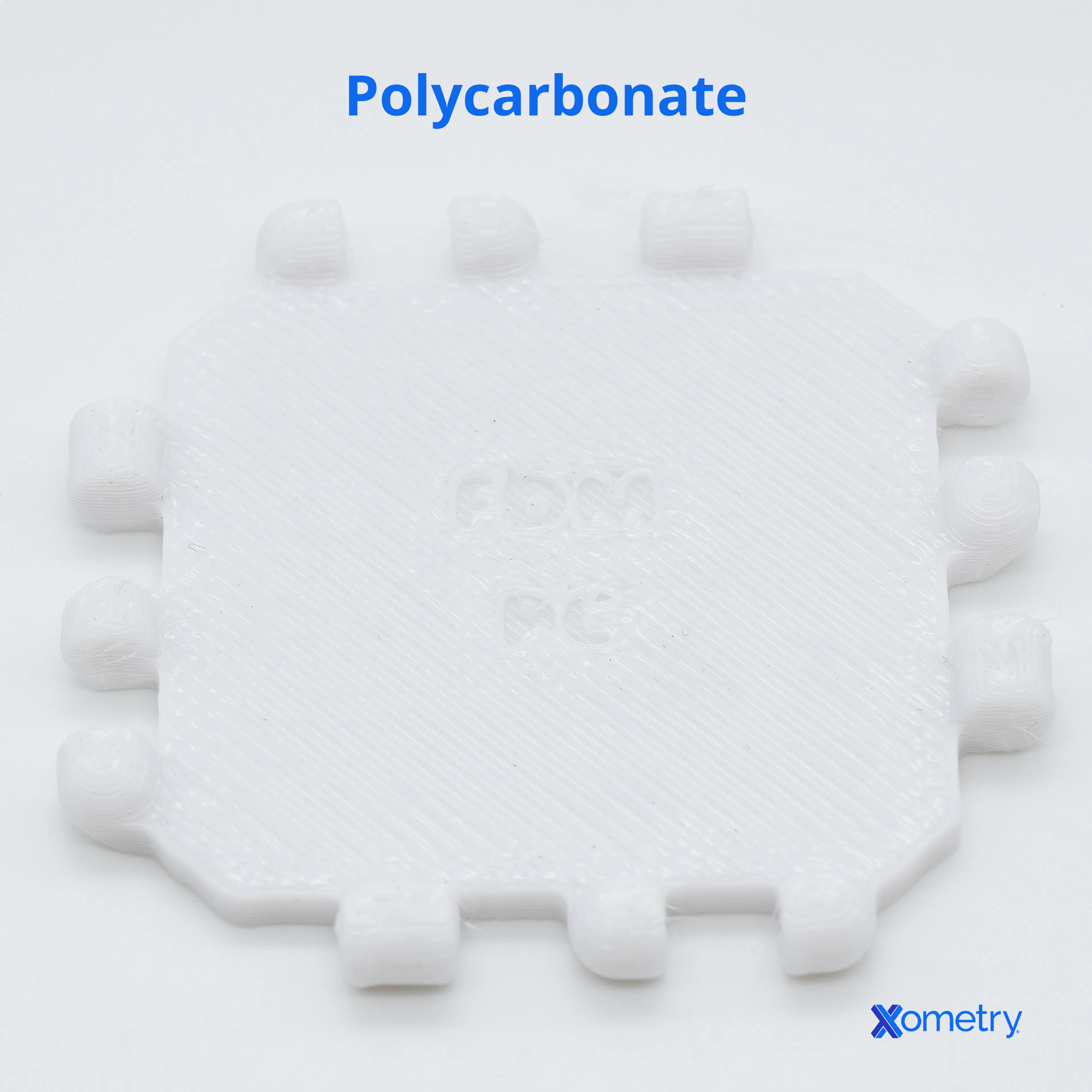

Plastic often has a reputation for being cheap and relatively easy to break, which isn’t fully true for polycarbonate. Although it is indeed a rigid plastic, its strength is capable of standing strong against bullets, holding heavy objects without buckling, and handling drops or falls. Polycarbonate has a pretty high melting point (around 295 °C), and it’s not one to break and crack under stress, unlike other thermoplastics out there. It’s an amorphous material, which means it’s not very crystalline and its chemical compounds don’t have a structured chain — making it easy to mold, shape, and remain intact. To give you an idea of what it looks like, you can see a Xometry “X” below that was 3D printed in polycarbonate.
Polycarbonate is a common replacement for materials, like silicate glass, because it tends to be stronger and cheaper. Because of its ability to stay clear without deforming, polycarbonate is a great optical choice. It’s also popular for a variety of different manufacturing processes, whether you’re interested in injection molding or cutting sheets.
A Polycarbonate 3D Printed Part
An example of a Polycarbonate 3D Printed Part by Xometry
