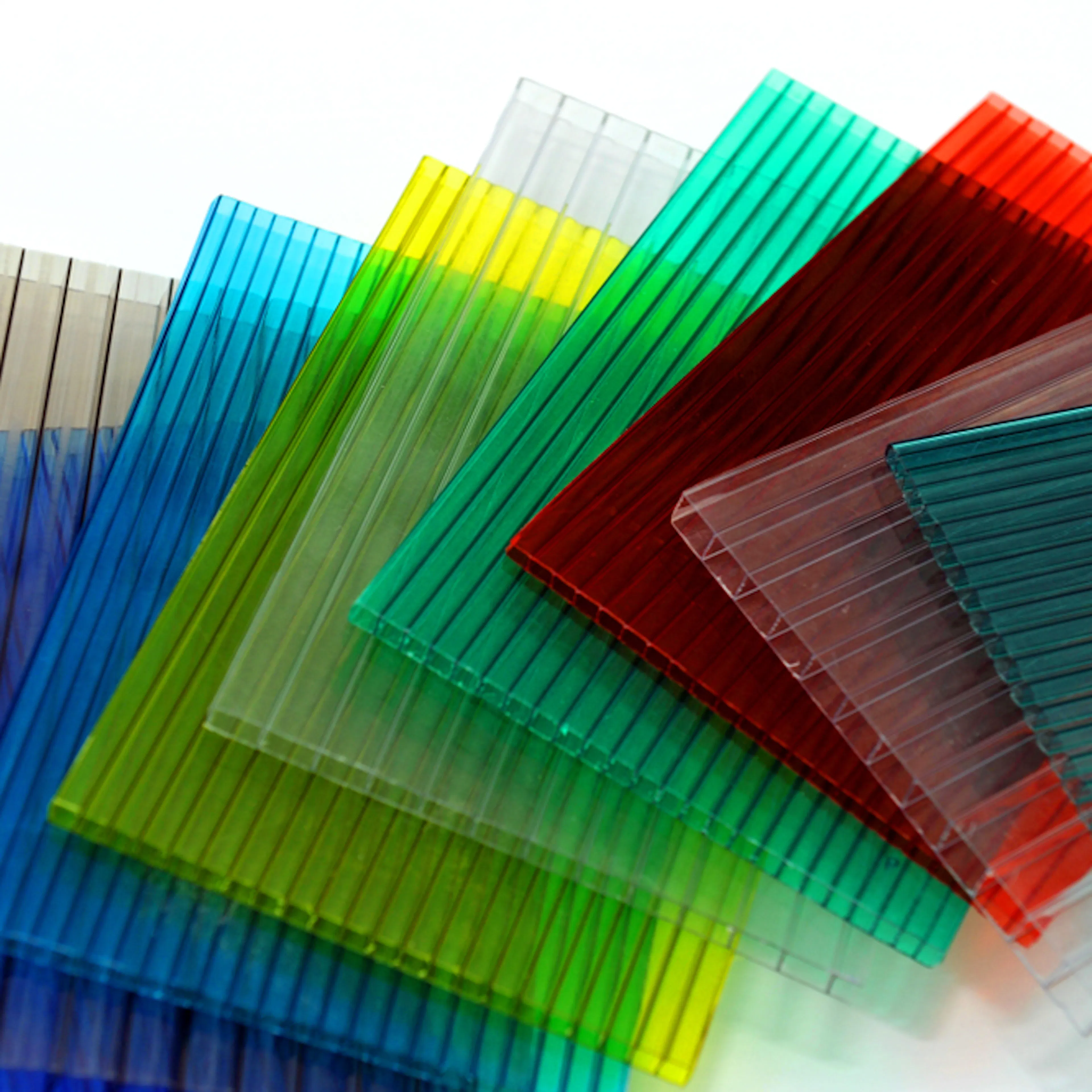

Colorful polycarbonate sheets. Image Credit: Shutterstock.com/4level
