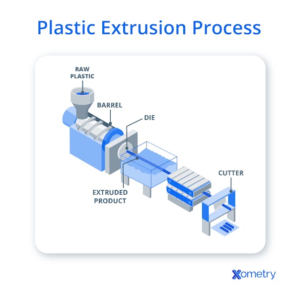

How Does Extrusion Molding Work?
The plastic extrusion process can be divided into four main steps:
  1. Adding Additives: The base material is mixed with different additives like: colorants, stabilizers (for oxidative stability, heat, UV stability, etc.), fillers, flame retardants, reinforcements, lubricants, etc., which are chosen based on the specific requirements of the end product.
  2. Melting the Material: Plastic materials are fed into the hopper and directed through the feed-throat to the barrel. The material descends into the annular space between the screw and the barrel, confined by the screw channel. As the screw turns, it propels the polymer forward, subjecting it to frictional forces. The barrels undergo gradual heating with a temperature profile that increases steadily. Progressing from the feed zone to the metering zone, the combined effects of frictional forces and barrel heating induce plasticization, homogenization, and kneading of the material, preparing it for the subsequent stages of the plastic extrusion process.
  3. Shaping: Upon leaving the barrel, the molten material, driven by the rotating screw, passes through screens at the barrel's end. These screens serve a dual purpose: they eliminate foreign bodies and contaminants from the molten plastic while maintaining a uniform pressure throughout the system. The increased temperature and malleability achieved through this process prepare the material for the next crucial step—forming the desired shape by pushing it through a die. The shape of the die dictates the ultimate form of the extruded plastic product.
  4. Cooling: Following the shaping of the molten plastic through the die, the next phase is cooling. This can be achieved through several cooling rolls or a water shower. The cooling process is vital to ensuring that the extruded plastic profile retains its intended shape.
After the extruded product has been cooled it may undergo extra processes, such as: further flame treatment, cutting, printing, annealing, deodorization, etc. The extrudate will then be subject to inspections to ensure that the product meets the desired quality.
An illustration of the plastic extrusion process.
