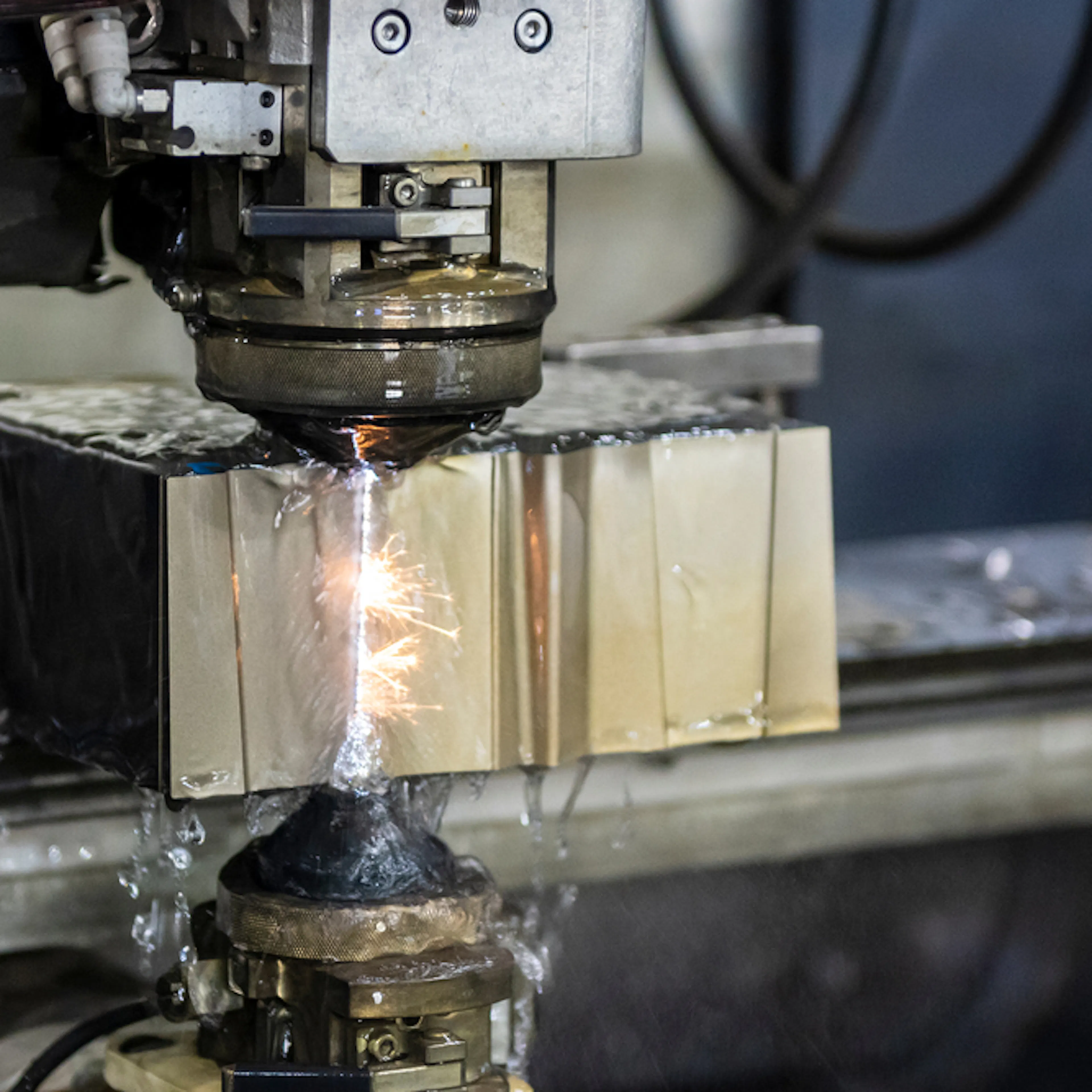

Wire EDM
Wire EDM (Electrical Discharge Machining) uses a continuously moving thin wire electrode (brass or coated copper) to cut intricate two- or three-dimensional shapes in conductive materials. The wire moves through the material, eroding it by spark discharge, without any mechanical contact. Wire EDM is commonly used in industries that require high-precision cutting of hard metals and intricate geometries. It's frequently applied in aerospace, automotive, medical device manufacturing, and mold-making for producing parts like turbine blades, dies, and precision components.

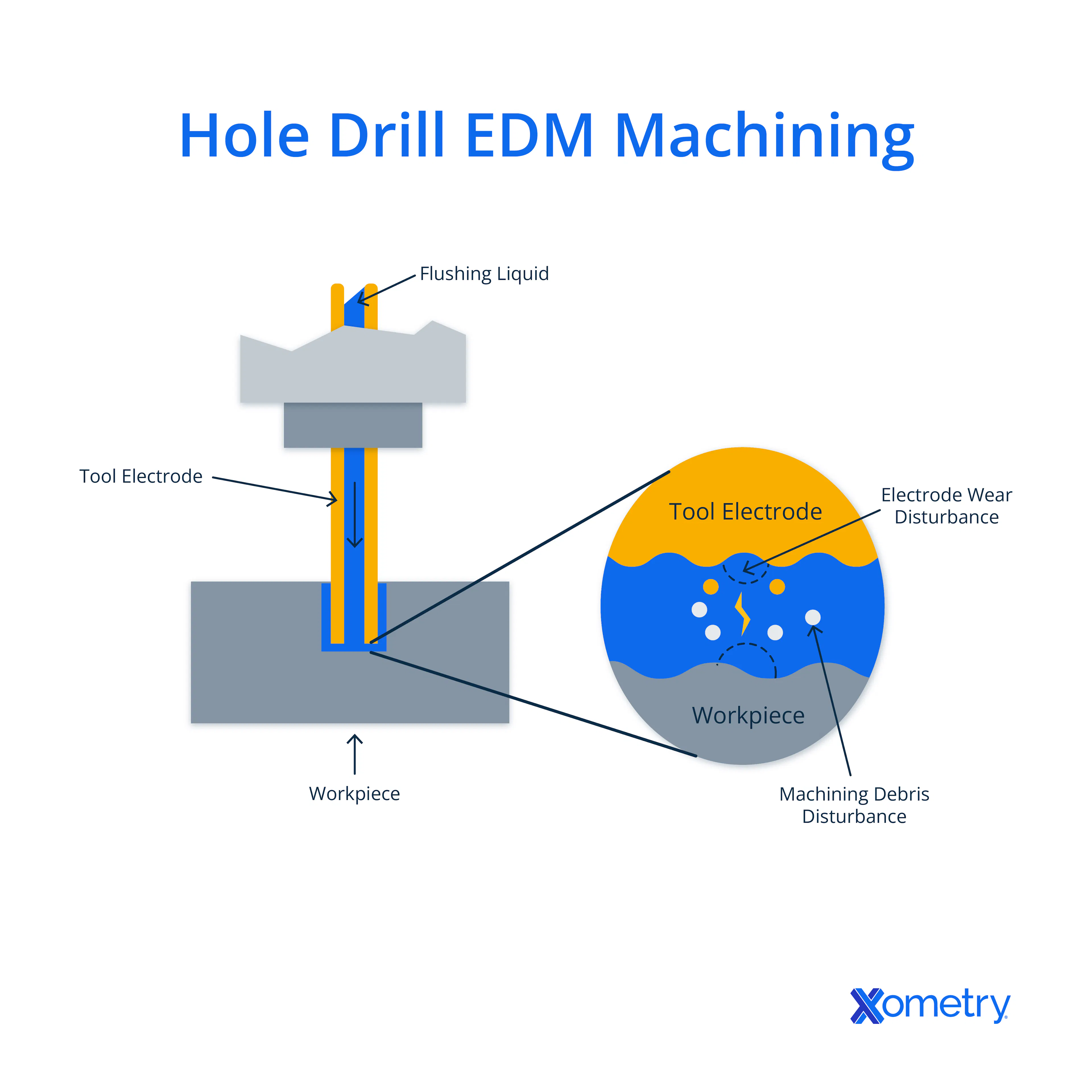

Hole Drilling EDM
Hole Drilling EDM employs a rotating hollow tube electrode to create small-diameter, deep holes in conductive materials. High-pressure dielectric fluid flows through the electrode to flush out eroded material and prevent short circuits during the drilling process.
Hole Drilling EDM is commonly used in aerospace, automotive, and electronics industries for creating cooling channels, jet engine components, and intricate hole patterns in hard metals, where conventional drilling methods are not effective.
Hole Drill EDM Machining
