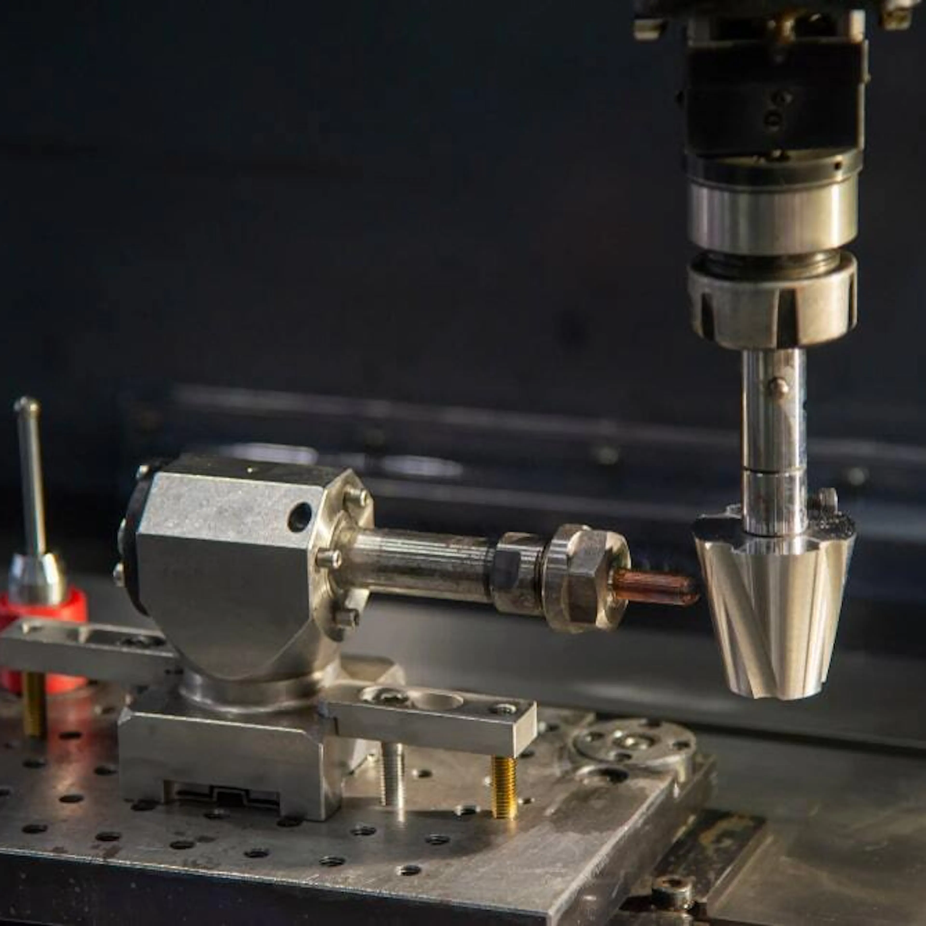

How Does a Sinker EDM Machine Work?
A sinker EDM machine works by generating controlled pulsed DC discharges between a shaped electrode and an electrically conductive workpiece submerged in dielectric fluid. Applied voltage exceeds dielectric strength across a regulated spark gap ranging from 0.005 mm to 0.5 mm (5–50 µm), causing dielectric breakdown and plasma channel formation. Localized temperatures of approximately 8,000 to 12,000°C produce melting and partial vaporization of microscopic material. The sparks erode material without contact, eliminating mechanical cutting forces.
The dielectric fluid (hydrocarbon-based EDM oil) insulates prior to breakdown, cools components, and flushes debris through filtration. A closed-loop servo system maintains a stable spark gap, and CNC control regulates multi-axis positioning and pulse parameters (peak current, pulse duration, duty cycle). Repeated discharges erode material to form a cavity that reflects the inverse geometry of the electrode, accounting for spark overcut and electrode wear.
What Happens During the EDM Machining Process in Sinker EDM?
Removal of material happens during the Electric Discharge Machining (EDM) process in Sinker EDM. A shaped electrode moves toward a conductive workpiece submerged in dielectric fluid. A pulsed voltage creates sparks across a small gap once electrical breakdown occurs. Electrical discharges melt and vaporize material to form a cavity. Each spark produces a tiny crater, and repeated pulses deepen the cavity with precision.
The dielectric fluid cools and flushes debris from the spark gap. Circulating fluid solidifies molten particles and clears eroded fragments to maintain stable sparking conditions. Stable flushing preserves accuracy and surface consistency. The electrode guides the erosion process, while the workpiece material is removed to form a cavity that reflects the electrode’s geometry. The cavity replicates the electrode profile because material removal follows the spark path. Controlled advancement maintains a constant gap until the desired depth and contour are achieved, completing the EDM machining process.
Does a Sinker EDM Machine Remove Material Using Electrical Sparks?
Yes, a Sinker Electric Discharge Machining (EDM) Machine removes material using electrical sparks. EDM erodes conductive material through controlled electrical discharges formed between a shaped electrode and the workpiece submerged in dielectric fluid. Electrical energy creates intense heat that melts and vaporizes microscopic portions of the surface. The dielectric fluid cools the zone and removes debris to maintain a stable spark gap.
No mechanical cutting force is involved. The electrode does not physically contact the workpiece, and material removal occurs through thermal erosion rather than pressure. The absence of cutting force reduces vibrations and tool deflection, though other factors (machine dynamics, flushing conditions) may still influence stability. The process protects thin walls and delicate geometries from distortion. The method preserves dimensional accuracy because no external force alters the material structure.

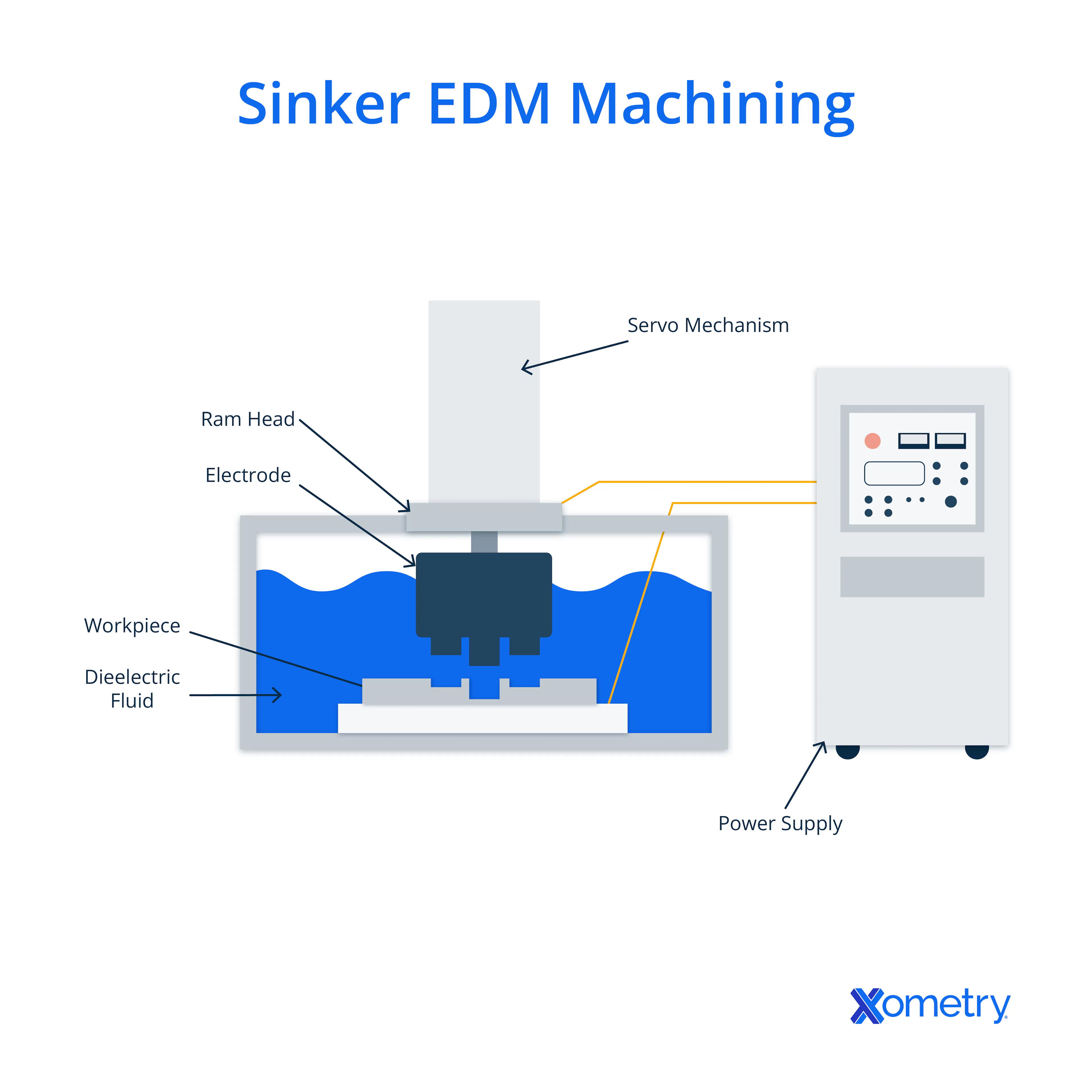

What is an EDM Machine Diagram?
An EDM machine diagram is a labeled technical illustration that shows the components and spark gap system of an Electrical Discharge Machining unit. The diagram identifies the electrode, the power supply, and the dielectric tank arranged around the workpiece. The spark gap appears between the electrode and the workpiece, representing the controlled space where electrical discharges occur. The drawing outlines how the power supply creates a pulsed voltage potential, causing electrical discharges (sparks) across the gap rather than continuous current flow.
The layout clarifies the relationship between the electrode position, gap distance, and dielectric fluid circulation. An EDM diagram illustrates system components and their interaction, but actual setup and alignment require machine calibration and operational procedures beyond the diagram. The illustration defines the operational structure and purpose of an EDM Machine Diagram.
What Components are Shown in an Electrical Discharge Machining Diagram?
Components shown in an Electrical Discharge Machining Diagram are listed below.
  • Electrode: Determines the cavity shape by serving as the discharge tool. Electrical sparks form between the electrode and the workpiece across a controlled gap. Material erodes according to the electrode geometry.
  • Power Supply: Generates pulsed electrical energy required for spark formation. The unit regulates voltage and current to maintain stable discharges. Controlled pulses influence erosion rate and surface finish.
  • Dielectric System: Circulates insulating fluid (EDM oil or deionized water) around the machining area. The fluid cools the spark zone and removes debris particles. Stable flushing preserves gap consistency.
  • Worktable: Secures and supports the workpiece during machining. The structure maintains alignment under controlled positioning. Stable mounting protects dimensional accuracy.
  • CNC Controller: Controls electrode movement through programmed coordinates. The CNC controller manages electrode positioning and motion, while a servo control system specifically regulates and maintains the spark gap.  Automated positioning ensures accuracy in the Electrical Discharge Machining Diagram.
Does an EDM Machine Diagram Include the Electrode System?
Yes, EDM Machine Diagram (the Electrode System). The diagram clearly displays the electrode assembly within the spark gap structure. The illustration shows the electrode holder, positioning mechanism, and the controlled gap formed between the electrode and the workpiece. The electrode remains central to spark generation because electrical pulses pass through the electrode before crossing the gap to erode material.
The diagram highlights the electrode geometry since cavity formation follows the exact contour of the electrode surface. Material removal replicates the electrode shape during repeated discharge cycles. The visual layout confirms the structural role of the Electrode System in defining cavity shape and spark formation.
