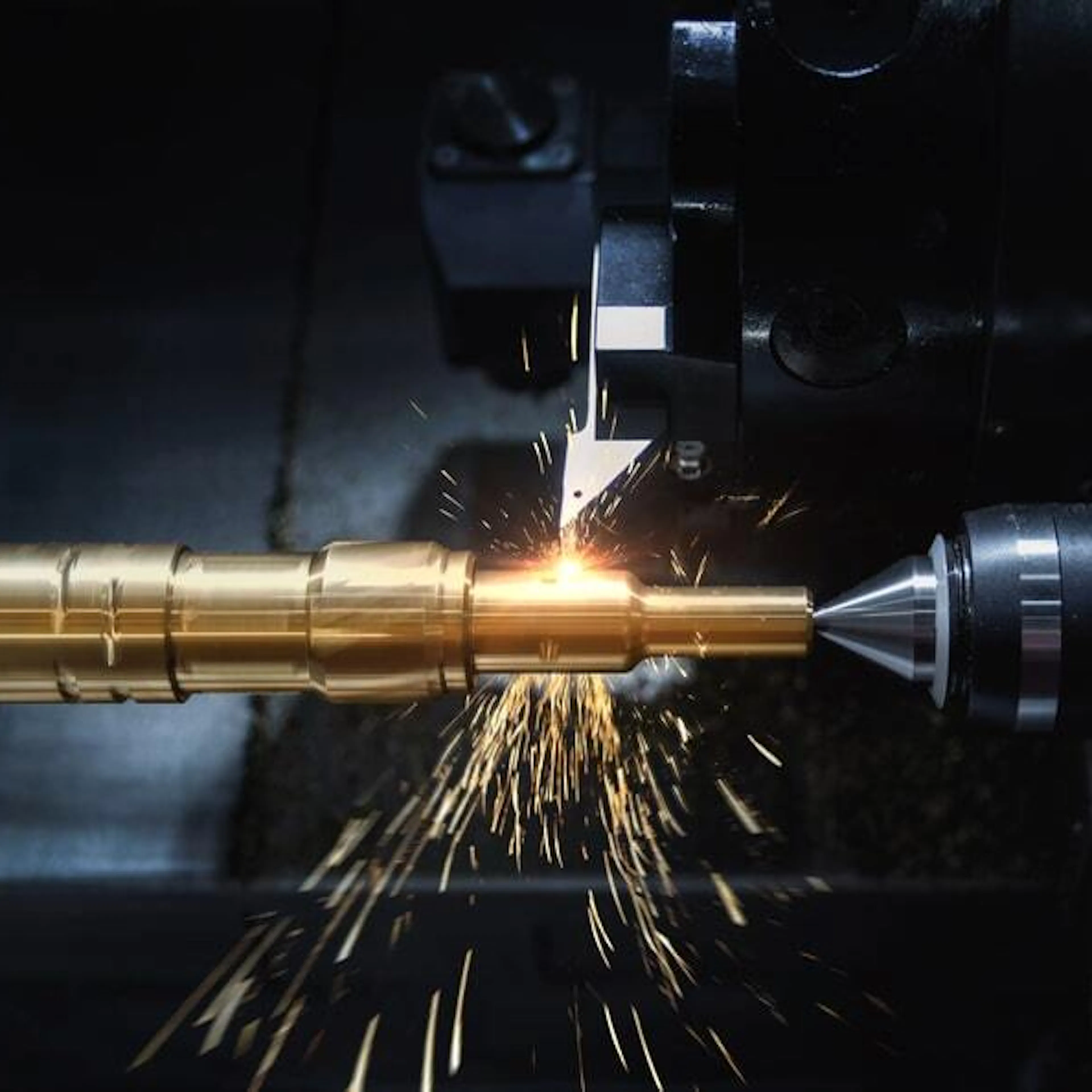

CNC machining is a subtractive manufacturing process that uses equipment such as mills, lathes, drill presses, and saws to create highly precise parts. Computer-Aided Design (CAD) data is developed during the product design phase. This CAD data is then used as the basis for programming and optimizing the machine tool sequences and paths. The material is then cut using tools such as end mills and drill bits to form the desired part geometry. Auxiliary machinery, such as honing, hobbing, or grinding machines, may also be required to produce parts to customer specifications.

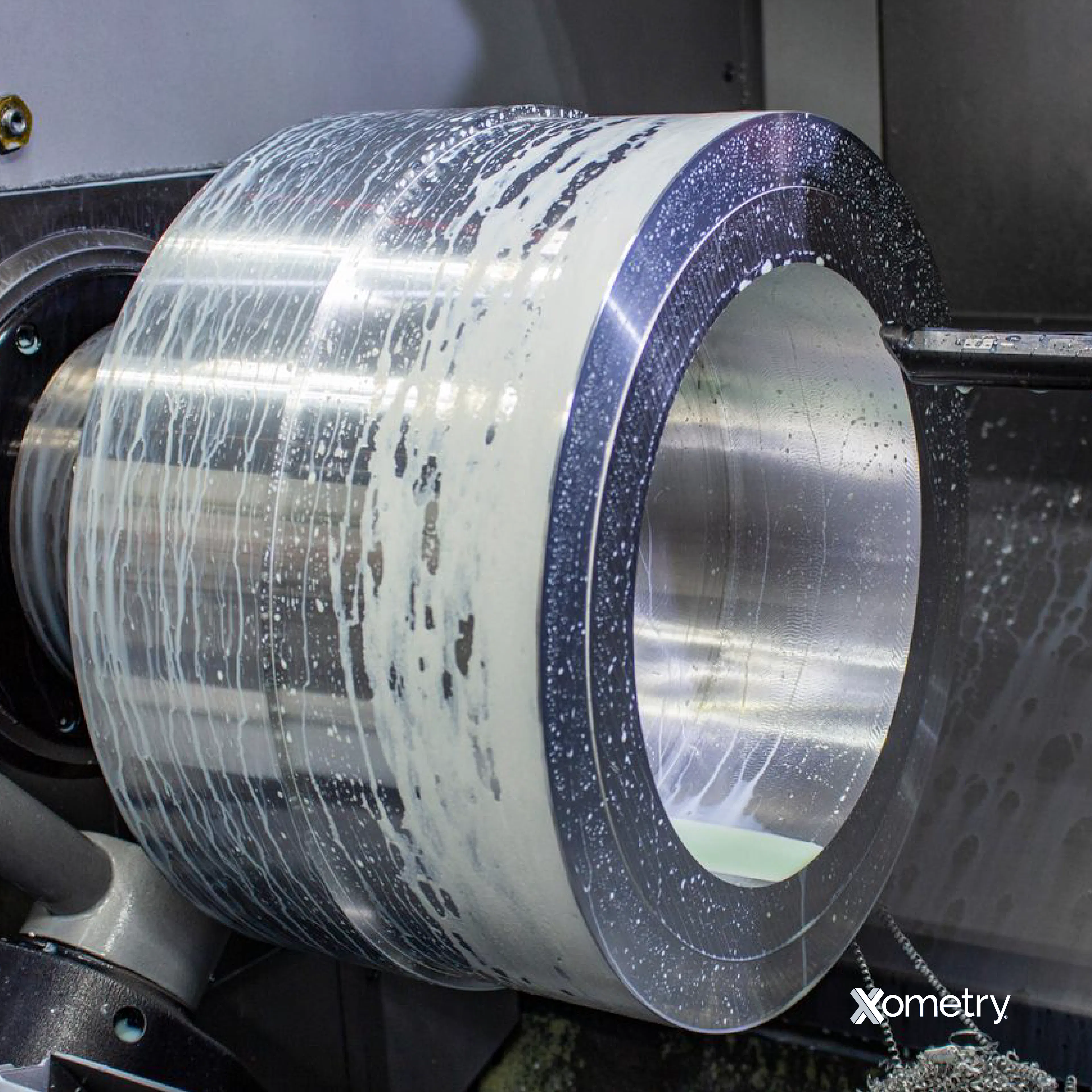

Circular metal part
This type of metal part is more easily made with CNC machining than injection molding

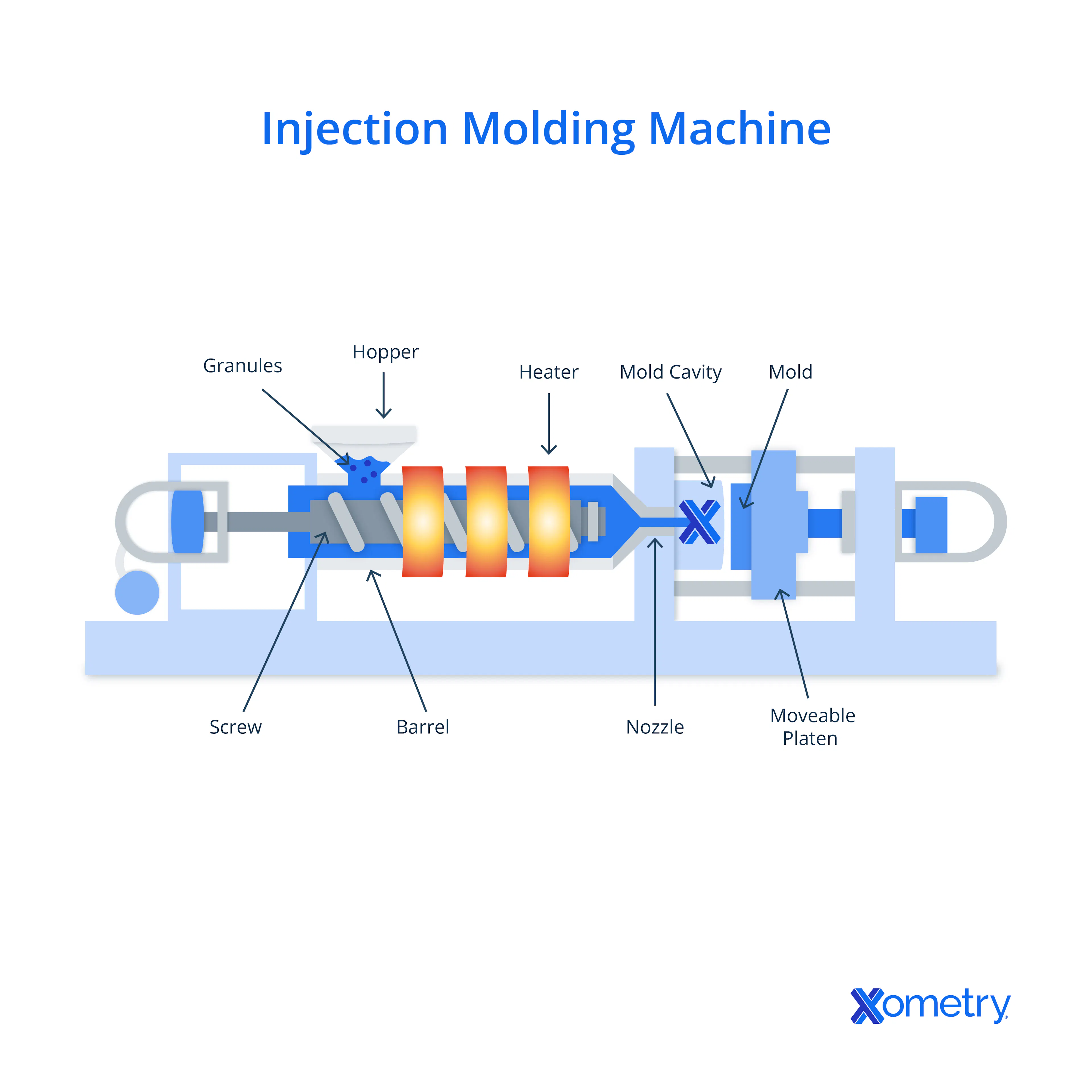

Plastic injection molding is a manufacturing method that uses an injection molding machine (IMM) consisting of major components such as an injection unit (screw and barrel), a clamping unit, and a mold. Plastic pellets are fed into the barrel and are melted through the rotation of the screw and heater bands. The molten plastic is injected into the mold and formed into the geometry of the part. The IMM maintains holding pressure after injection to compensate for material shrinkage until the parts have solidified sufficiently to be ejected. The completed parts are ejected, and the cycle restarts.

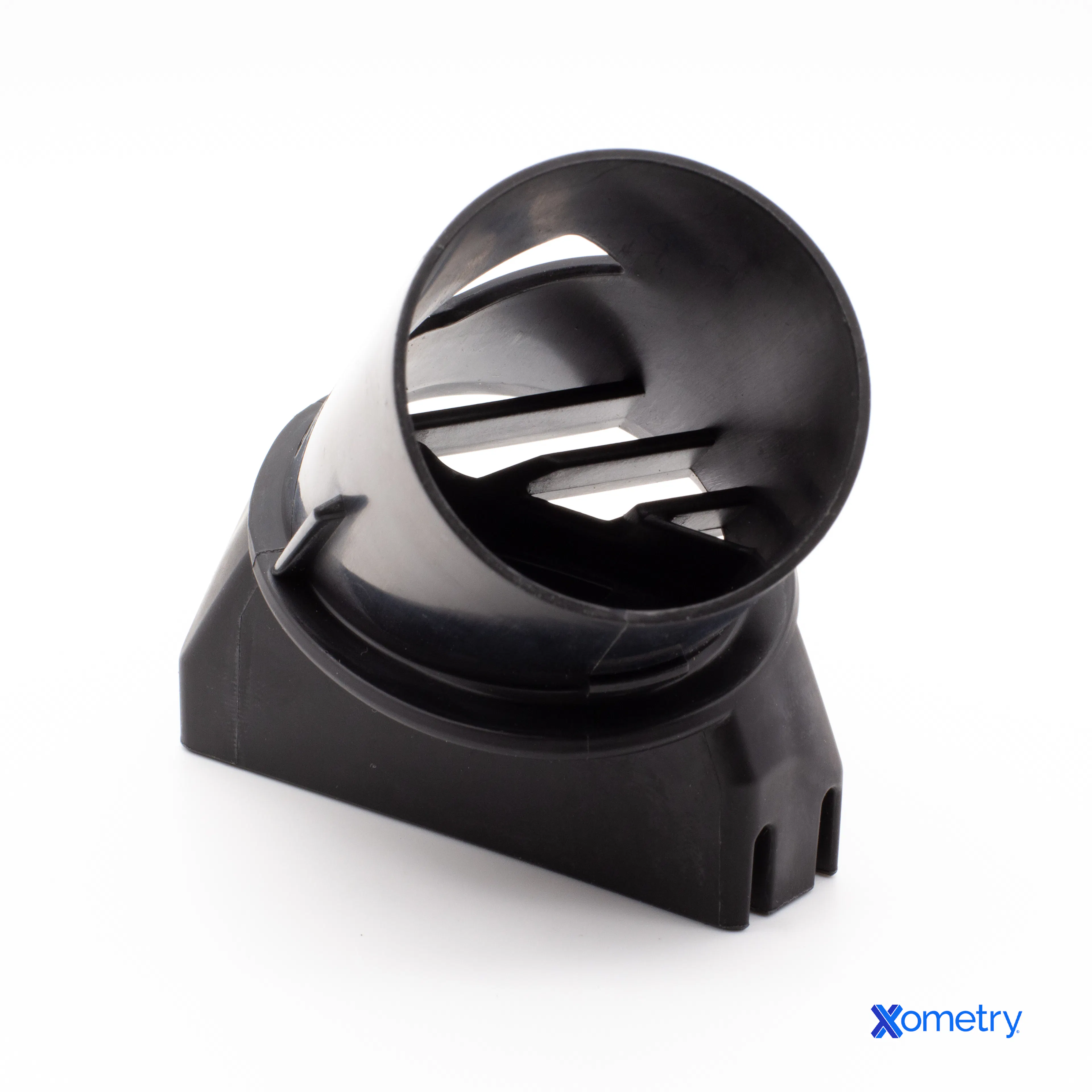

A high quality injection molded part
This type of plastic part is more easily made with injection molding than CNC machining.
