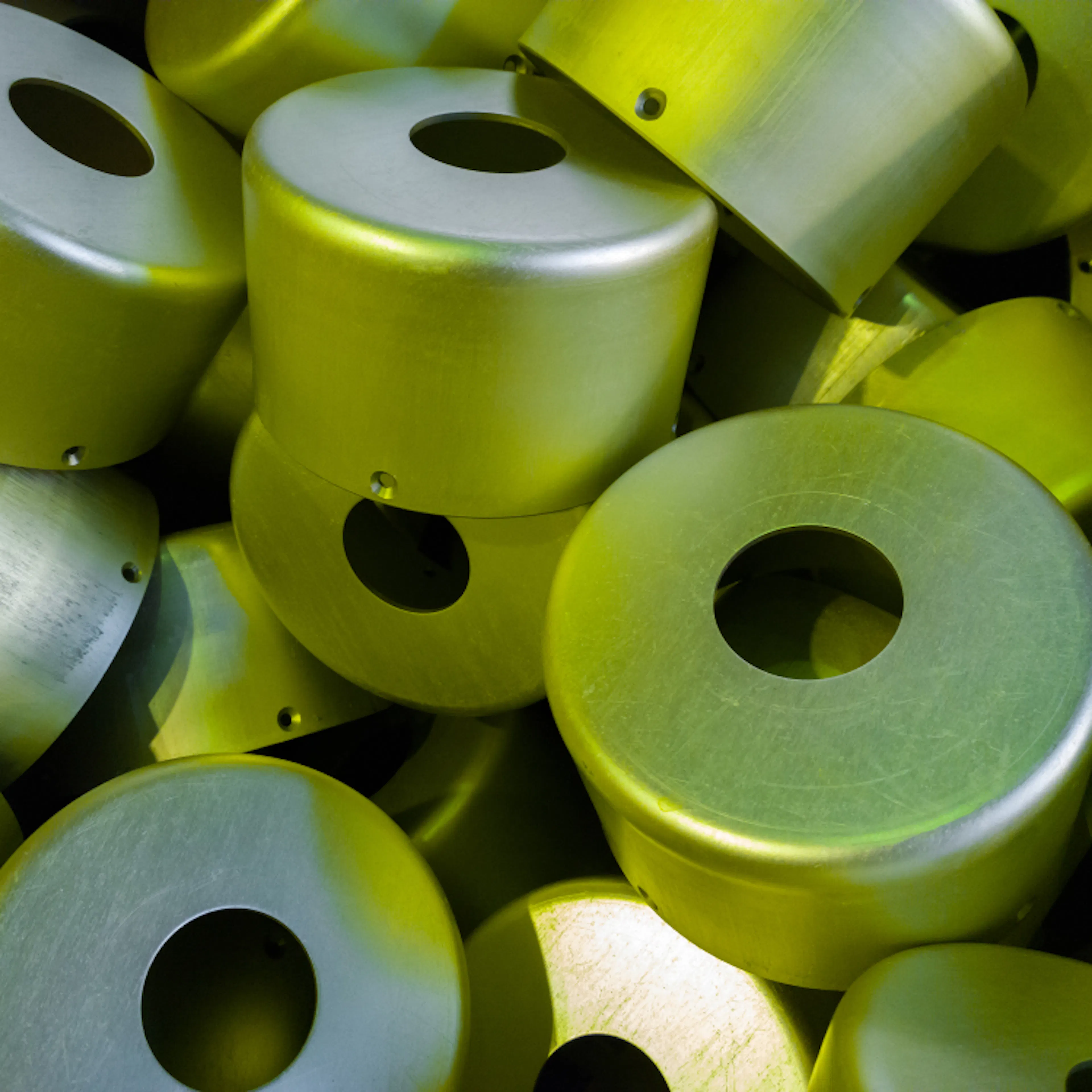

Sulfur oxidated anodized aluminium parts. Image Credit: Shutterstock.com/teh_z1b
Anodizing involves creating an artificial oxide layer on the surface of a non-ferrous alloy, aluminum-based alloys being the most traditional, and hard coat, also known as Type III anodizing, provides the most durable layer of them all (between 400 and 600HV on the Vickers scale). Also known by its U.S. military specification of “MIL-PRF-8625F,” the process can also make the surface electrically resistant, causing it to act like an insulator. Hardcoat anodize on Xometry's platform conforms to MIL-A-8625/MIL-PRF-8625, Type III, Class 1/2 with finishing certs provided. To learn more about this fabricating process and how it works, read on.

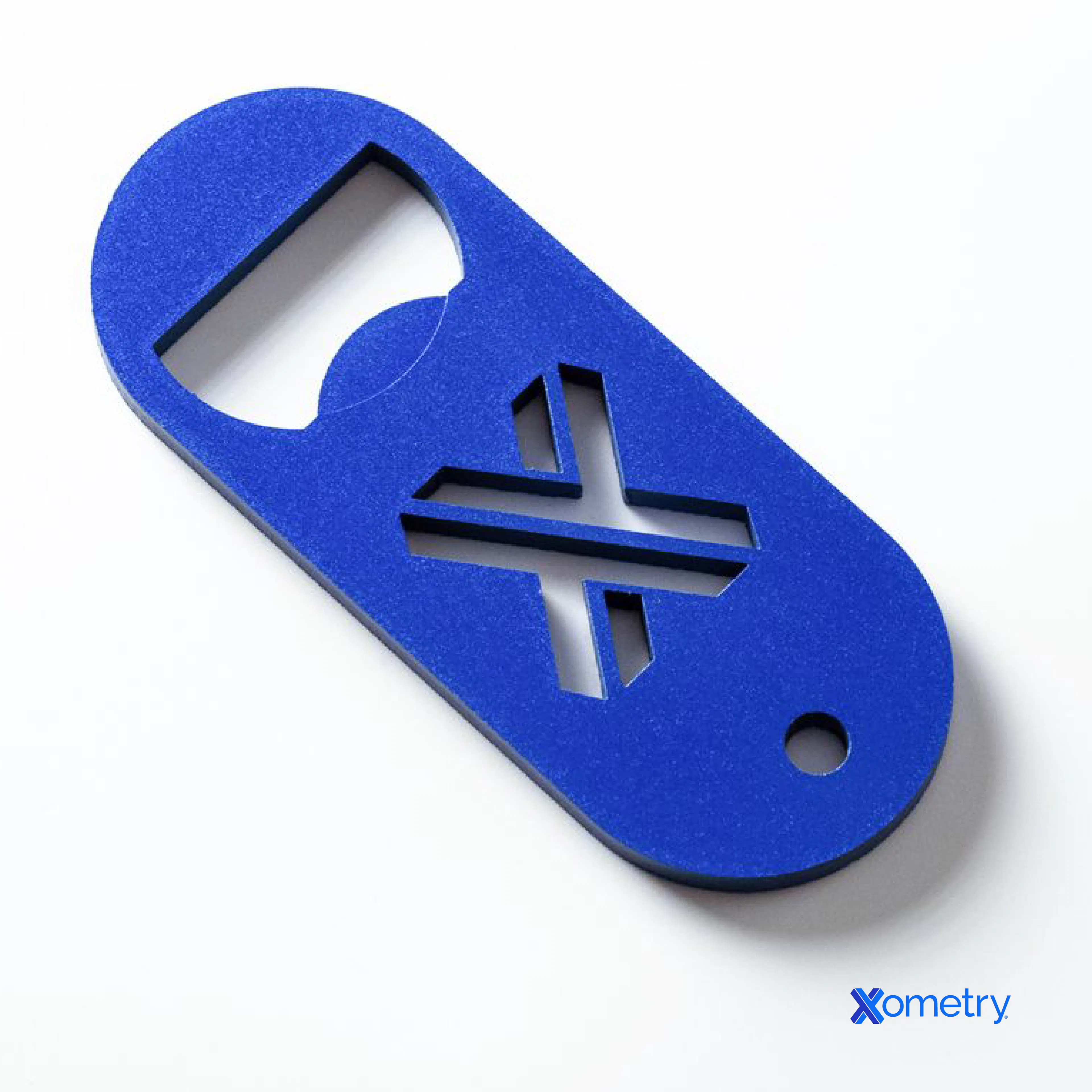

This type of anodizing requires a higher voltage than the others—it usually starts at around 25V DC and goes up to 60–100V as it goes on—because the oxide layer will become less conductive as it gets thicker, so turning up the voltage will make up for this. You can also control the thickness of the new layer by adjusting things like the temperature of the electrolytes, the voltage, the concentration of acid, and how long it’s in there. This is an image of an anodized aluminum part we made here at Xometry:
An anodized aluminum part
