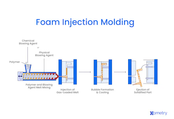

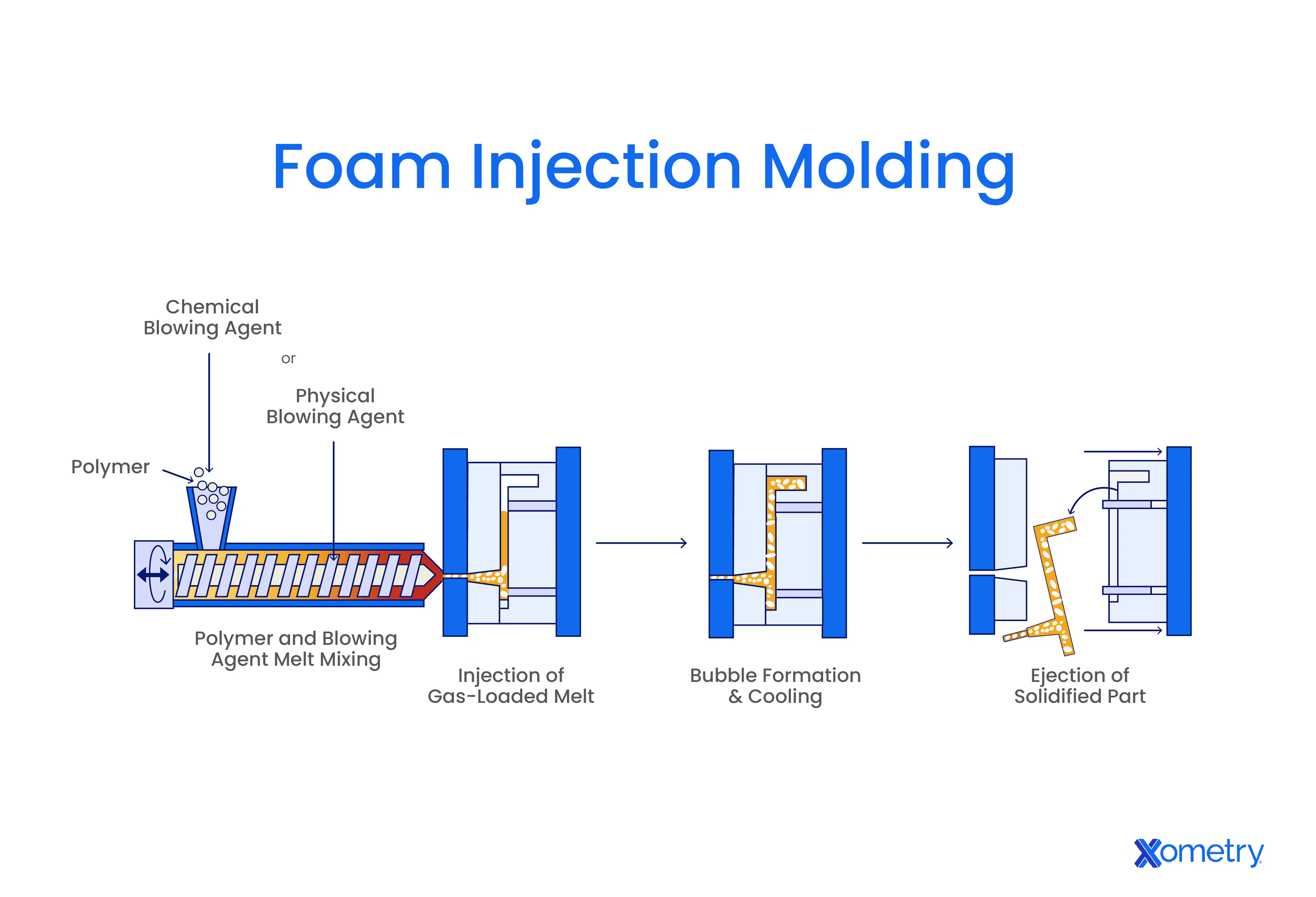

How Does Foam Injection Molding Work?
Foam Injection Molding works by introducing a polymer blend and a blowing agent into a mold cavity under controlled conditions. The blowing agent activates and releases gas as the polymer heats and begins to melt, forming bubbles that expand within the material. The interaction between injection pressure and flow rate determines the distribution and density of the foam structure. High pressure drives the material into the mold, regulating the expansion of gas bubbles and stabilizing the foam core to maintain the integrity of the outer shell.
The foaming process reduces material density without compromising surface strength or dimensional accuracy. Industrial applications of foam molding include lightweight panels in automotive interiors, protective inserts in packaging systems, and reduced-weight components in consumer products. The foam molding process enables efficient production while delivering parts that meet the structural, thermal, and economic requirements of multiple sectors. The balance between pressure control and foaming behavior defines the final characteristics of each molded part.
