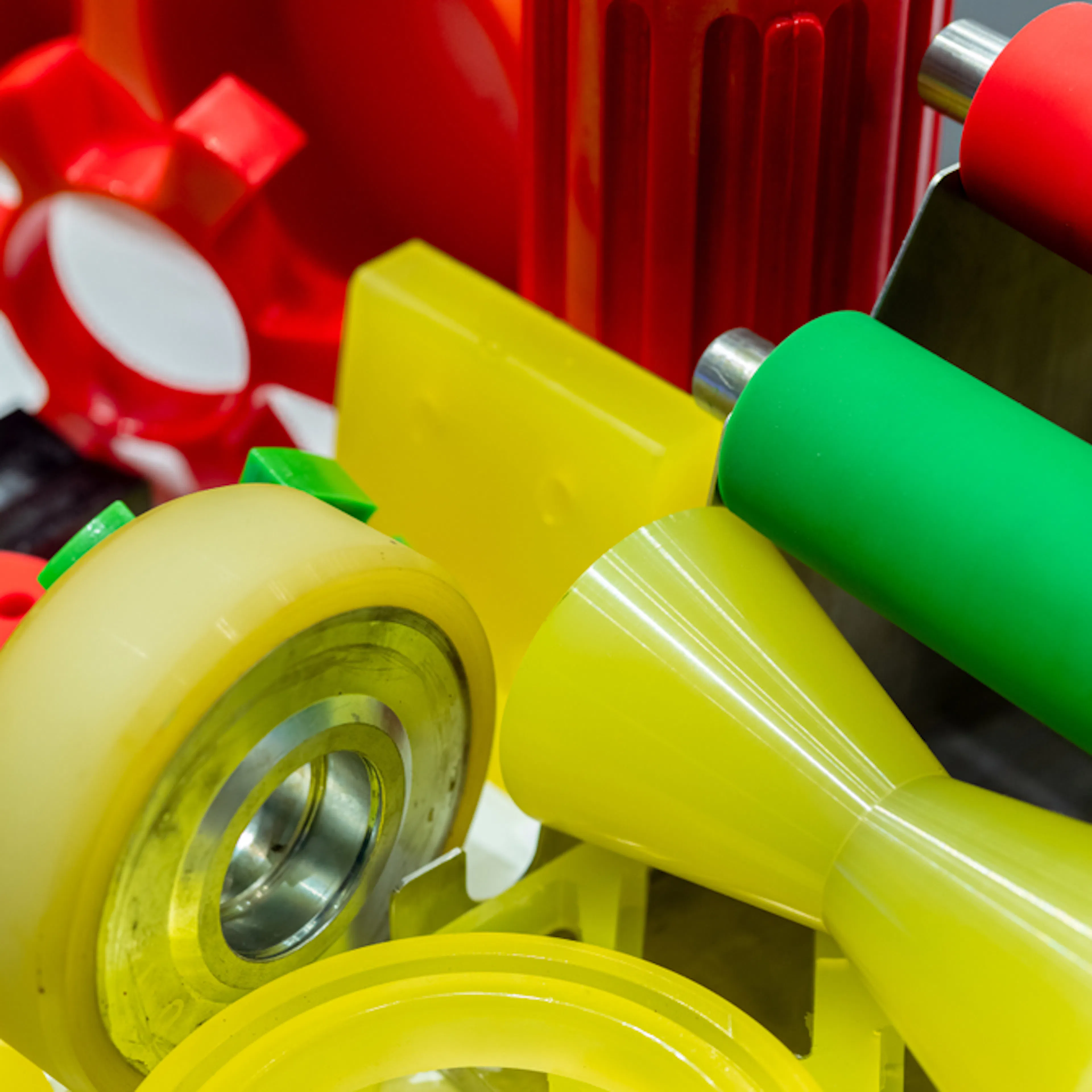

A photograph of a polyurethane gear
What Manufacturing Methods Are Best To Use With Polyurethane?
