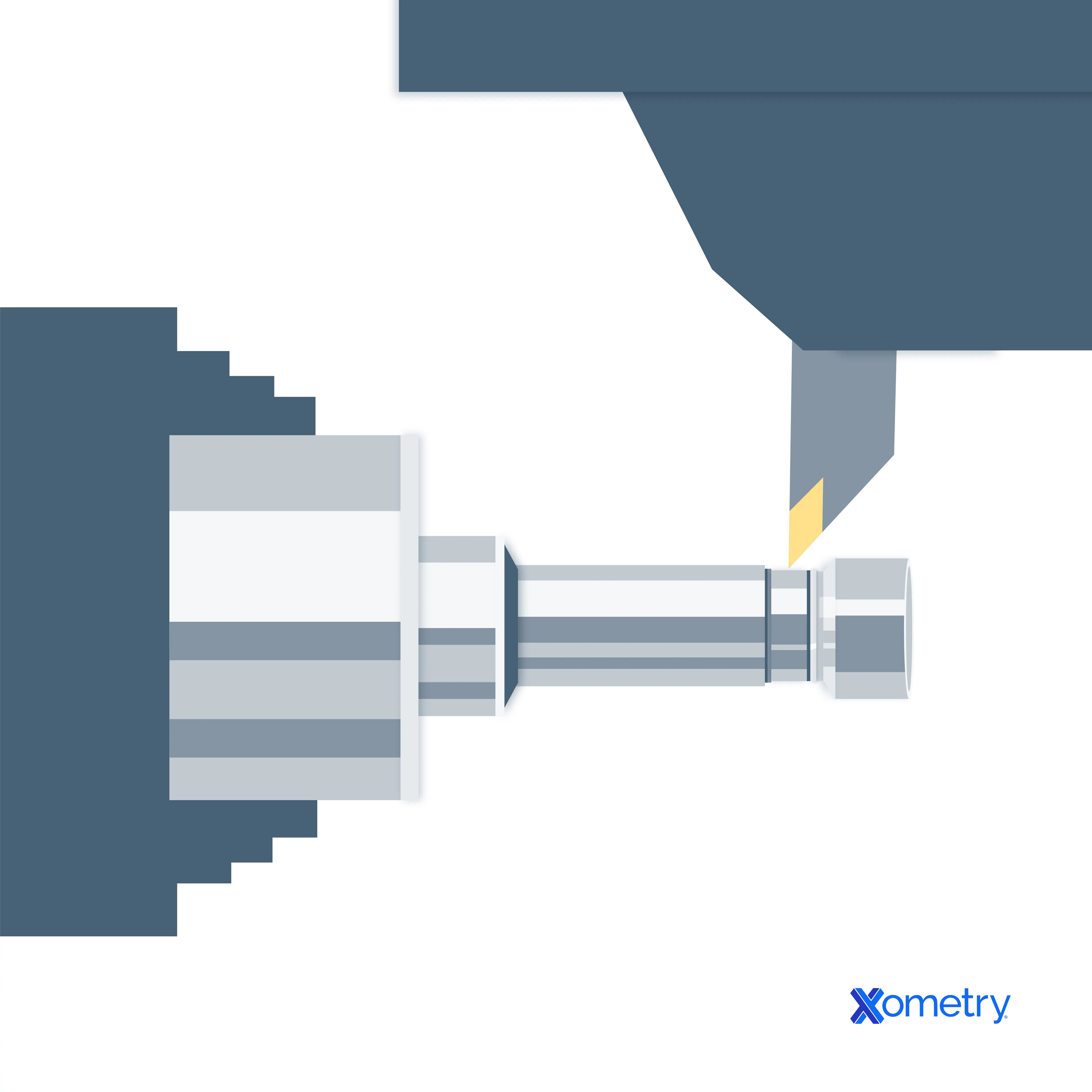

  • Turning Tools: Turning tools are single-point cutting instruments mounted on a lathe to remove material from a rotating workpiece. The cutting edge contacts the workpiece at a controlled depth and feed rate, generating cylindrical, conical, or contoured profiles. Common geometries include roughing tools, finishing tools, and threading tools, with carbide-tipped inserts being the standard for most metals in turning and machining.
CNC turning image
CNC turning

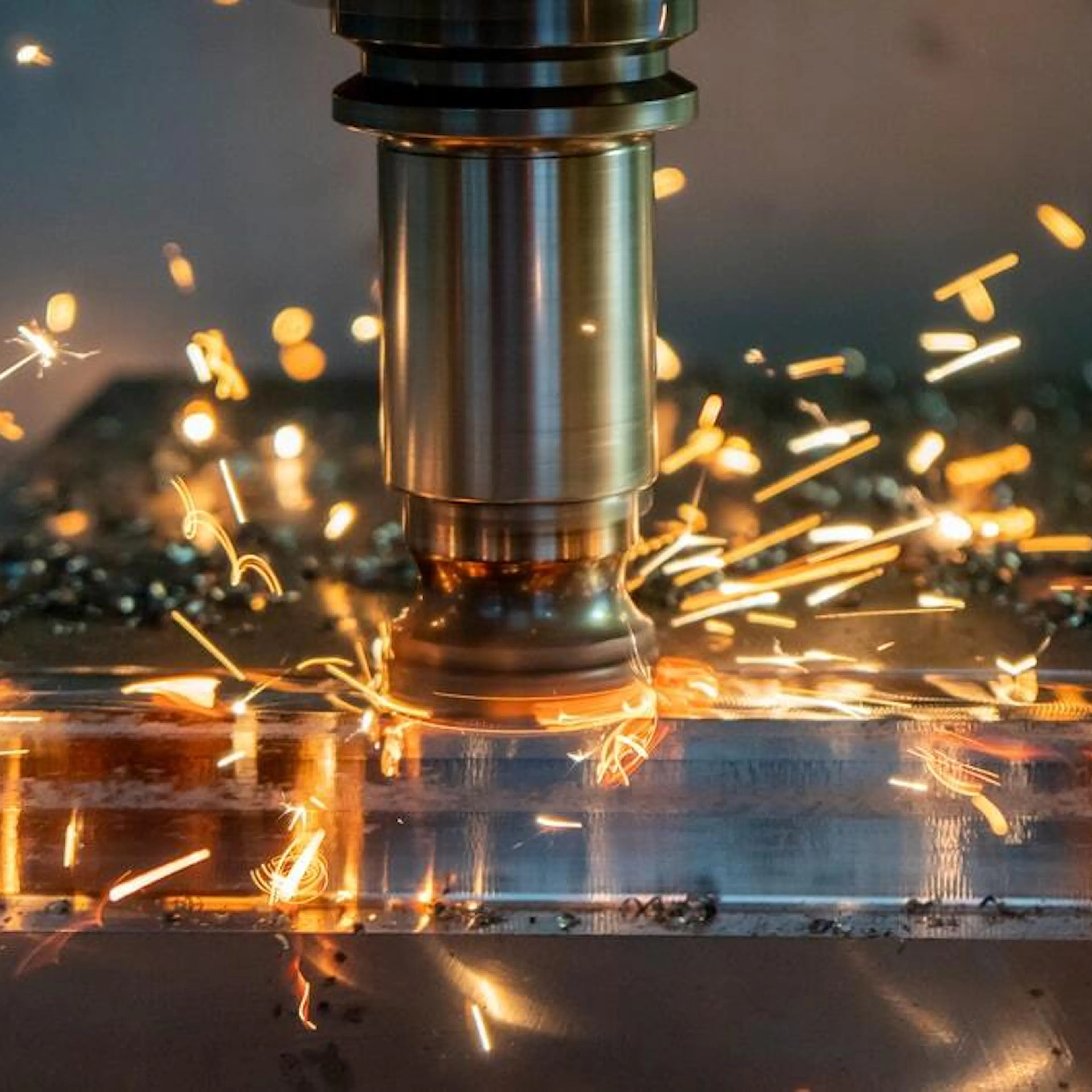

  • End Milling: End milling tools are multi-flute rotary cutters used on milling machines to remove material along horizontal, vertical, or angular paths. Flute counts range from 2 to 8, with fewer flutes suited for softer materials and higher flute counts used for harder alloys. Square end mills, ball end mills, and corner radius end mills address different profiles and finish requirements in End Milling.

1. Turning Tools
Machinists use turning tools on a lathe to remove material from a rotating workpiece. The cutting tool stays rigid while the part spins at a controlled speed. Single-point tools shape outer diameters, inner bores, grooves, and threads. Carbide, ceramic, and coated inserts resist heat and wear during high-speed cutting. Tool geometry, such as rake angle and nose radius, controls chip flow and surface finish. Coolant reduces heat and improves tool life during heavy cuts. Shops rely on turning tools for shafts, bushings, threaded rods, and precision cylindrical parts in automotive and aerospace work.

3. End Milling
End milling removes material with a rotating cutter that has multiple cutting edges. The tool moves across the workpiece in several directions to shape slots, pockets, and complex surfaces. Flat end mills create sharp edges and flat bottoms, while ball end mills generate curved profiles. Roughing end mills remove large volumes of material with reduced cutting force. CNC machines control tool paths with high precision for intricate designs. Tool coatings extend life and reduce friction. Industries use end milling for molds, dies, brackets, and precision machine parts.
