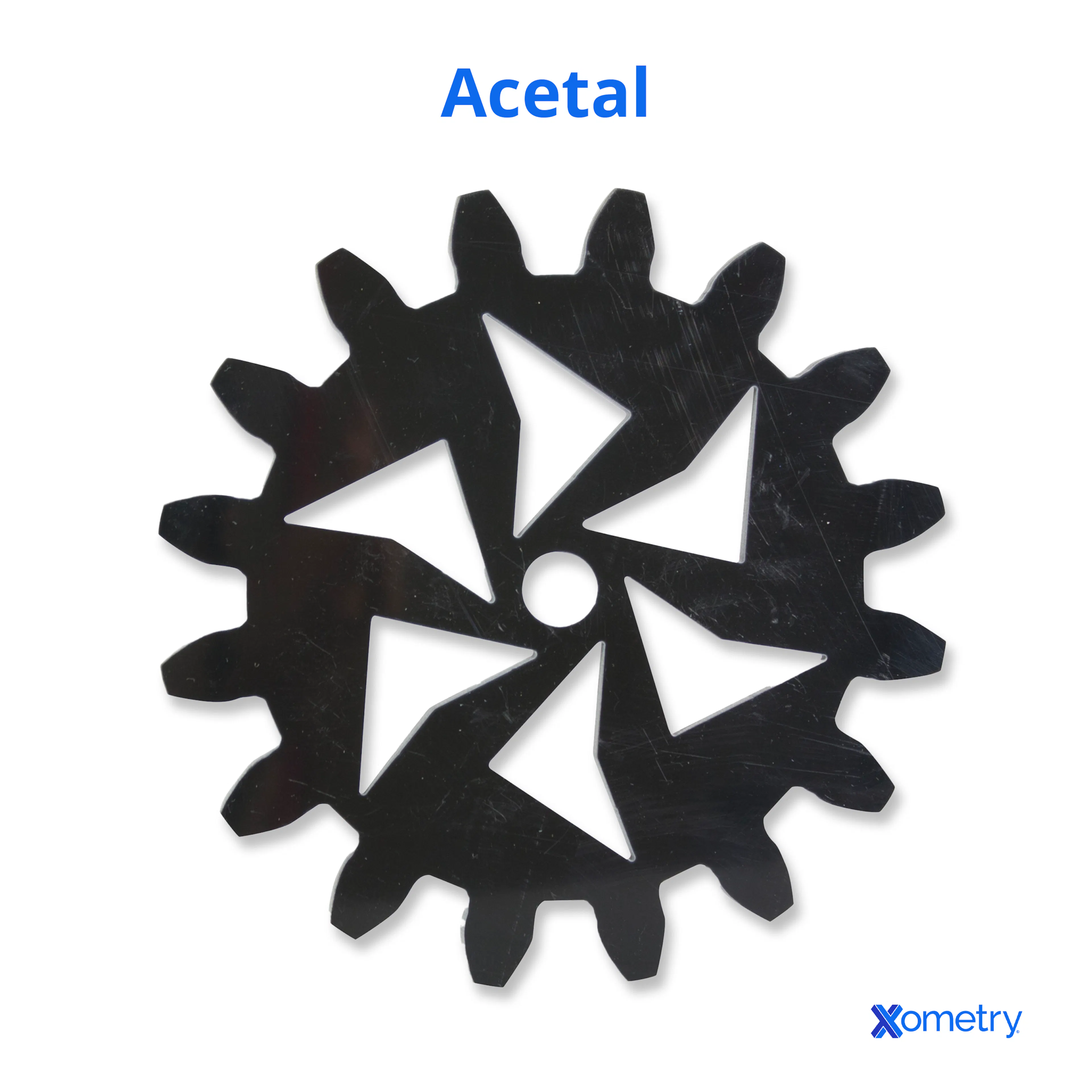

What is Acetal Used for?
Acetal is used for industrial and mechanical applications due to its combination of strength, wear resistance, and low friction. The acetal uses to support the production of gears and bearings that require consistent motion and minimal surface degradation. Automotive components (fuel system parts and sensor housings) rely on it for the dimensional consistency and resistance to chemical exposure. Electrical insulators made from acetal keep structural integrity under thermal and mechanical stress, which supports safe and reliable performance. Precision machinery incorporates acetal in moving parts that demand tight tolerances and long-term durability. The polymer’s ability to resist moisture and maintain surface smoothness contributes to its widespread use in manufacturing environments where mechanical reliability is essential.
Acetal
Acetal
