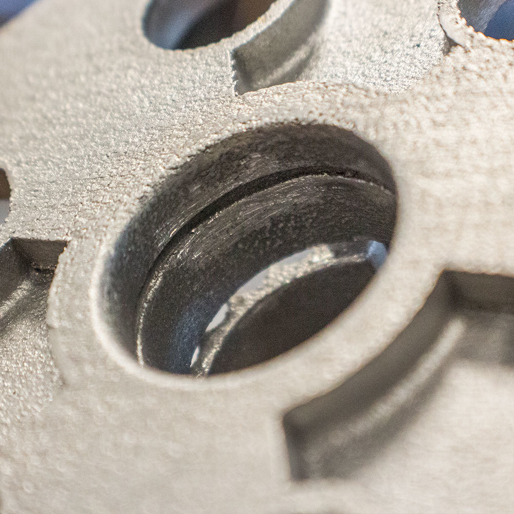

  • O-Ring Grooves
O-Ring Grooves
O-Ring Grooves
Each O-Ring Groove will have an area which tends to have rougher finish than the rest of the groove. Typically the down facing surface of the groove will be rougher than the other surfaces. O-Ring Grooves are possible to build, but likely require secondary machining to achieve a consistent surface finish for proper seal. The unique angle of grooves means that they will require support structures for build, or the entire part will need to be oriented in a way to minimize or eliminate the need for supports in the groove.
