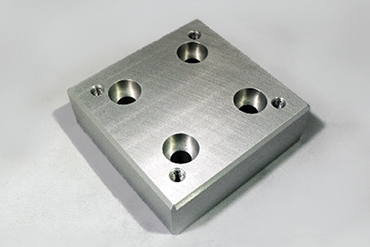

CNC Machining
Slide 1 of 1
CNC Machining
CNC Machining
CNC Machining
Key benefits: CNC machining offers high precision parts with a high-quality finish.
Materials: Aluminum, Brass, Titanium, Carbon Steel, Copper, Stainless Steel, plus others available
Best suited for projects that need:
  • Production-quality materials
  • Tight tolerances
  • Production at scale (up to 10,000 parts)
  • Custom finishes, including anodizing, passivating, plating, and powder coating
Tolerances: ±0.005″ – 0.001″, depending on customer specs
Lead Time:
  • Milled: within 9 business days
  • Turned: within 5 business days

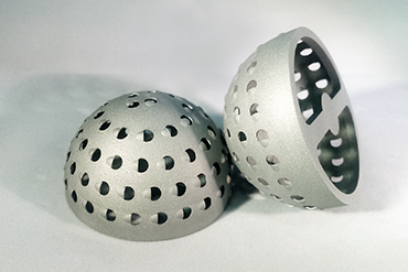

DMLS (Direct Metal Laser Sintering)
Slide 1 of 1
DMLS
DMLS
DMLS
Key benefits: DMLS is capable of building complex geometries that otherwise wouldn’t be possible using traditional manufacturing. Additionally, metal sintered parts possess nearly the same strength and density as cast metal parts, but can be built in a fraction of the time.
Materials: Aluminum, 17-4 Stainless Steel, 316 Stainless Steel
  • Metal parts with complex geometries
  • Aftermarket/replacement parts for legacy systems
  • Low-volume parts and prototypes for functional testing
Max build volume:
  • Stainless Steel – 9″ x 6″ x 6″
  • Aluminum – 6″ x 6″ x 6″
Tolerances: ±0.005″ (can be improved through post-processing)
Lead Time:
  • Stainless Steel: within 5 business days
  • Aluminum: within 8 business days

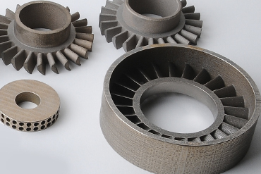

Metal Binder Jetting
Slide 1 of 1
Key benefits: Metal Binder Jetting is our least expensive 3D printing option for building custom metal parts. It also possesses high strength and abrasion-resistance properties.
Materials: Stainless Steel infiltrated with Bronze (60% 420 Stainless Steel, and 40% Bronze)
  • Low-cost, complex metal parts
  • Parts that are too large for the DMLS build platform
  • High abrasion resistance (e.g., thermal, chemical or mechanical stress)
Max build volume: 29″x 15″ x 14.25″
Tolerances: Parts can shrink during the binding process (approximately 1-2%)
Lead Time: within 13 business days

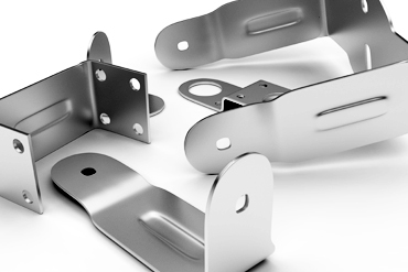

Sheet Metal
Slide 1 of 1
Sheet Metal
Sheet Metal
Sheet Metal
Key benefits: Sheet metal is capable of producing thin walled parts that are either not possible or not cost-effective to build via CNC milling.
Materials: Aluminum, Copper, Stainless Steel, Steel, Zinc
  • Thin metal walls
  • Low-cost device panels, brackets, boxes, cases, and chassis
  • Lightweight applications
Lead Time: within 12 business days
