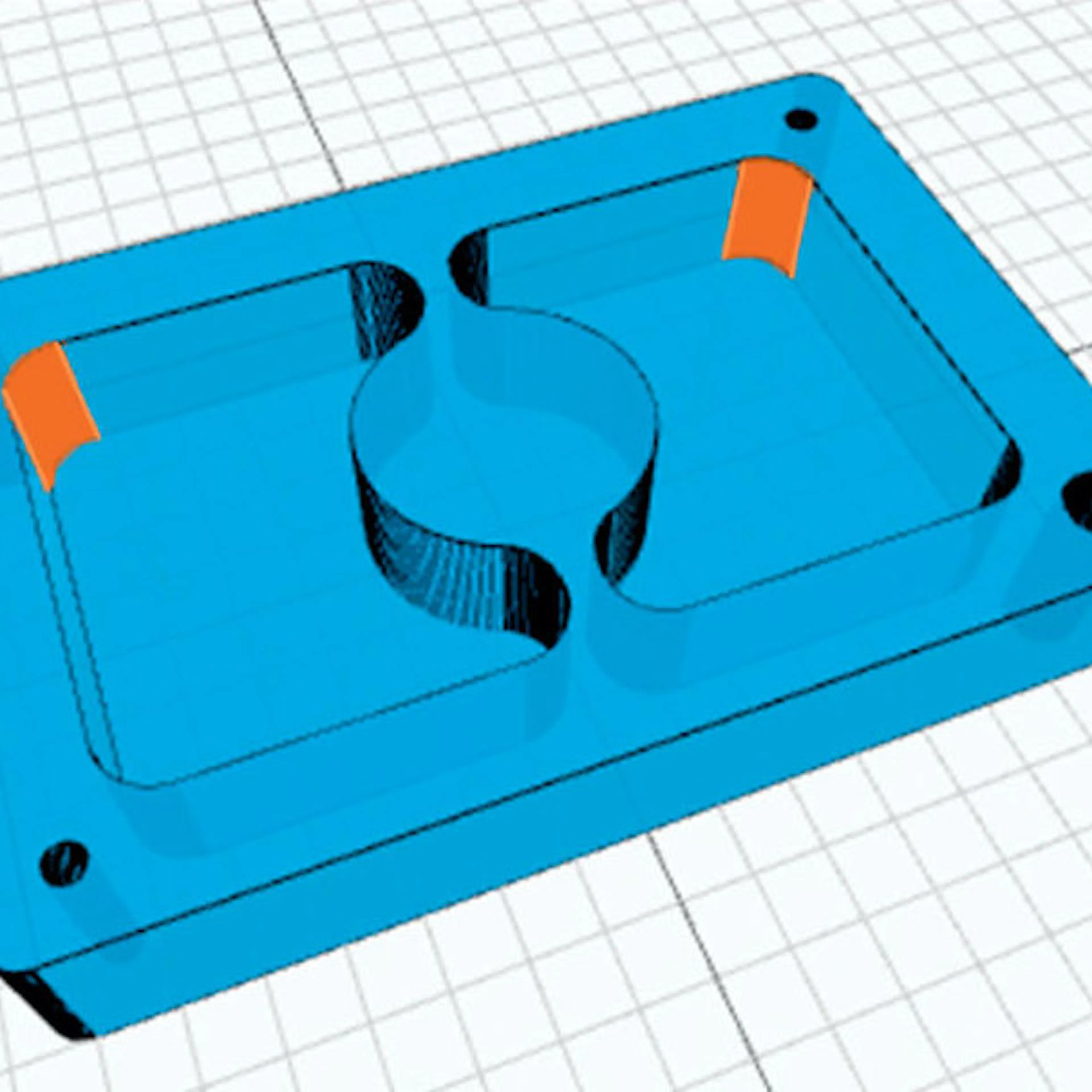

part rendering with internal corner radii

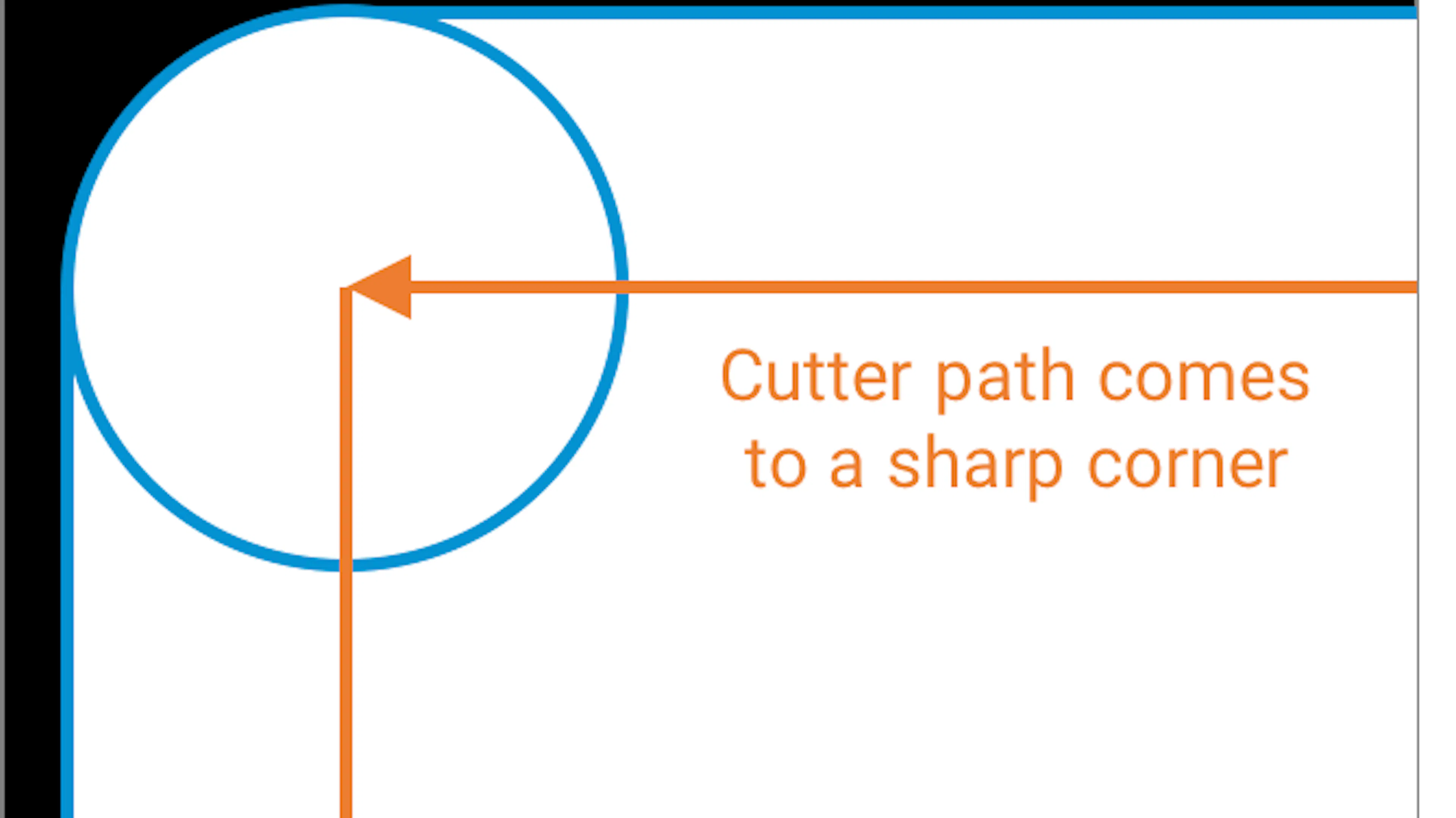

But for inside corner radii, it may actually be better to use a non-standard radius. This is because an endmill needs clearance to turn and continue milling while tracing the internal corner radii.
For example, if a part features a radius of 0.25″, and a standard endmill is also 0.25″, then tool would need to hammer the corner, come to a complete stop, pivot 90 degrees, and then resume cutting. This method not only slows down machining speed (adding costs), but also causes vibration, which creates chatter marks.

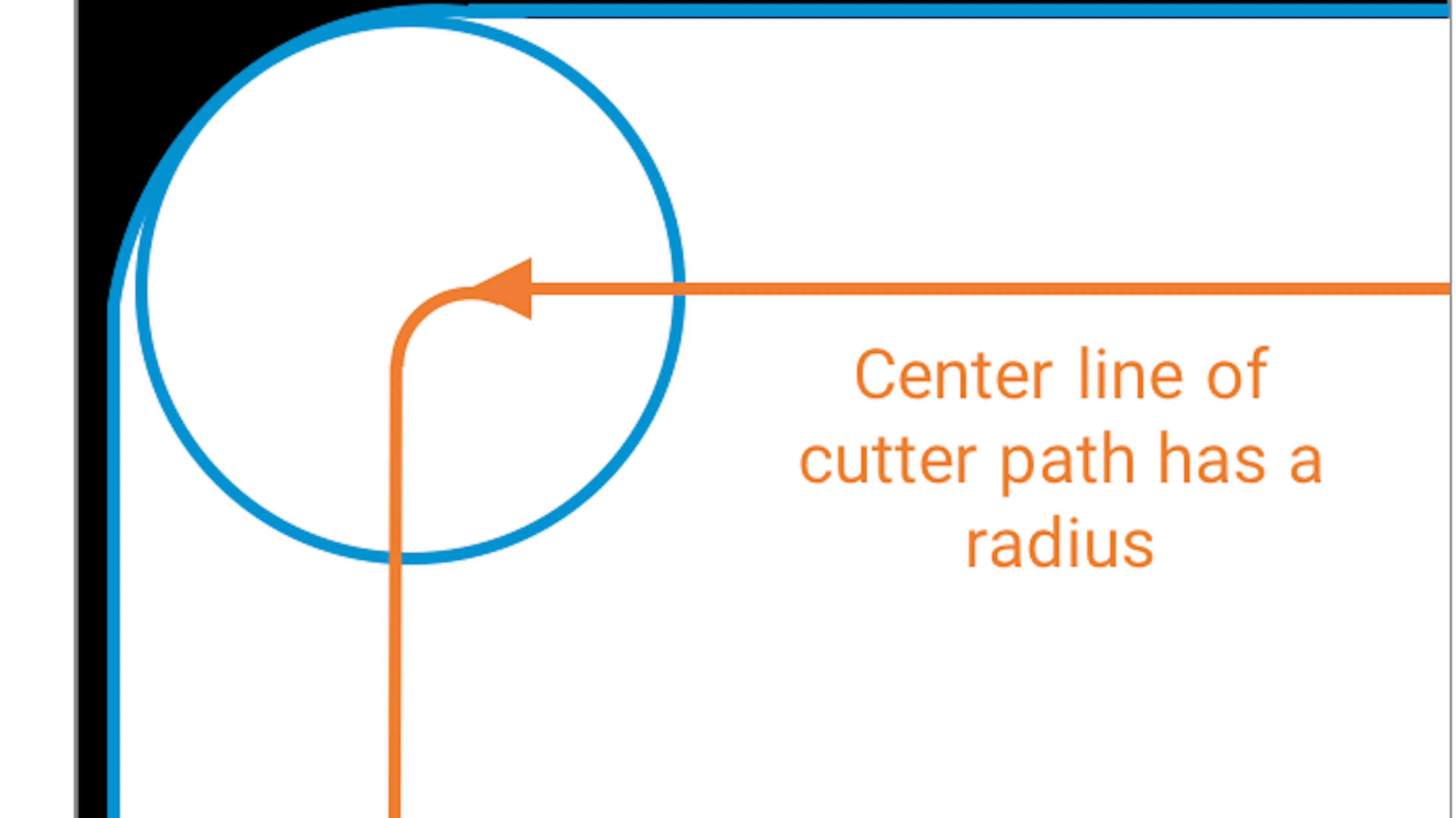

As a best practice, we recommend modeling your design with at least 0.02″ – 0.05″ added to internal corner radii, or in this example, a dimension of 0.27″ – 0.30″. This allows the cutter to turn slightly, without coming to a complete stop—like the above diagram on the right.
The result will be not only cost-savings on your project, but also improved CNC parts.
