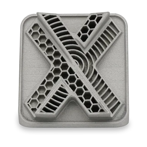

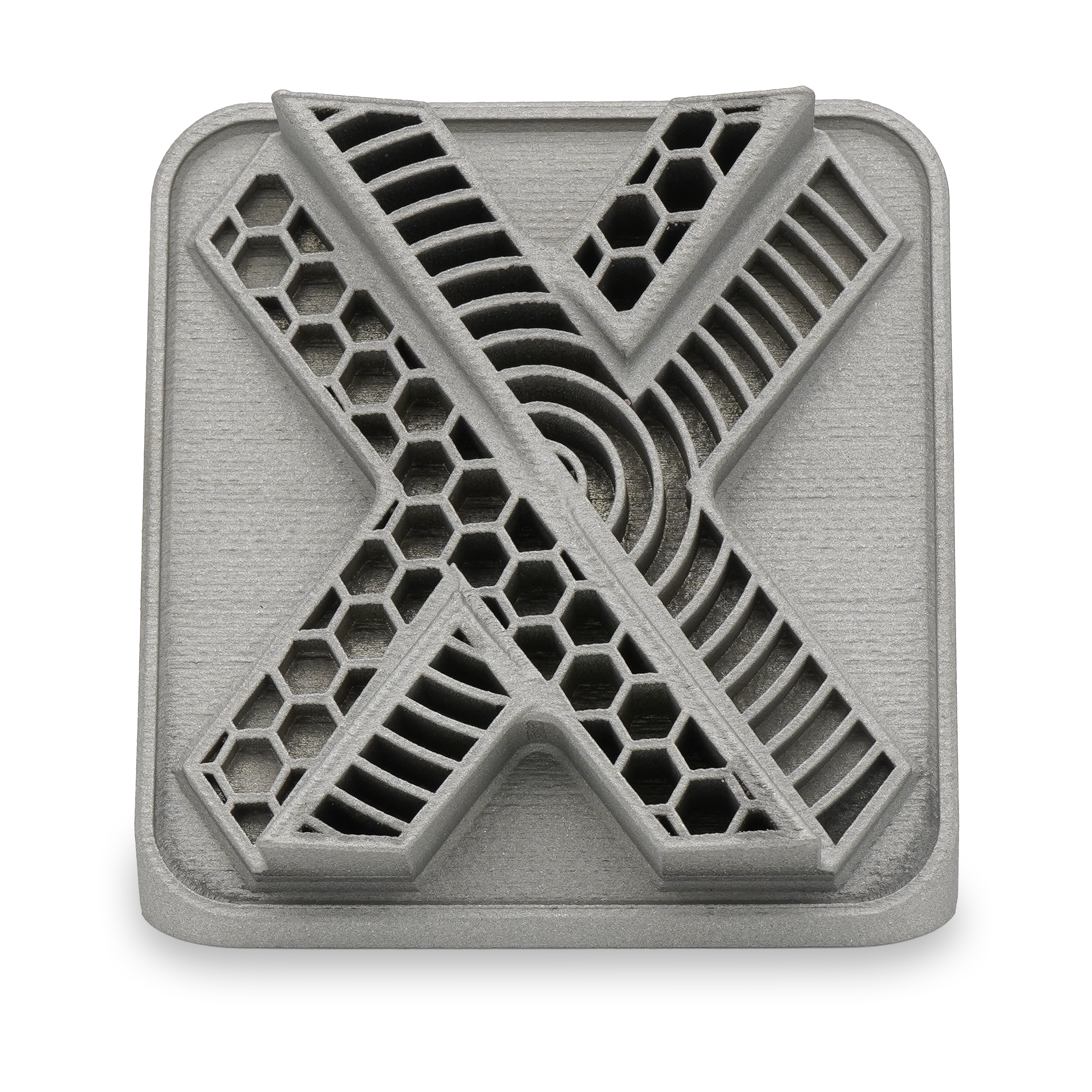

    DMLS 3D printed Xometry X-tile in Inconel 625.

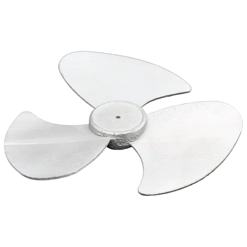

      Propeller printed via DMLS out of 316L stainless steel.
