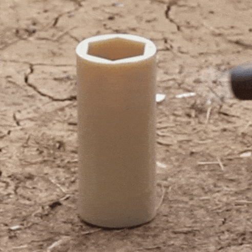

ULTEM flame retardant plastic self extinguishes after burning
