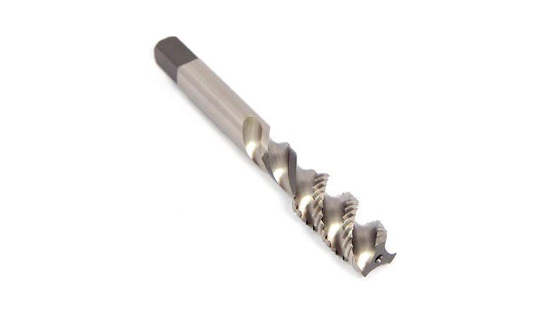

First Issue: Tap Breakage
By far, the most obvious sign of an issue is tap breakage. If your tool is breaking, cracking, or chipping, you need to administer some TLC quickly. First, just double check that you’re using a machine with the correct power output, and tool. If your tool geometry is off, or the tap isn’t the correct hardness for the use case, you’re fighting a losing battle. Also, make sure the tap is sharp. If you’re working with a dull tap, you maybe have one or two sharpens before you should get yourself a replacement. Also, try not to let your tap get too dull before resharpening. Since dull tools can also cause work hardening (also a cause of breakage), you have extra incentive to stay on the up and up with your tool maintenance. Similarly, you can reduce issues by making sure you’ve got the right grind on your tap. A proper cutting angle and chamfer angle ensure good work.
Also often overlooked in tapping is the quality of the hole itself. If your drilled hole is too shallow or too small, you’re either going to ruin the tool or the workpiece with shoddy work. Keep in mind that drill size does not always equal hole size. Checking that the entire process is solid — not just the tool — is essential. If your drilled hole is too shallow for the tap you’re using, that’s going to cause issues as well. Either adjust your drilled hole or the length of your chamfer.
Similarly, if your drilled hole and your tap are misaligned — even by a frog hair — your tap is at risk of damage. Honestly, this is the number one reason for tap breakage. Misalignment by even a fraction will be magnified the further the process is pushed, and doubly cause screw-ups (see what I did there?) when your tap reverses from the hole. Misalignment-related breakage is also caused by using incorrect holding devices. Check that the holding device you are using is correct for alignment with the hole.
Lastly, you might not be applying the right kind of lubrication — and I don’t mean bribe money or bourbon (though we wouldn’t personally refuse either)*. If you’re experiencing breakage, chipping, or fracturing, you may need to reduce the friction on your tap by increasing the amount of lubrication during machining. You may need to switch the type of lubrication you’re using — a purpose-made tapping lubricant is your best bet. Better lubrication also improves chip removal. This is definitely one area where more is more.
