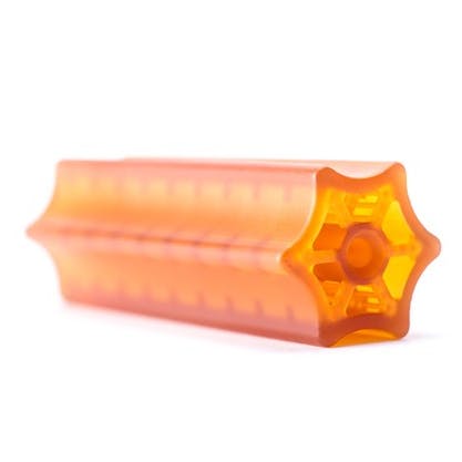

ULTEM parts are available in a natural translucent to opaque amber color, depending on grade. Black is also available.
As Machined: ULTEM is easily machined and can achieve smooth surface finishes comparable to 125 uin Ra finish or better.
Bead Blast: Any undesirable tool marks may be removed by mechanically abrading the surface with glass beads.
    Amber colored part
