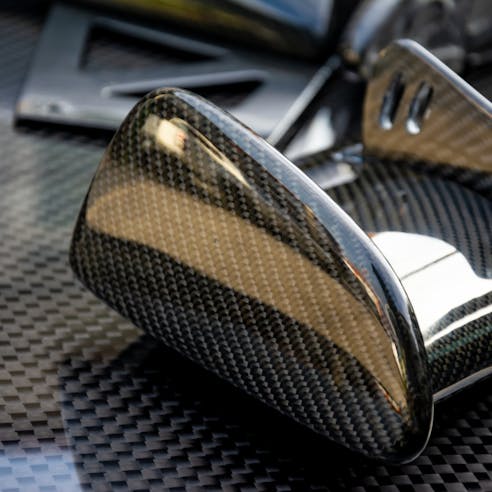

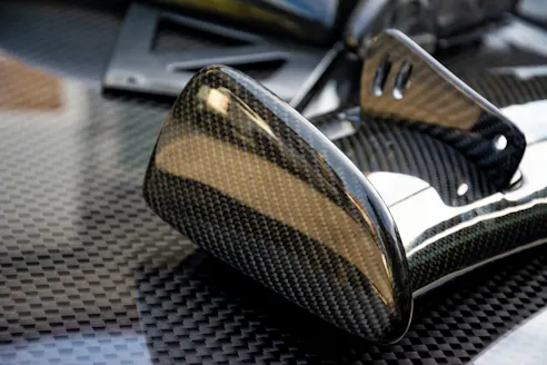

Carbon fiber laser cutting is often used to post-process carbon fiber components as well as to pre-cut carbon fiber fabric before epoxy infusion. Laser cutting is able to precisely and quickly cut carbon fiber parts without applying any mechanical force which may cause the material to crack or break. Carbon fiber laser-cut parts can include drone chassis, corrosion-resistant industrial brackets, or even satellite structural components. Xometry offers the highest quality carbon fiber laser cutting services.
What Is Carbon Fiber?
Carbon fiber is a composite material made by drawing what's known as a precursor, usually polyacrylonitrile (PAN), into a long strand. It is subsequently heated to extreme temperatures in an oxygen-free environment. The lack of oxygen prevents the PAN fiber from combusting and the high temperatures cause all the non-carbon atoms to vaporize, leaving behind a chain of interlocked carbon atoms.
Carbon fiber is often used to refer to a composite of woven carbon fiber fabric and a polymer, usually epoxy resin. Due to its flexibility, carbon fiber fabric can be draped over complex forms and the epoxy can be painted over the carbon fiber sheet to fill the voids between the fibers with epoxy. Alternatively, a technique known as vacuum infusion can be used to ensure that all the air gaps between the fibers are filled with epoxy. This composite has an excellent strength-to-weight ratio. Such materials are also referred to as CFRP (carbon fiber reinforced polymer) composites.
Carbon fiber parts usually have relatively thin walls. This makes them ideal for laser cutting. It can be challenging to laser cut carbon fiber composites as the epoxy will absorb the laser energy and evaporate before the laser has had a chance to cut through all the carbon fiber strands. However, CO2, Fiber, and Nd:YAG lasers are all able to successfully cut through carbon fiber. Specialized multi-wave laser cutters that make use of CO2 and fiber lasers in combination produce the best results.

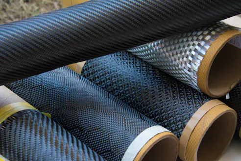

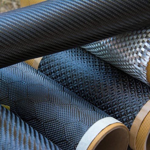

Carbon fiber material. Image Credit: Shutterstock.com/Composite_Carbonman
Lightweight
Carbon fiber is widely used in applications in which low weight is required. Laser cutting these parts can create optimized designs by precisely cutting away any material that is not directly contributing to the overall strength of the part.
Strong
Carbon fibers on their own are extremely strong in tension but are brittle. However, once infused with epoxy, the resulting composite has high levels of strength and a degree of flexibility. Complex designs can be cut from carbon fiber without affecting the strength of the composite.

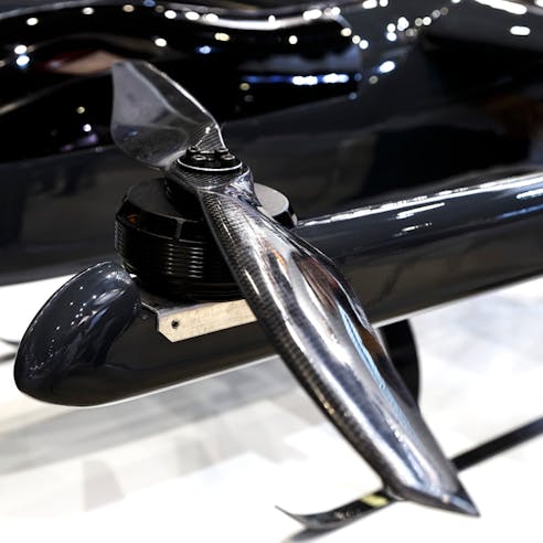

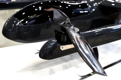

Carbon fiber drone. Image Credit: Shutterstock.com/Timofeev Vladimir
Drones
Drones have very short flight times due to limited battery capacity. As such, any gram of weight that can be shaved off the design results in a drone with increased flight time. Carbon fiber is ideal as it has an excellent strength-to-weight ratio. The main chassis of a drone can be laser cut from carbon fiber.

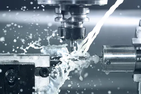

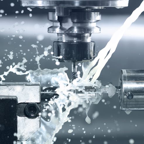

CNC machining. Image Credit: Shutterstock.com/Hywit Dimyadi
  • CNC Machining: CNC machining can be ideal for processing carbon fiber components. For example, if holes need to be cut into a complex shape or if the edges of a part need to be trimmed, then 5-axis CNC machining can be used.
