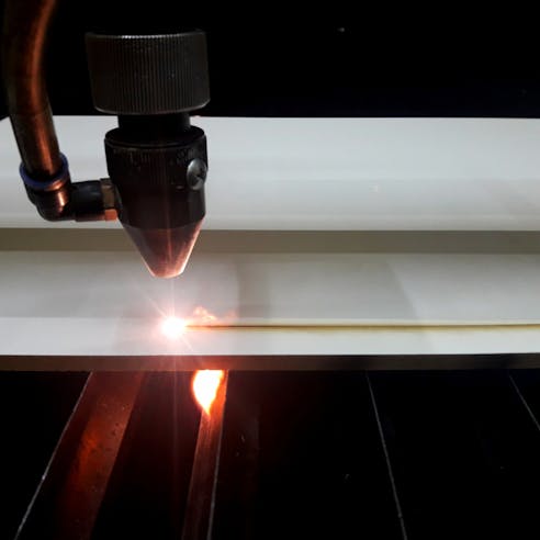

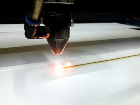

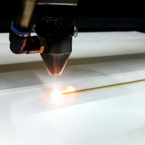

MDF Laser Cutting Processes
MDF board can be either cut or engraved with a laser cutter. Because heat is applied for a very short time and is concentrated in a small area, there is little risk of the board catching fire. However, there is always a possibility this may happen and caution must be exercised. In addition, the heat from the laser will vaporize the resin binder. This process can produce toxic combustion by-products, especially if the board contains a formaldehyde-based binder.
  • Laser Cutting
  • Laser Engraving
MDF laser cutting. Image Credit: Shutterstock.com/Nikolay Vinokurov

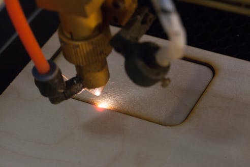

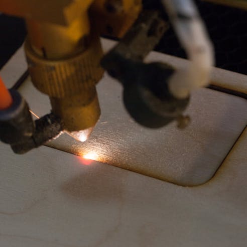

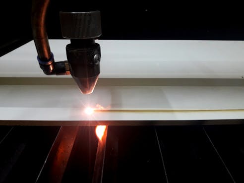

Laser Cutting
MDF boards can be cut into various shapes using a laser cutter without the risk of the board chipping, which is a common problem when processing MDF using typical woodworking tools. The laser will burn the MDF along a localized path and will produce a precise cut edge. Typically, a 40 W CO2 laser can be used to cut MDF boards up to 6 mm thick in a single pass. For thicker boards, up to 18 mm, multi-pass cutting may be required. Air assist can improve the quality of the cut while also preventing the laser optics from getting coated in combustion products which will reduce its effectiveness.

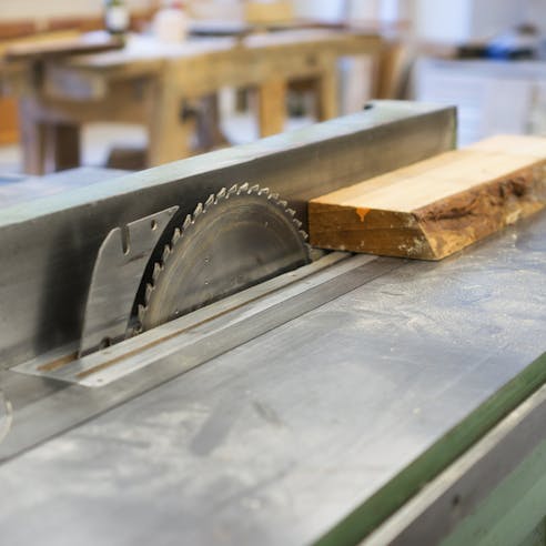

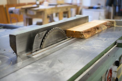

  • Table Saw
  • CNC Machining
Table saw. Image Credit: Shutterstock.com/Federico Rostagno
  • Table Saw: When cutting simple, straight designs, it may be more cost-effective to simply use a table saw to cut the required parts. Table saws are ideal for cutting rectangular components. However, chipping can occur on the cut edge.
