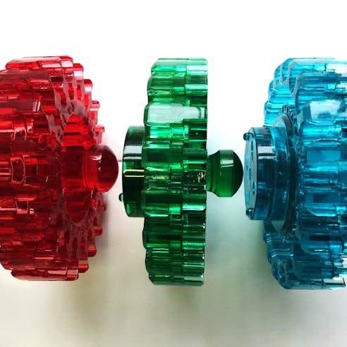

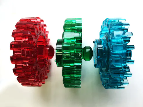

Urethane Casting
Urethane casting provides end-use, rigid plastic, rubber, and silicone parts with production-level quality. Xometry is a leader in urethane casting services, with domestic (US-based) and international economy options to fit your timeline and budget; pricing includes tariffs for prototypes. Urethane gives professional results for low-volume production using a soft-tooling approach, utilizing 3D-printed master patterns and RTV silicone molds.
Cast urethane parts are ideal when color, surface quality, and toughness are required for quantities from one to one hundred. Urethane molding is a perfect alternative for insert molding or overmolding in low volumes with diverse material choices. Polyurethane or silicone casting can bridge production between a 3D printed rapid prototype and an injection molding with a balance of quality, cost, and time. Urethane cast parts can be clear, color-matched, painted (including EMI shielding), installed with inserts, and custom finished.
    Teal transparent cast urethane part made by Xometry.

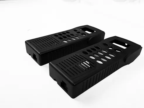

    Urethane cast handheld radio housings on demand through xometry

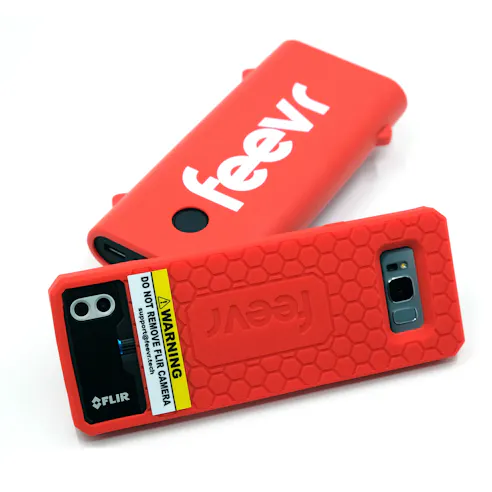

    A silicone camera housing
