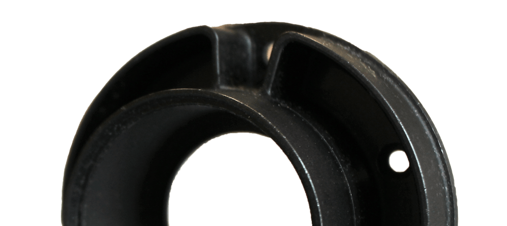

Cylindrical CNC-machined part made of black plastic.
