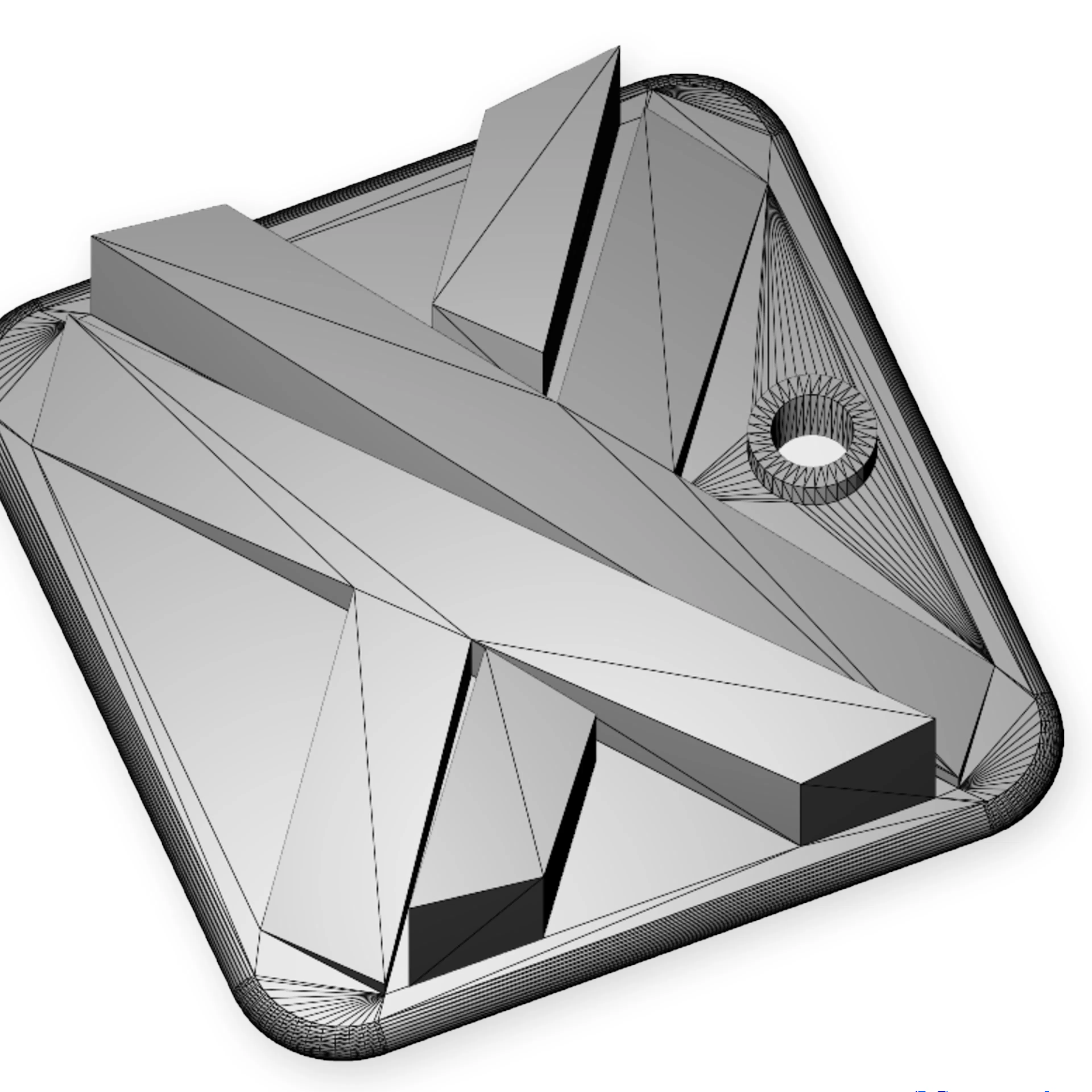

Example of an STL file
Both DXF (drawing exchange/interchange format) and STL (stereolithography or standard triangle/tessellation language) are traditional file formats used in design and 3D printing. DXF files typically represent detailed 2D and 3D designs and can accurately exchange data between CAD programs, while STL files are mainly used for 3D printing and focus on representing a part’s outer surface (which it does as a mesh of triangles). Converting one to the other is actually a very straightforward process, and we provide the exact steps a little further down. First, let’s have a brief look at how these files work and what they’re used for today.
Note: The DXF to STL conversion process applies to DXF files containing 3D information. To create a 3D STL model from a flat drawing or 2D DXF file, you will need to open the DXF as a sketch in an appropriate CAD package, extrude the shape, and modify the features as desired to create a fully defined 3D model that can then be saved as an STL.

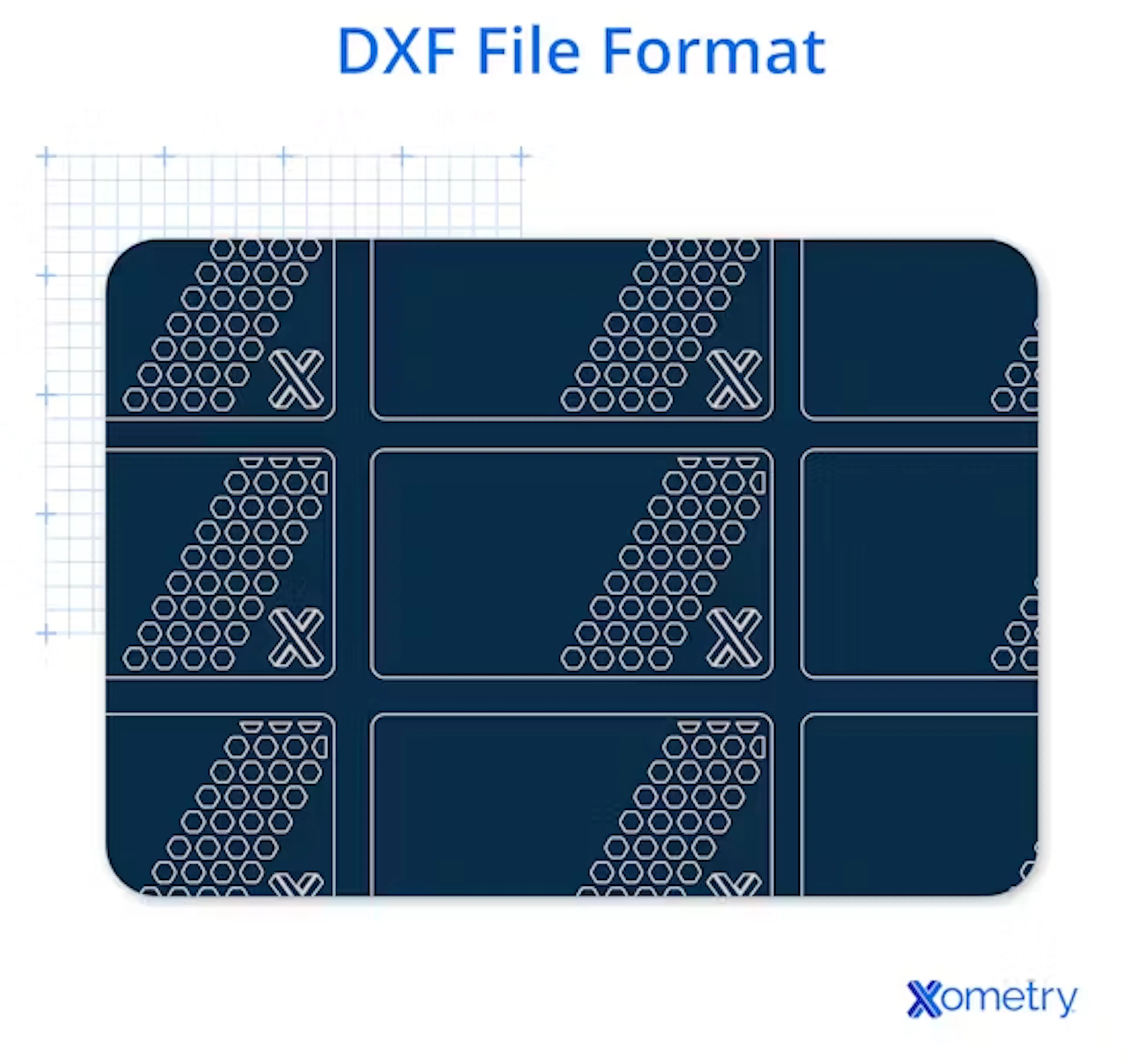

DXF File Format
How is DXF File Used in CAD?
DXF file is used in CAD to store and exchange vector-based design data across different software systems. DXF file format preserves geometric information such as lines, arcs, circles, and text, which allows consistent interpretation between CAD platforms. Designers use DXF files to create and share 2D layouts, technical drawings, and sometimes basic 3D representations without relying on native software formats.
AutoCAD uses DXF files to export drawings for compatibility with other CAD programs and manufacturing systems. CNC workflows depend on DXF files to translate vector paths into machine instructions for cutting, engraving, or machining operations. Laser cutters, plasma cutters, and milling machines read DXF geometry to follow exact toolpaths defined in the design.
CAD interoperability relies on DXF files since different software platforms interpret the same geometric data without loss of structure. Engineers and designers exchange drawings between programs without converting into proprietary formats, which maintains accuracy and workflow efficiency. The standardized structure and wide compatibility define the role of the DXF File.

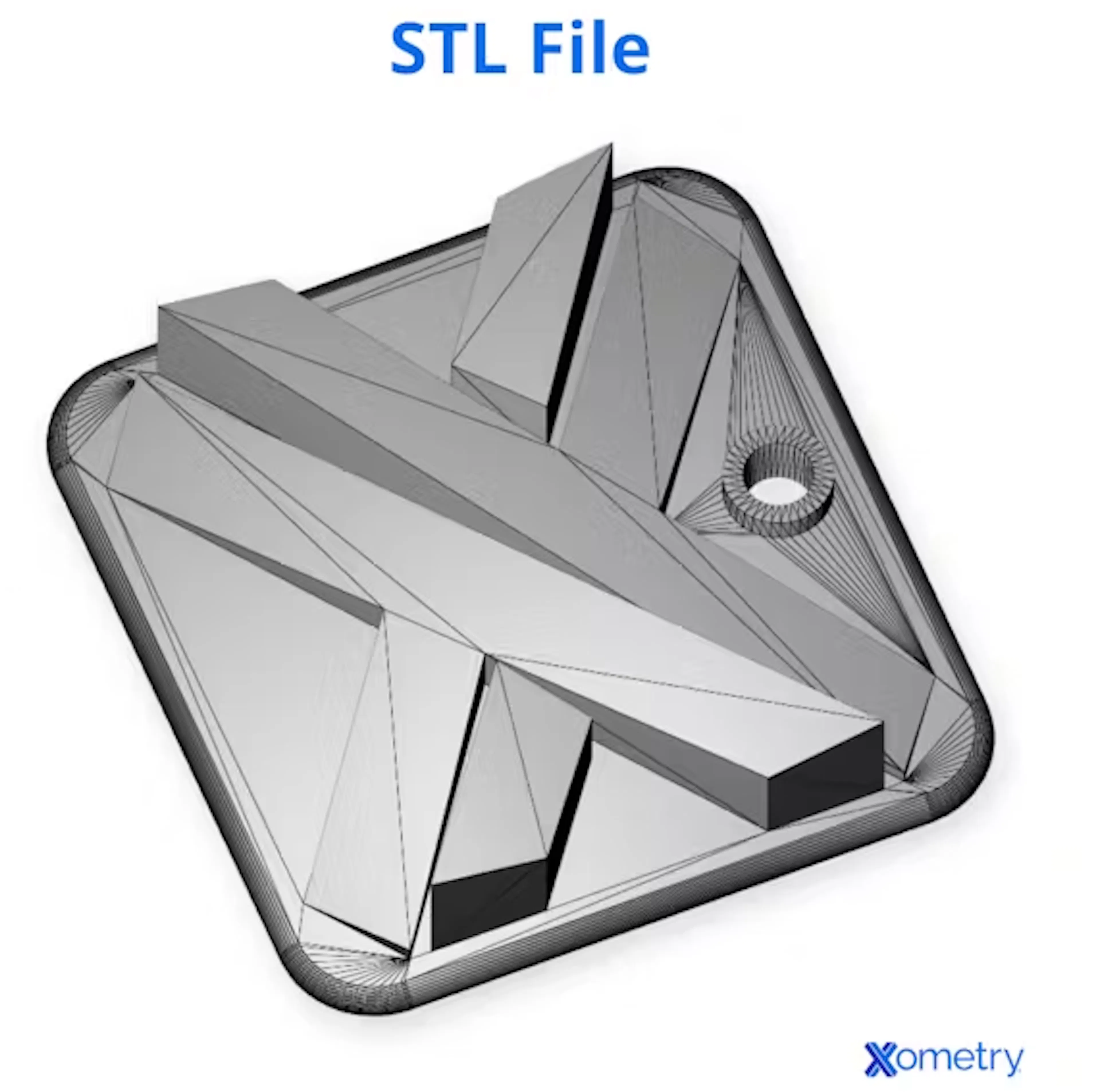

What is an STL File?
STL is considered the standard file type that most 3D printers use today. It’s pretty old and doesn’t contain information on color or texture. It works by storing points on the surface of an object as geometric data. It uses triangles of different sizes to form a sort of net that describes the exterior 3D shape of an object, although it also doesn’t keep information on thickness either. The following image is an STL preview of the Xometry logo on a tile:
