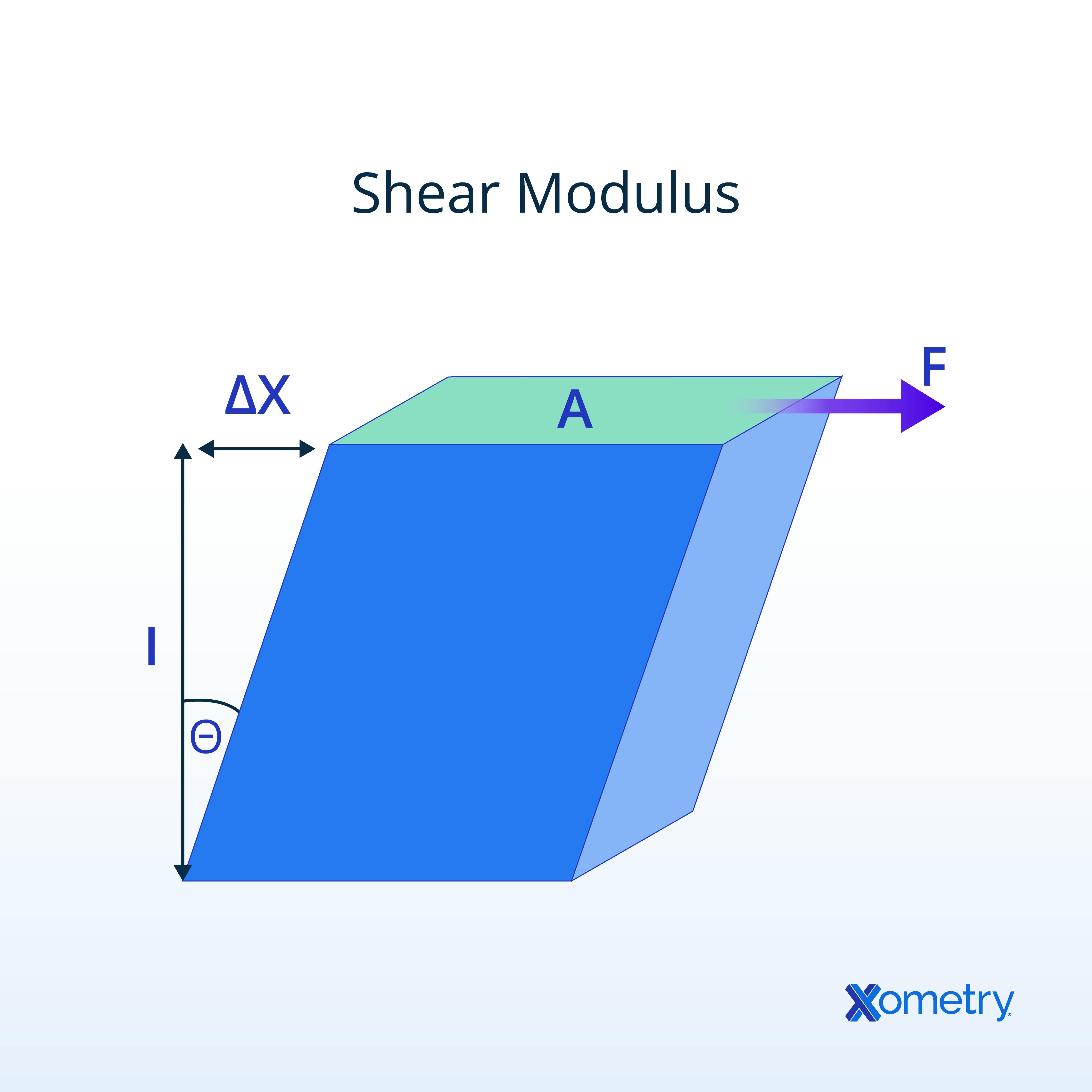

Shear modulus is defined as the ratio between shear stress and shear strain. It is calculated as the shear force per unit area divided by the displacement of the edge of that material. Shear modulus is often referred to as the modulus of rigidity, as it gives an indication of how rigid the material is (in other words, how much it resists deformation from a shear force).
Diagram of shear modulus where Δx is the displacement, l is the initial length, θ is the displacement angle, A is the area and F is the force.
