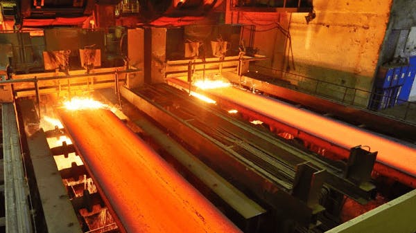

4. Extrusion
Extrusion is the fabrication method used to manufacture materials with a constant cross-section like structural members. Material is forced through a die that has the desired cross-section. This can be done both with cold or hot material.

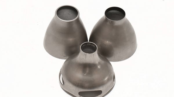

6. Drawing
Drawing is commonly used to create long thin products like wire. Metal stock is ‘drawn’ through a die that reduces its diameter. A similar technique known as deep drawing forces a sheet metal blank over a die to create a shape whose draw depth is longer than its diameter. Drawing differs from punching in that the process is designed to make parts that are longer than their widths, i.e. long “drawn out” parts.

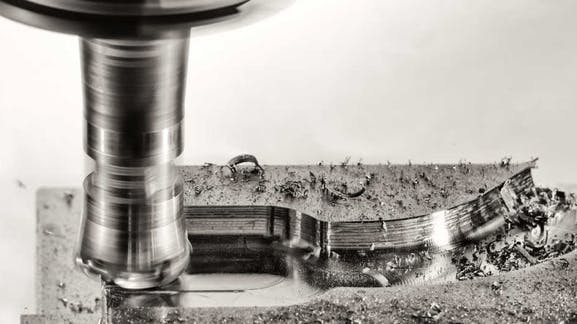

10. Machining
Machining is a subtractive manufacturing technique that is widely used to fabricate complex shaped parts. In general, machining can be broadly broken down into two categories:
- Milling: Milling is when a part is held stationary in a machine and a spinning tool removes material. This process is suited to parts with non-symmetrical flat faces. Complex 5-axis machines can create complex components with organic faces and complex curves.
- Turning: Turning is when the material is secured in a chuck and spun while the cutting tool is held stationary. The tool is moved into contact with the spinning part to remove material. This technique is suited to cylindrical parts but some machines like Swiss lathes can also cut non-cylindrical features into the part.

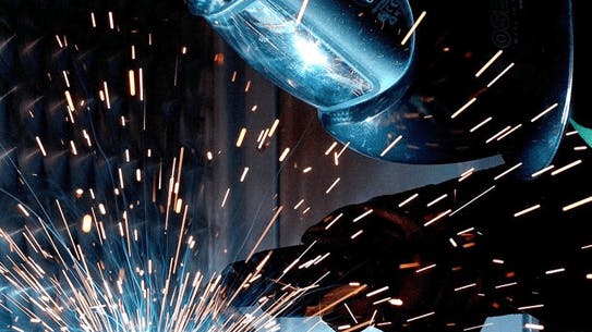

13. Welding
Welding is the most common fabrication method used to permanently join metal parts. In general, the process works by melting a consumable in the form of a rod or spool of metal wire into a prepared joint, ultimately creating a uniform connection. There are many welding technologies. Some of the most common are listed below.
- MIG & MAG (Metal Inert Gas / Metal Active Gas): A wire is fed via a nozzle to the joint where an electrical arc melts the wire and some of the base part’s surface. Either an inert (MIG) or an active (MAG) gas is supplied to shield the weld from oxidation.
- TIG (Tungsten Inert Gas): The wire is held by the operator and a torch supplies the arc. A wire is fed into the arc where it melts into the joint. An inert gas is supplied to shield the weld.
- SAW: Submerged-arc welding (SAW) is an automatic process used to create long continuous welds. A powder flux is applied above the arc to shield the weld.
- SMAW: Also referred to as arc welding, this is where the operator connects a welding rod to an electrode and when the rod makes contact with the metal an arc is formed which melts the rod at its contact point. A flux surrounds the welding rod and covers the weld to prevent oxidation; this is removed afterward.
