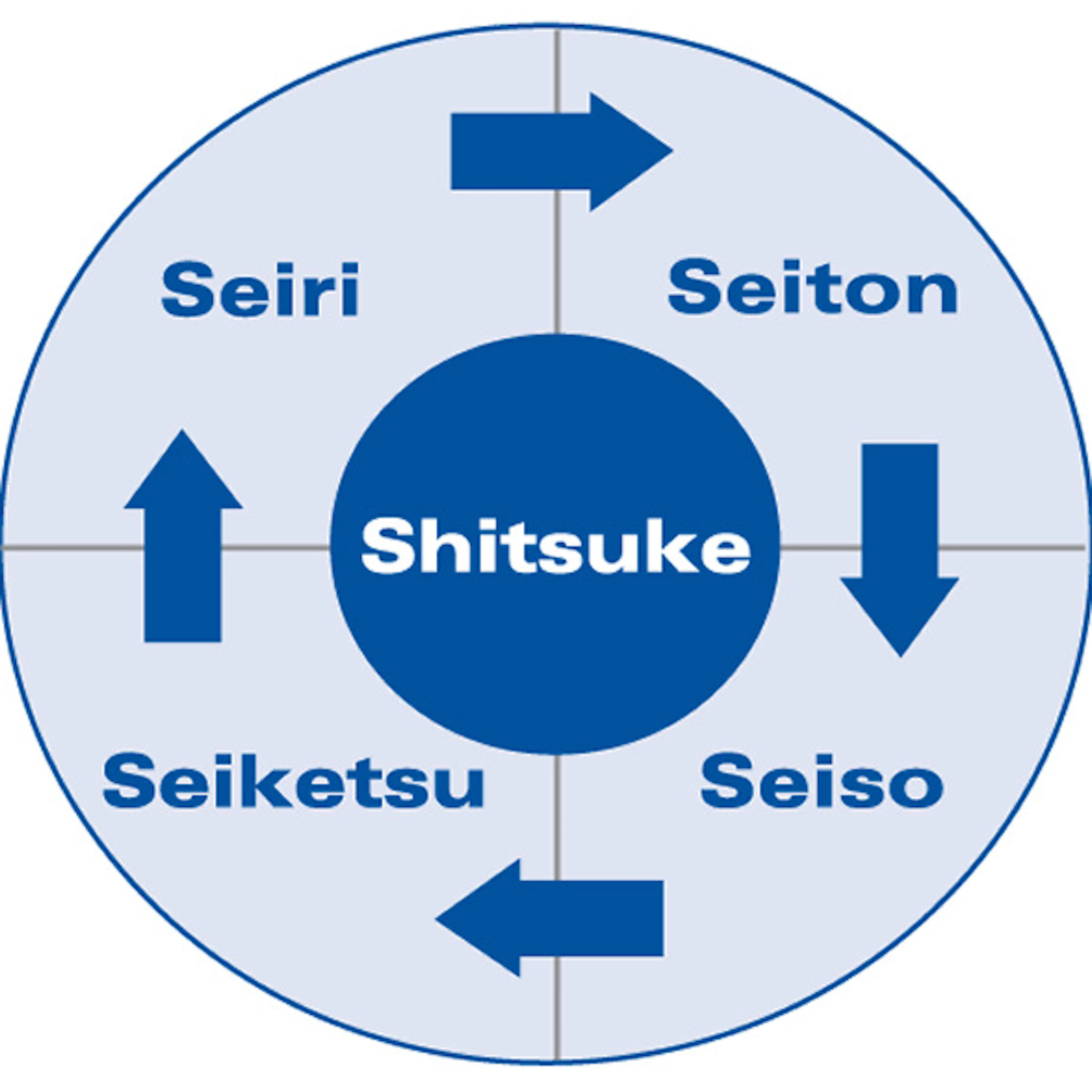

5S History and Definition
The 5S in lean manufacturing originated as 4S in the 1980s, from TPS (Toyota Production System), which became 4S, with 4 of the 5 same S’s and had the (English) acronym R.I C.K in some areas: Remove, Identify, Clean, and Keep clean. It didn’t take very well and quickly got the 5th S (Seiketsu (清潔)), an updated translation, and rolled out widely.
5S is a five-level routine that creates a more productive and orderly work environment. In broader interpretations, 5S principles have become foundational for implementing lean production tools and processes in almost any activity. 5S originated as a codification of order, a place for everything, and everything in its place. Now things and places can be virtual and can be processes and systems that are distant from a factory. The meaning of each S is:
  1. Seiri (整理)/Sort: Eliminate that which is not needed. Remove from the workspace and put into storage the things that are not in use.
  2. Seiton (整頓)/Straighten: Organize what remains after sorting. This describes assigned locations and labels for everything in the workspace (and virtual spaces).
  3. Seiso (清掃)/Shine: Clean and inspect the work area. This principle requires staff to tidy and evaluate their workspace for issues to be addressed—stock required, broken or missing requisites, and opportunities for improvement.
  4. Seiketsu (清潔)/Standardize: Write and follow standards for 5S. It is agreed upon as the reinforcement and allocation of responsibility for housekeeping activities and regular reviews/audits.
  5. Shitsuke (躾)/Sustain: Consistently apply the 5S standards.
