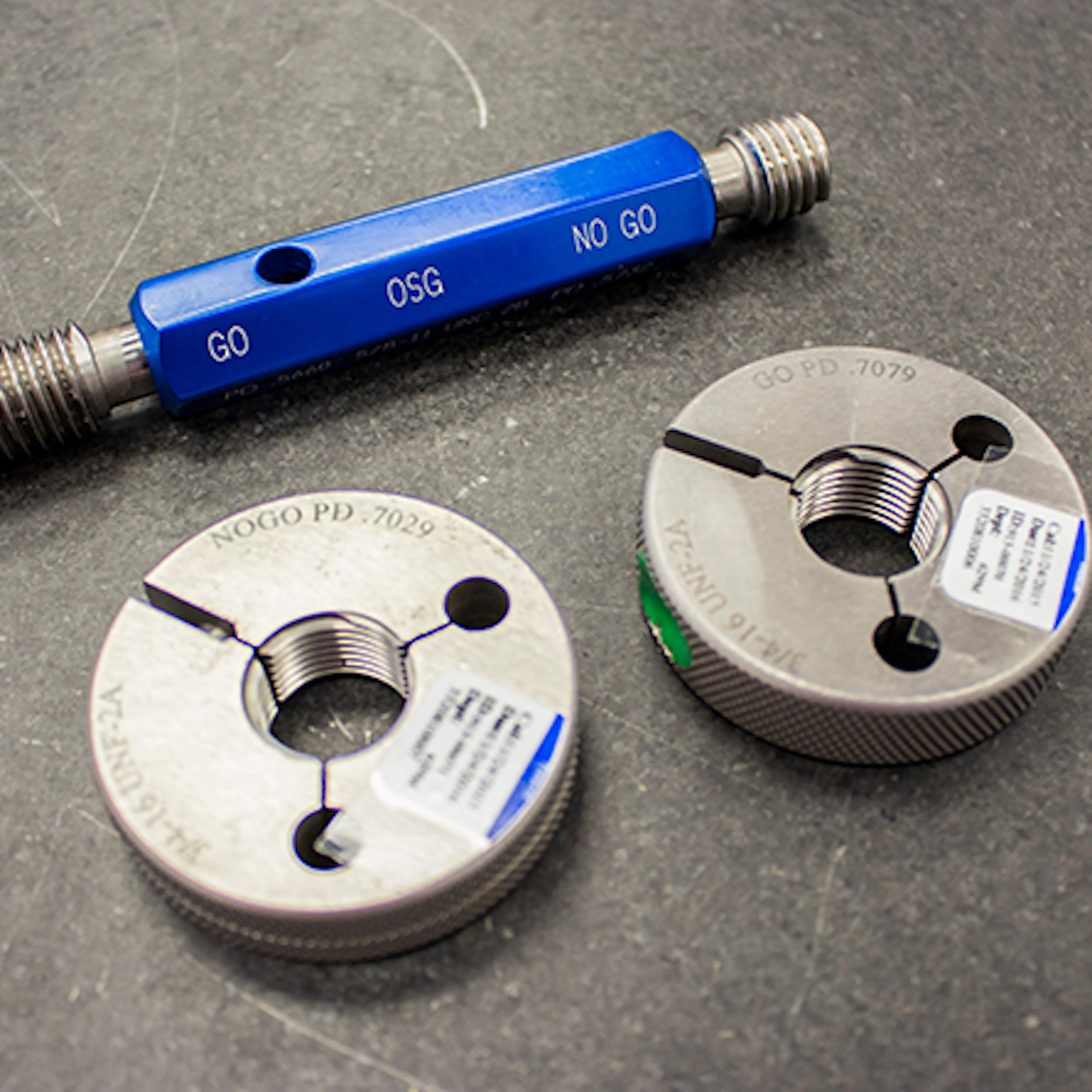

Accurately measuring the depth of an internal thread can be challenging and time-consuming. The proper depth of thread on an internally threaded part is critical to ensure that the mating part will seat properly against the face of the tapped hole once they are assembled.
To check thread depth, you typically need a thread depth gauge. Whether digital or analog, these devices provide objective measuring scales to indicate the depth of thread. They also provide repeatable results if handled with care, used as designed and regularly calibrated.

The handedness of thread refers to the direction the male part must turn to engage the threads. Find the lead in of the thread and determine if it is counter-clockwise (for left-handed) or clockwise (for right-handed). Using the opposite-handed measuring tool will make it impossible to take measurements.
Step 6 - Check Measuring Tool Calibration Status
Once the thread size and handedness are known, select the appropriate measuring tool. It is critical to check the calibration status of the measuring tool before use. An uncalibrated tool can produce inaccurate measurements, jeopardizing product quality.
Do not use an uncalibrated measuring tool. If a calibrated tool is not available, follow your organization's escalation plan and notify the relevant parties.
Step 7 - Measure Thread Depth
Follow organizational procedures or measuring-tool manufacturer guidelines and measure the thread depth. Depending on the part’s features and physical size, you may first need to secure it to a solid, stable work surface.
