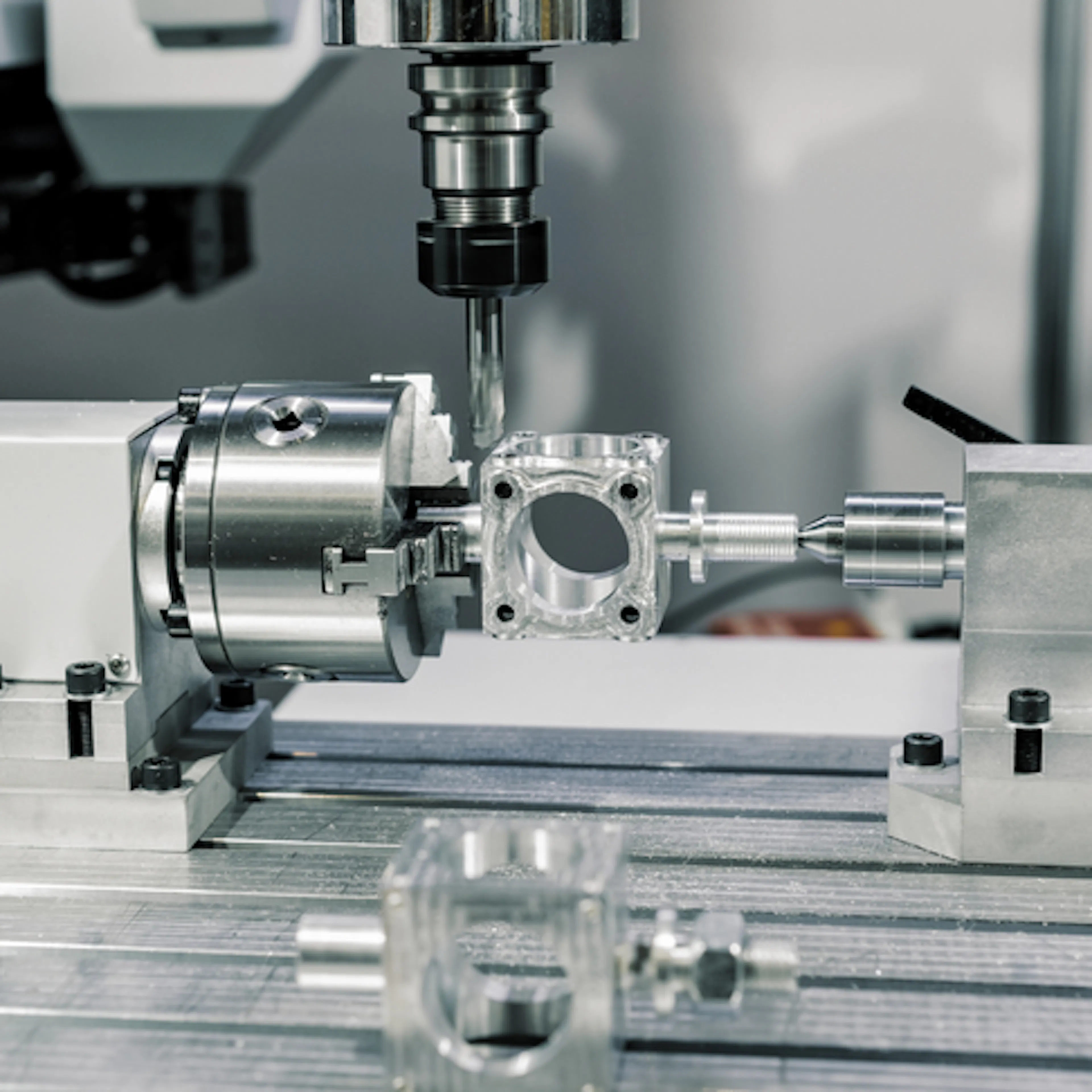

CNC machine. Image Credit: Shutterstock.com/Nordroden
Tool balancing is a critically important capability that is often performed less than perfectly. The need arises when the center of rotation of a machine component and its center of gravity is not sufficiently well aligned.
