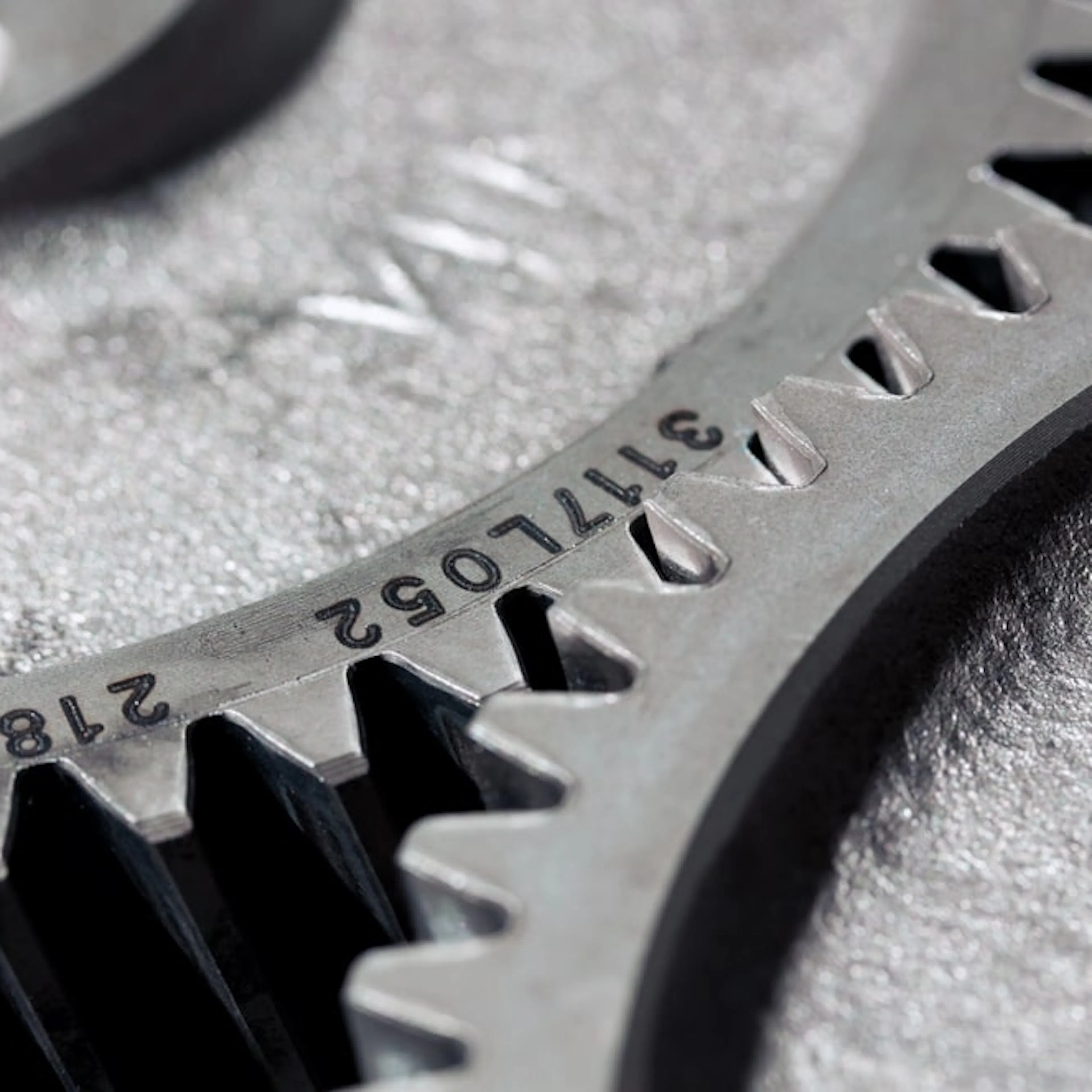

A serial number on a metal gear. Serial numbers are used for traceability. Image credit: Funnycreature/Shutterstock
