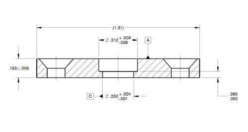

Tolerance is the acceptable range for a dimension which is determined by the designer based on the form, fit and function of a part. Unless specifically called out by the designer, the standard tolerance used by Xometry for CNC machining is +/- .005” for metal parts and +/- .010” for plastic parts.
If tighter tolerances (less than the standard, e.g. +/- .002”) are required, the information must be communicated as to which dimensions require a more narrow range. This can be specified at the part modification level in our instant quoting platform. As a point of reference, a piece of paper is about 0.003” thick.

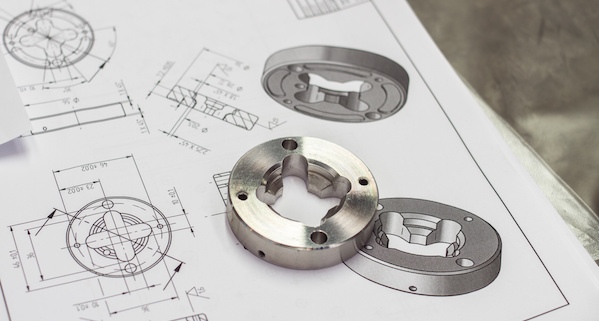

Overall geometric tolerances can also be applied to the drawing for the part. Based on the geometric tolerance and type of tolerance applied, additional cost may be the result because of increased inspection times.
The best way to apply tolerances is to only apply tight and/or geometric tolerances to critical areas when it is necessary to meet the design criteria to minimize costs.

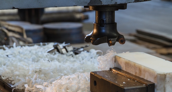

Tolerances are Material Dependent
The difficulty of manufacturing a part to a specific tolerance can be very material dependent. Generally, the softer a material is, the harder it is to hold a specified tolerance due to the material flexing while cutting. Plastics such as Nylon, HDPE, and PEEK may not hold as tight tolerances as steel or aluminum without special tooling considerations.
Drawing showing tolerances
