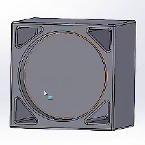

1. Coring and Wall Thickness
Coring reduces material volume, weight, and cycle time.
A lack of coring results in a chain of events which ultimately gives you a higher part cost. When you don’t have coring in your part, you get an uneven wall thickness. This in turn results in uneven cooling, which leads to sink marks. Because you have more material, and a greater material volume overall, you’ll get an increased cycle time (and higher cost as a result). This can also result in differential shrinkage and your part will go out of tolerance.

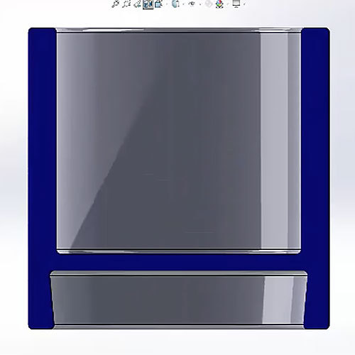

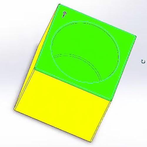

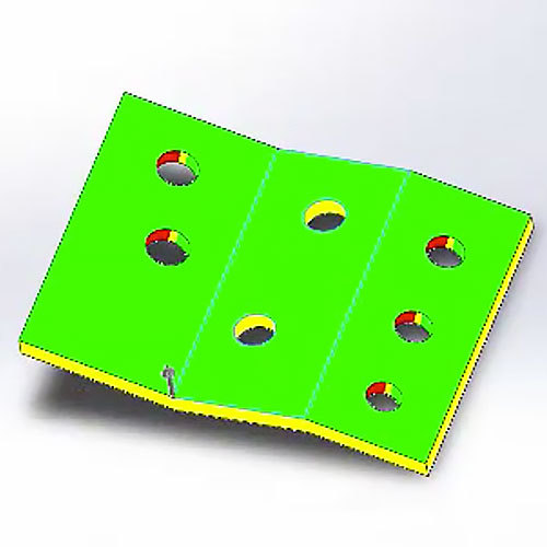

3. Die-Lock
To check if your part is die-locked, run a draft analysis in the direction the part will come out of the mold. Parts that are die-locked will require some action to pull the feature away at mold opening. This will greatly increase mold costs.

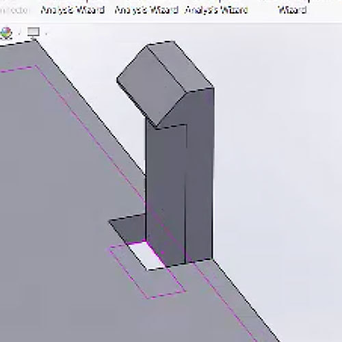

4. Pass-Thru Coring
Without pass-thru coring, clips, snaps and similar features require additional lifters or slides to release the part from the mold. This increases the overall mold cost.
To use pass-thru coring, insert a cutout thru the parallel feature for steel to shut-off.

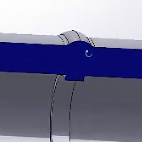

5. Annular Snap
Annular features may require additional slides or lifters to eject. This can be avoided by taking certain considerations:
  • Use soft materials, not hard or filled
  • Use the 1:3 rule, where the feature’s width should be 3x its height
  • Include “lead-in” and “lead-out” radii

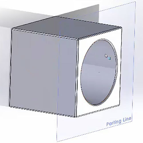

7. Parting Line
The parting line is important because it marks how the part splits when the mold opens. Careful placement of the line is crucial to avoid die-locking and other issues. Always think about how the part will come out of the mold and design accordingly.
