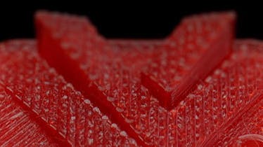

3D Printing Technology - It is important to choose the correct 3D printing technology for the project at hand. Generally speaking, fused deposition modeling (FDM) machines will create parts with rougher surface finishes whereas stereolithography (SLA) and selective laser sintering (SLS) can create smoother surfaces. However, these decisions need to be made in tandem with material selection, part design, and post-processing surface finishes, which we discuss in the next section.

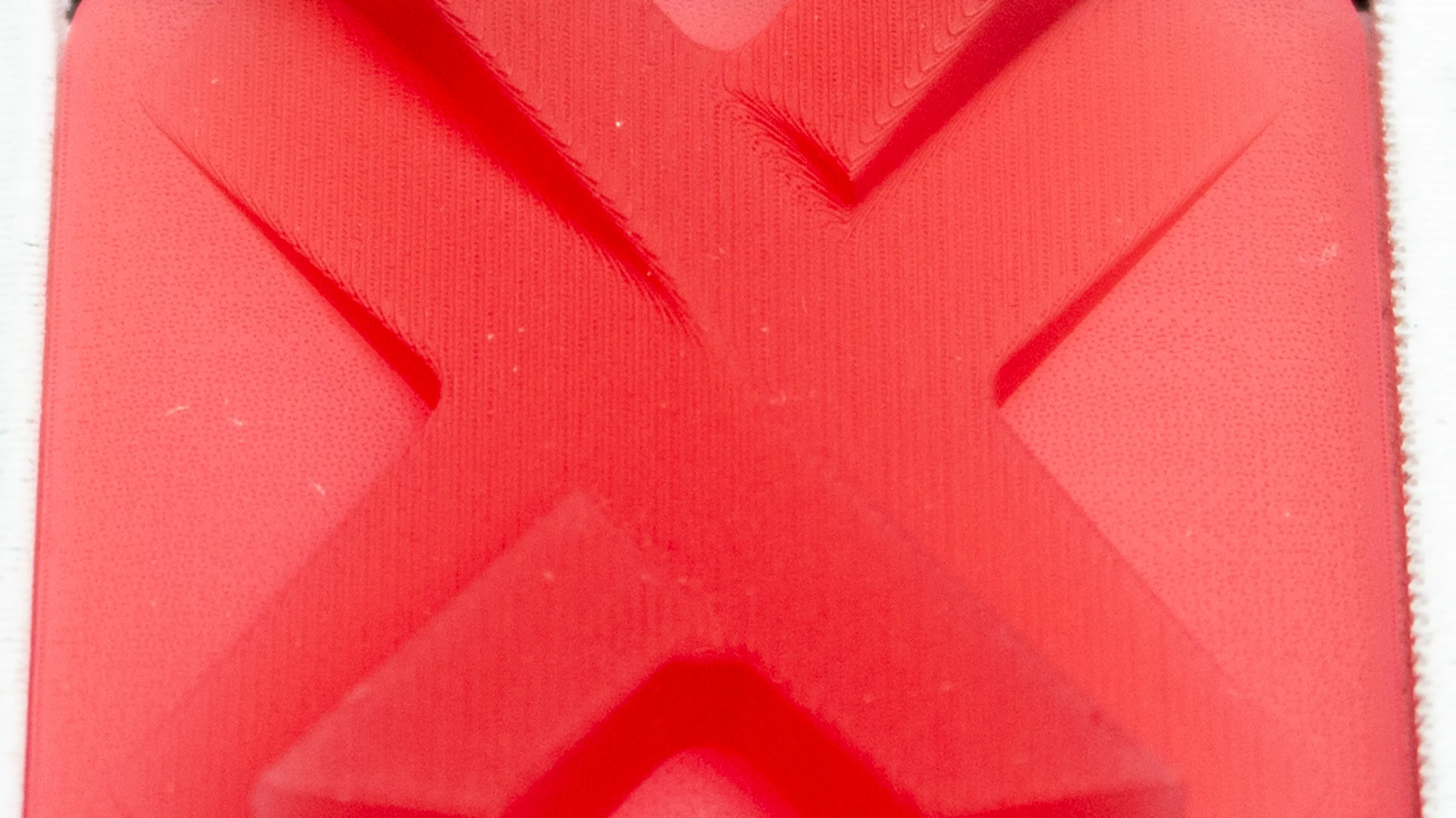

As-machined 3D-printed parts may have surface finishes with a roughness that does not meet the minimum 32 Ra surface roughness standard set by the 3-A Sanitary Standards. To help surface finishes achieve a surface smoothness that does not contain small pockets for bacteria growth and that can be easily cleaned, a part can undergo post-processes like mechanical finishing and surface coatings.
Mechanical and Chemical Finishing
To reduce the surface roughness of parts intended for food use, it is possible to use mechanical methods to smooth out certain materials. While metal parts respond well to polishing, some plastics can be ground, tumbled, or machined to improve their surfaces.
  1. Grinding - Abrasive wheels can be used to remove material and smooth surfaces. However, this is not ideal for complex geometries because grinding can only access cylindrical or planar areas.
  2. Tumbling - Tumbling can be used as a method of smoothing parts. However, similar to grinding, complex internal geometries are not well-suited to this method since internal corners and other features may be inaccessible to the abrasive media.
  3. Machining - Machining can be used on both plastic- and metal-printed parts to create smooth surfaces. While this is an option, this may not be practical or economical to scale and often does not work well for thin-walled parts.
  4. Polishing - Various methods of polishing can be used to smooth metallic parts. Polishing can be done as a manual process using progressive sanding techniques or via electropolishing (for metals).
  5. Vapor Smoothing - This process can be used to smooth some plastic parts by exposing them to solvent vapor. External edges and features will chemically melt and re-seal creating a smoother surface. The process, however, may not reliably smooth and remove all possible internal voids or crevices. Learn more about chemical vapor smoothing.
