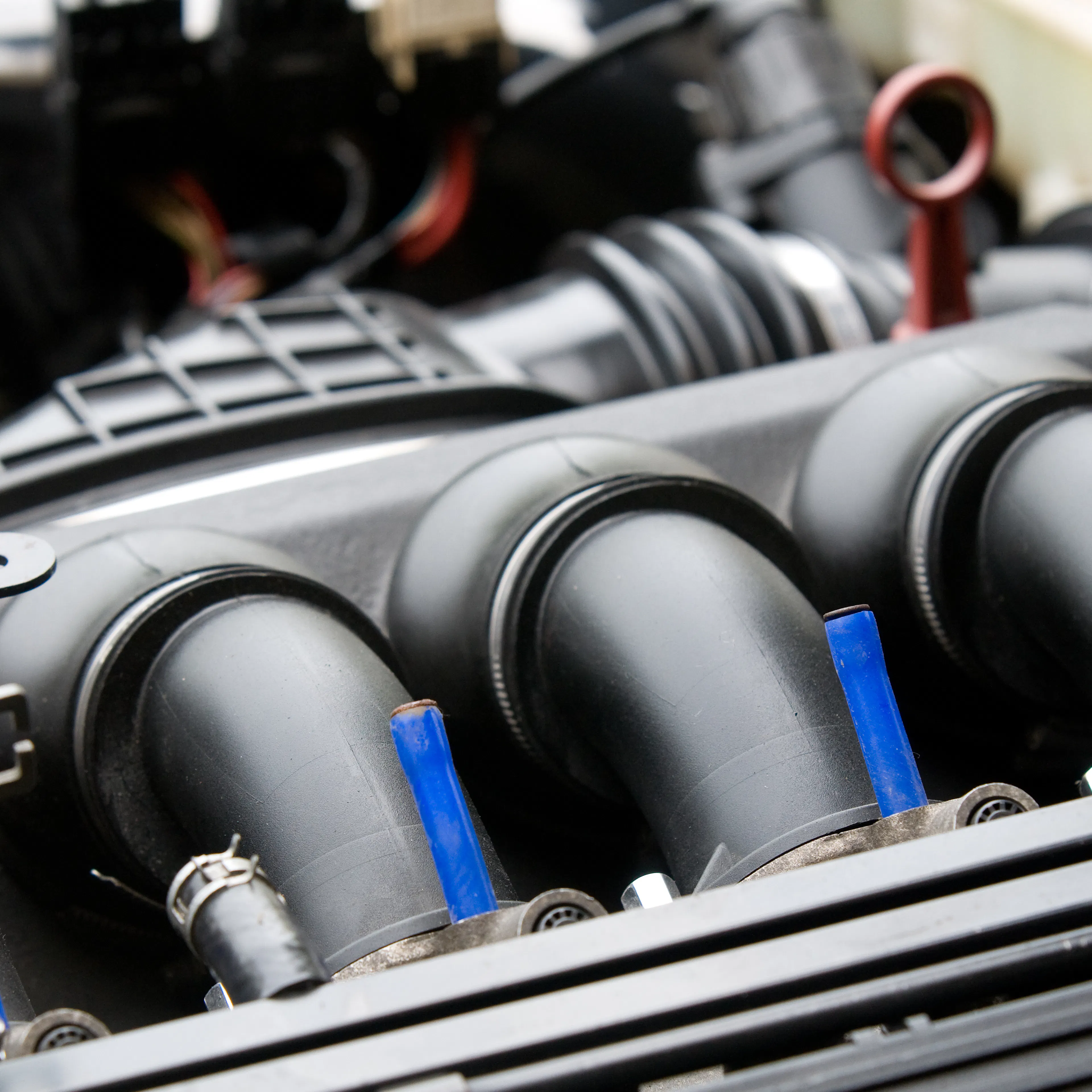

Injection molded intake manifold. Image Credit: iStockphoto.com/epixx

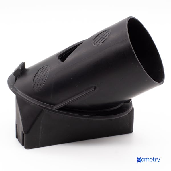

Black ABS Molded Part
