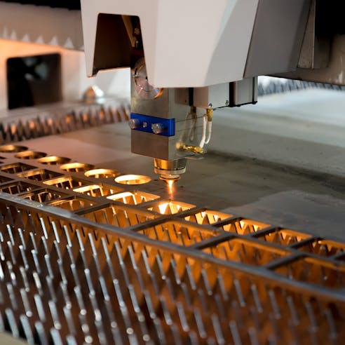

Laser-cut prototypes are pre-production parts shaped by means of a concentrated beam of electromagnetic energy. Laser cutting is valued for its speed, precision, versatility, and scalability. Some disadvantages of laser cutting make it unsuitable for some applications: high energy consumption, emission of harmful fumes from the material vaporized during the process, and limitations on the thickness of the material that can be processed. However, laser cutting’s capability to quickly and repeatably cut both metals and nonmetals, such as plastics and paper, makes it a popular choice for the fabrication of parts in the aerospace, automotive, medical, and military industries, among others.
Xometry offers the highest quality laser-cut prototyping services. We can fabricate your pre-production components using any required material from aluminum to steel, from Delrin® to polypropylene, and more. Our extensive manufacturing experience makes Xometry a sought-after supplier in the contract manufacturing industry.
What Are Laser-Cut Prototypes?
Prototyping using laser cutting is the non-contact cutting process of using electromagnetic energy to create parts for design and functional verification prior to mass production. Laser cutting technology is made possible by the use of a focused, coherent beam of light that is conditioned by a series of mirrors and lenses to create a spot as small as one square micron. This highly concentrated electromagnetic energy melts and vaporizes the material to be cut along a pre-programmed path while disturbing the rest of the workpiece very little. Laser cutting is a CNC-automated process that requires little human intervention. For that reason, it produces highly repeatable, extremely precise cuts at rapid paces. This makes laser cutting a great choice for prototyping as it allows manufacturers to quickly generate new iterations of a part, verify functionality, and scale up to series production manufacturing.

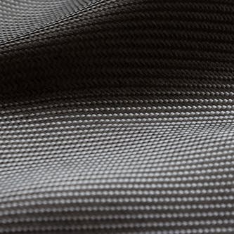

Carbon fiber composite. Image Credit: Shutterstock.com/Composite_Carbonman

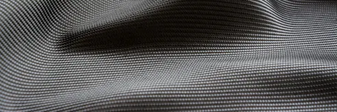

Carbon-Fiber Composites
Hybrid laser cutting machines, or machines that combine CO2 and fiber lasers together into a single laser, are best for cutting carbon-fiber composites. Carbon fiber is typically woven together into materials and then coated with a polymer matrix to secure the material together. The CO2 laser vaporizes the polymer matrix while the fiber laser cuts through the carbon fibers.

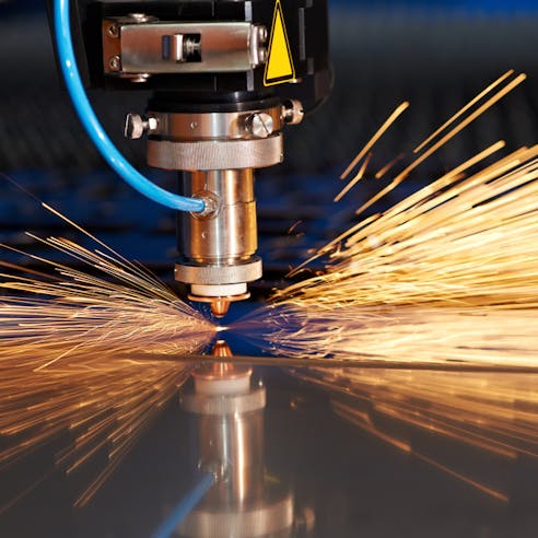

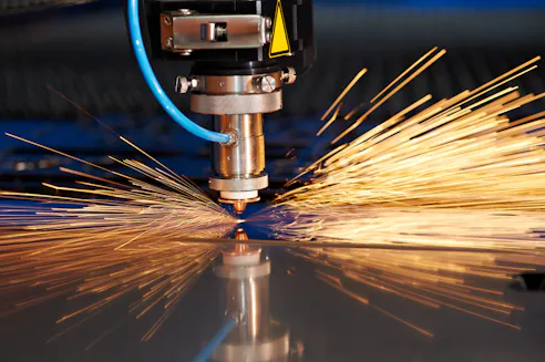

Laser cutting sheet metal. Image Credit: Shutterstock.com/Travelpixs
Material Thickness
Laser cutting is not suitable for cutting workpieces more than one inch thick. This is because thicker workpieces require exceptionally powerful laser cutting machines. Additionally, the highly concentrated light beam of a laser naturally diverges as it travels through space. This beam divergence reduces a laser’s cutting effectiveness as workpiece thickness increases.
Harmful Gasses and Fumes
Depending on the material being cut, harmful gasses and fumes can be released during laser cutting. This is commonly the case when cutting thermoplastics like Delrin® (POM) or fiberglass that release formaldehyde or cyanide, respectively. These fumes are toxic. Proper ventilation is required to remove them from the work area to maintain a safe environment for the operator.  Although adequate monitoring and ventilation reduce the workplace concentrations of cyanide and formaldehyde to safe levels, their safe release into the atmosphere must also be considered. Regional regulations for air quality define allowable levels that can be released into the environment.
High Energy Consumption
Laser cutting machines consume more energy than other cutting tools. For instance, a 3-axis CNC machine will consume about 1/10th the power of a laser cutting machine when cutting 40 mm steel plate blanks. While laser cutting machines consume more energy than CNC machines, they often complete parts at a much faster pace which can make them more cost-effective for some projects. Still, parts will have different geometric profiles and requirements — and laser cutting machines will not always be advantageous compared to CNC machines in terms of energy consumption.
Upfront Costs
While there are several relatively cheap laser cutting machines available on the market (<$1,000), commercial and industrial-sized laser cutting machines suitable for both prototyping and production are significantly more expensive. A CO2 laser cutting machine can cost anywhere between $2,000 and $1,000,000 while a fiber laser cutting machine costs between $30,000 to $600,000. Compared to a 3-axis CNC mill that may cost anywhere between $60,000-$300,000, laser cutting machines can be expensive.

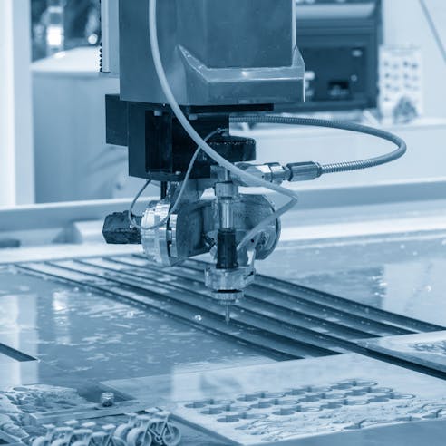

  • Waterjet Cutting: Waterjet cutting utilizes high-pressure water (up to 60,000 psi) to cut parts. Abrasives such as garnet are commonly added to the waterjet to improve its ability to cut materials. Waterjet cutting levels of precision are similar to laser cutting. It can produce parts with tolerances as small as +0.02”. However, unlike laser cutting machines, waterjet cutting machines cannot be used to mark or engrave parts and can only be used for cutting entirely through the material.
