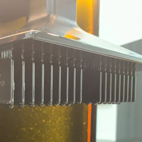

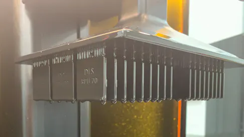

Carbon uses digital light projection, oxygen-permeable optics, and programmable liquid resins to produce products with end-use durability, resolution, and surface finish. This 3D printing technology is called Digital Light Synthesis™, or DLS for short. Another legacy term for the process is Continuous Liquid Interface Production (CLIP). Along with Carbon’s custom liquid resins, DLS unlocks new business opportunities and product designs previously impossible, including mass customization and on-demand inventory of end-use products.
Carbon bridges, and sometimes substitutes, for processes like Urethane Casting and Injection Molding service production, because the materials are urethane-based or epoxy-based, giving excellent mechanical properties. DLS elastomer and silicone resins outperform most other additive-manufactured rubber-like materials.
    Isometric illustration of the carbon DLS printing process.

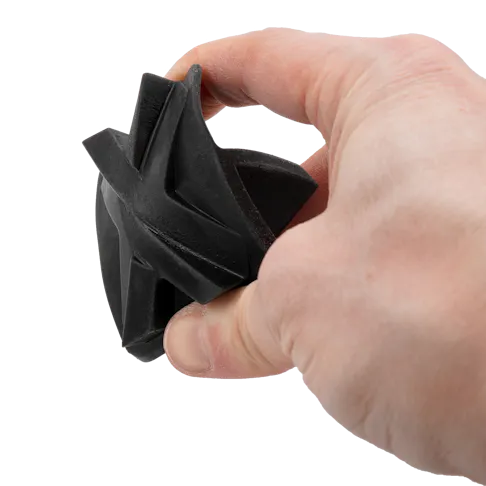

    Highly-elastic polyurethane
    Shore Hardness
    72A
    Elongation at Break (%)
    400%

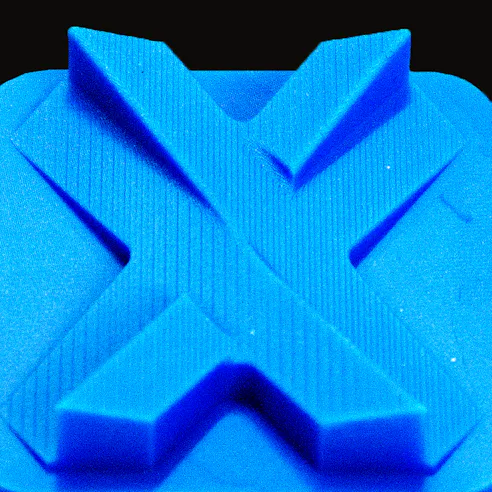

    Parts built with Carbon DLS technology will typically have a matte to semi-gloss surface finish depending on feature direction. Extended protrusions will show vertical lines in the part that are parallel to the direction of growth. Supports are removed and mitigated as required.

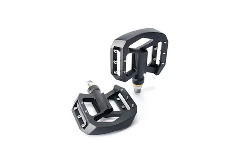

    End-Use Functional Parts
    Carbon DLS™ materials are fully dense and engineered for end-use

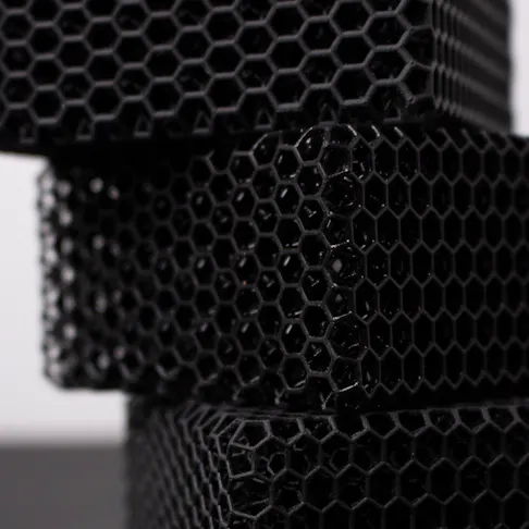

    Complex Shapes and Lattices

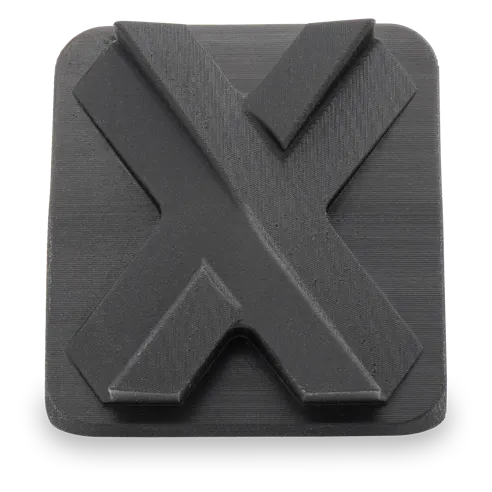

      Xometry tile in RPU 130 3D printed via Carbon DLS.
