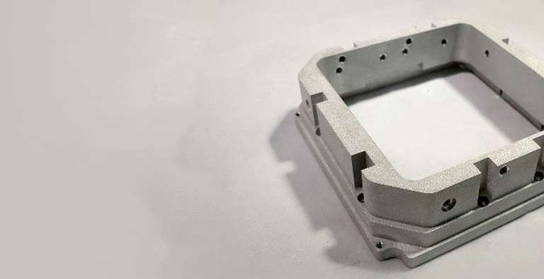

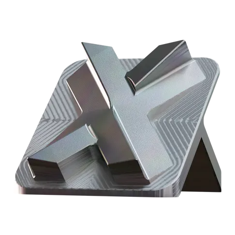

The finishing option with the quickest turnaround. Parts are left with visible tool marks and are deburred to remove sharp edges, unless otherwise specified. We adhere to a standard surface roughness of 125 μin Ra, unless a different surface roughness requirement is specified.
The part is cleaned, deburred, and placed in an abrasive blaster where surface deposits are removed by applying fine glass beads at high pressure, without damaging the surface. Bead blasted parts will have a matte or satin-like appearance.

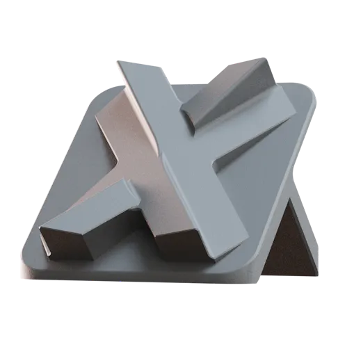

Type II creates a corrosion-resistant finish. Parts can be anodized in different colors—clear, black, red, and gold are most common—and are usually associated with aluminum. Type III, also known as hardcoat anodizing, is thicker and creates a wear-resistant layer in addition to the corrosion resistance seen with Type II.

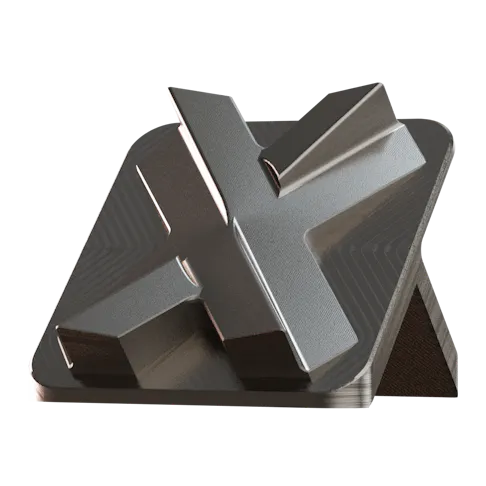

These are treatments that enhance the surface properties of machined parts without significantly altering dimensions. Processes such as chromate conversion, passivation, black oxide, and electropolishing improve corrosion resistance, surface cleanliness, appearance, and in some cases, lubricity or electrical performance.

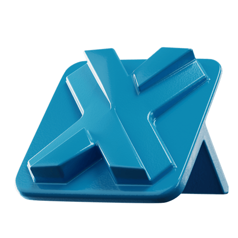

Powder coat and wet paints provide a durable, protective layer that resists corrosion, wear, and UV damage. They offer a uniform, attractive appearance while preserving the underlying part’s precision and performance.

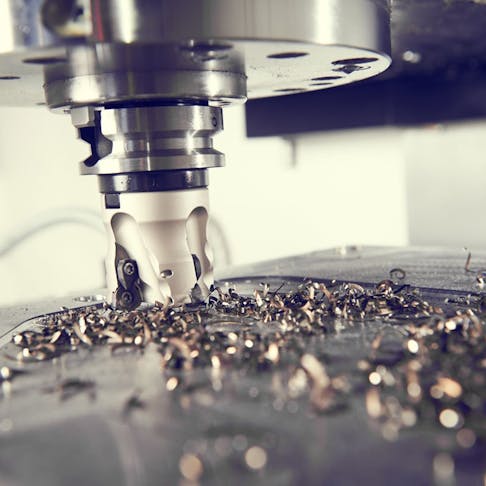

CNC mills are automated cutting machines using a rotating spindle-head to cut away unwanted material. CNC milling machines come in a variety of sizes and different axis configurations. This manufacturing process is mainly utilized to cut harder metals but can work with workpiece materials ranging from plastic and aluminum to stainless steel and titanium.
How CNC Milling Works
CNC mills excel at profile cutting harder materials. Like all CNC machines, a CNC mill is controlled with G-Code created through CAM software. The Gg-Code instructs the machine where to move the tool head, how fast to spin the tool, how deep to cut, how to move the workpiece, and other factors relating to speed, feed rate, and coordination. The G-Code complexity depends on how many axes the milling machine has.
