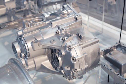

Die casted metal housing assembly

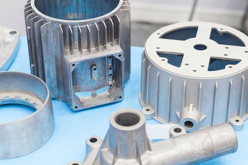

Die cast metal parts
