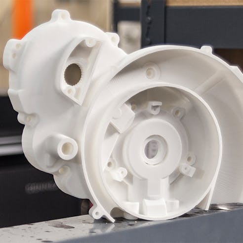

    SLS can be used to create fully-functional prototypes, complete with moving parts, as well as all-in-one assemblies.

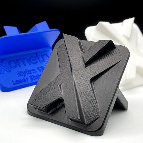

    SLS selective laser sinter nylon dyed blue part
