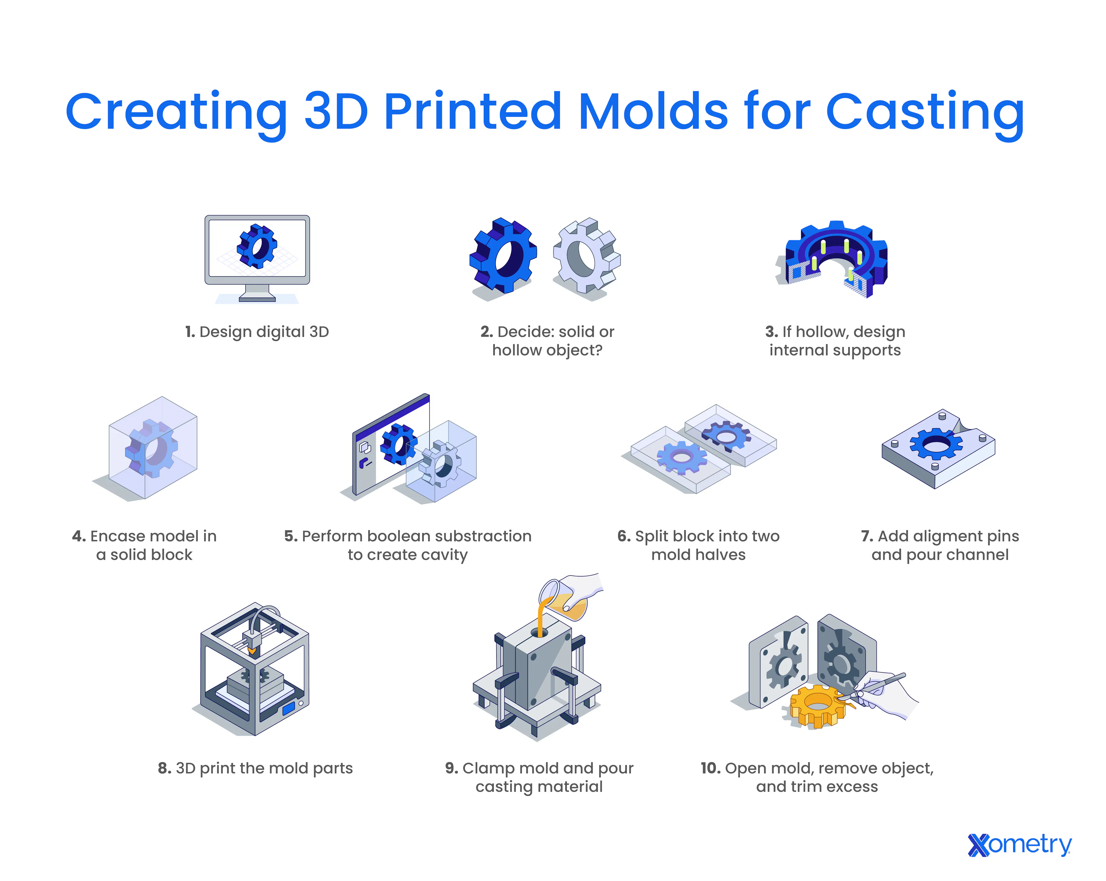

To create 3D-printed molds for casting, there are ten steps to follow (CAD model creation to pour the silicone). 3D‑printed casting molds are digitally designed mold structures produced through additive manufacturing to support accurate and efficient casting processes across multiple industries. Detailed cavity geometry forms the foundation of each mold, which establishes strong dimensional control during metal, resin, or elastomer casting. Material selection determines heat resistance, strength, and surface texture, which influences mold durability and casting quality. Printing methods shape layer resolution and structural stability, which guide performance during filling, curing, or thermal exposure. The combination of precise design, stable materials, and adaptable production techniques creates a versatile mold‑making approach suited for prototyping, short‑run manufacturing, and specialized casting applications.
1. Create or Import the CAD Model
Create or import the Computer-Aided Design (CAD) model by defining accurate geometry that reflects the intended casting shape with balanced proportions and clear boundaries. Establish detailed contours that support mold formation and maintain consistent dimensional accuracy. Finalize the model by confirming that every feature contributes to stable mold construction and predictable casting performance.
2. Decide Whether the Part Should Be Hollow or Solid
Decide whether the part should be hollow or solid by examining strength demands, weight goals, and thermal behavior during casting. Evaluate how each configuration influences durability, curing stability, and material usage. Select the structure that aligns with the required performance, so the mold supports reliable shaping and consistent final quality.
3. Add Internal Structure if the Model Is Hollow
Add internal structure if the model is hollow by forming reinforcing elements that stabilize the walls during printing and casting. Shape internal ribs or lattice zones to distribute stress evenly and prevent collapse under pressure. Maintain smooth transitions within the structure, so material flow remains steady and dimensional accuracy remains protected.
4. Add Mold Keys and Alignment Features
Add mold keys and alignment features to maintain precise registration between mold sections during assembly. Form interlocking shapes that prevent shifting and preserve cavity accuracy under clamping force. Position alignment points along the parting line so sealing strength and structural stability remain consistent throughout the casting process.
5. Create a Mold Block Around the Model
Create a mold block around the model by enclosing the geometry in a solid volume that forms the outer structure of the mold. Establish uniform wall thickness to resist heat and pressure during casting. Shape internal boundaries to support clean separation after curing and maintain the integrity of the final part.
6. Split the Mold Block Into Two or More Sections
Split the mold block into two or more sections by defining parting lines that follow the natural geometry of the model. Form clean separation planes that allow easy removal of the finished casting without damaging fine details. Balance the division so each section maintains structural strength and accurate reassembly.
7. Embed the Model Into the Mold Block and Add Vents/Pour Spouts
Embed the model into the mold block by positioning it within the solid volume so the cavity forms accurately around it. Add vents to release trapped air and pour spouts to guide material into the cavity with a steady flow. Arrange each feature to support uniform filling and reduce the risk of voids or incomplete curing.
8. Prepare the 3D Printer and Print the Mold
Prepare the 3D printer by calibrating the build platform, selecting a material with adequate strength and heat resistance, and applying slicing settings that support dimensional accuracy. Arrange mold sections on the build plate to reduce distortion and maintain stable geometry. Start the print once all parameters align with the mold’s structural requirements in 3D Printing.
9. Clean, Sand, and Post-Process the Mold
Clean the mold by removing residue from printing and smoothing surfaces to refine contact points. Sanding reduces layer lines and strengthens sealing during casting. Inspect each section to confirm dimensional accuracy and ensure that the mold fits together with stable alignment.
10. Pour the Silicone or Casting Material and Trim Excess After Curing
Pour the silicone or casting material into the prepared mold through the designated spout to fill the cavity completely. Allow the mixture to cure until the structure stabilizes and forms the intended shape. Remove the casting and trim excess material to restore clean edges and achieve a finished part with consistent detail and dependable strength.

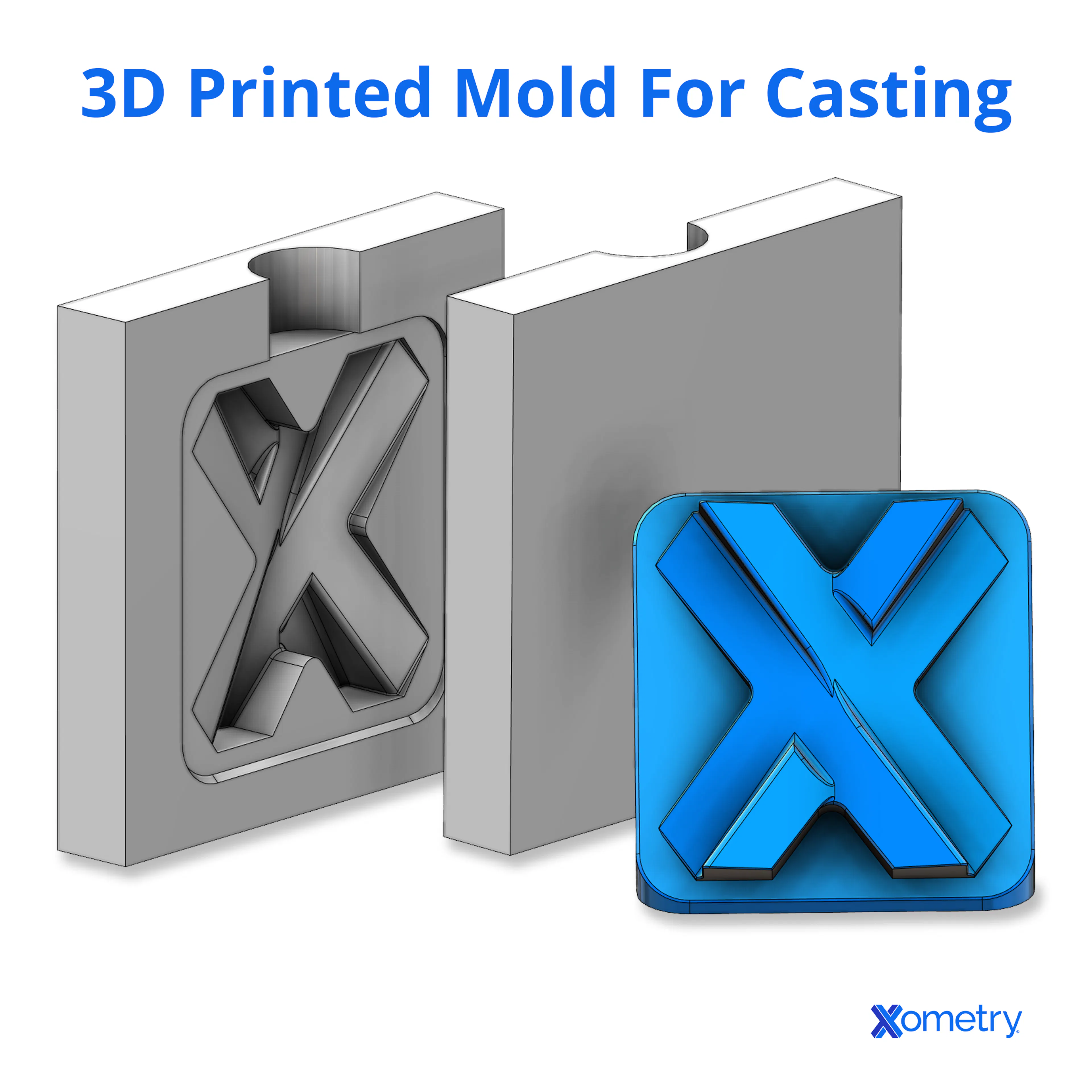

Creating 3D Printed Molds For Casting
How to Make Custom 3D Molds?
To make custom 3D molds, follow the twelve steps below.
  1. Define project requirements. Establish part geometry, target dimensions, production quantity, and performance needs so the mold design supports the intended application.
  2. Select a suitable CAD platform. Choose modeling software that supports precise solid modeling, assembly features, and export formats compatible with 3D printing workflows.
  3. Create or import the part model. Build the 3D representation of the desired part or load an existing file, then confirm accurate scale and clean geometry.
  4. Plan mold type and parting strategy. Decide on single‑part, multi‑part, or insert‑style construction and outline parting lines, gating locations, and vent paths.
  5. Design the mold cavity and draft. Offset the part surfaces to form the cavity, add draft angles for release, and adjust wall thickness for strength and heat resistance.
  6. Add mold keys and alignment features. Integrate interlocking keys, guide faces, and orientation markers so repeated assembly maintains accurate cavity registration.
  7. Build the mold block and external supports. Enclose the cavity in a solid block with adequate margins, gripping features, and flange areas for clamping or fixtures.
  8. Integrate pour spouts and vent channels. Model inlets for the casting material and paths for trapped air to escape, while preserving structural integrity around each opening.
  9. Check printability and service conditions. Validate minimum feature sizes, overhangs, and thermal loads so the selected printing process and material match project demands.
  10. Export and slice the mold design. Save the mold bodies in a compatible format, import them into slicing software, and set layer height, infill, and orientation for accurate printing.
  11. Print the mold and inspect the parts. Produce the mold components, then examine surfaces, dimensions, and fit between sections to confirm readiness for casting.
  12. Post‑process and prepare for casting. Clean residual powder or support material, sand critical surfaces, seal porous regions if needed, and apply release agents to ready the mold for custom casting projects.
