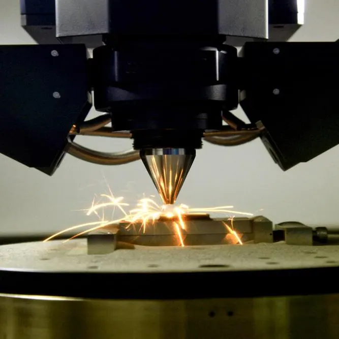

3D printed metal piece. Image Credit: Shutterstock.com/sspopov
“Metal 3D printing” is an umbrella term that is used to describe several manufacturing processes for additive manufacturing of metal parts. The material is processed in a layer-by-layer manner, through sintering, welding, or melting. Two common metal 3D printing processes are Selective Laser Melting (SLM) and Direct Metal Laser Sintering (DMLS). Both of these use powder-bed fusion technology. While metal 3D printing can produce parts from a large range of metals and metal alloys, the best materials for metal 3D printing are stainless steel, tool steels, titanium, and Inconel® (nickel-based) alloys.

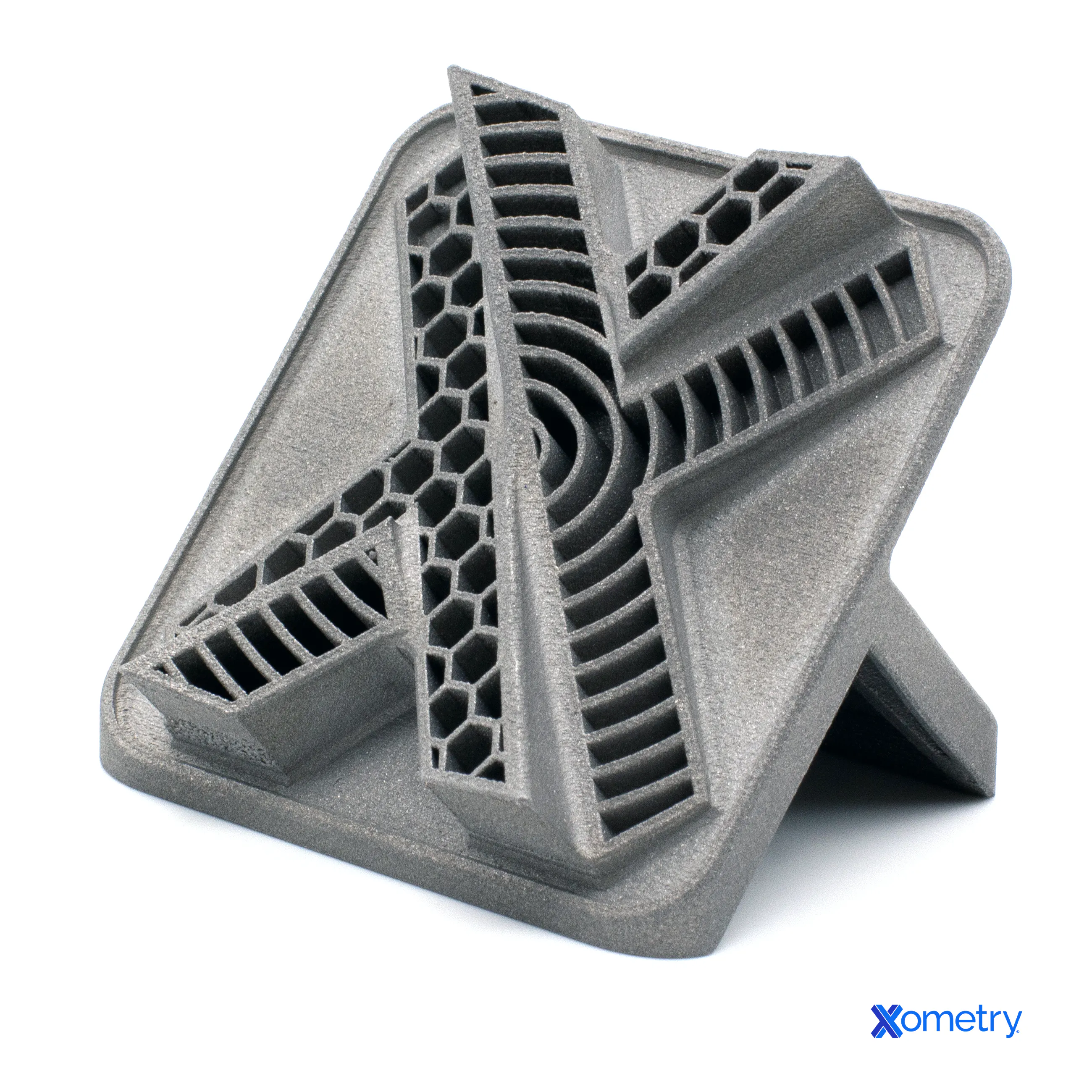

Stainless steel is widely known for its ability to withstand corrosion, high strength, and excellent aesthetic appearance. Parts printed with stainless steel can have the same or even greater strength than parts created using traditional manufacturing methods. The strength, hardness, and other properties of 3D-printed stainless steel depend mainly on the specific technology used to print the part.
Stainless steel-printed parts have found application in many industries, including aerospace, automotive, military hardware, and medical. Compared to other metal 3D printing materials, stainless steel parts can be made with the smoothest surfaces because of the addition of chromium.
Stainless steel powder used for 3D printing comes in a variety of grades and alloys, including  316L, 304L, 630, 410, 420, 254, 17-4 PH, 15-5PH, PH1, and GP1. Of these, 316L is the most commonly used grade in metal 3D printing. It has a composition of 66-70% iron enhanced with 16-18% chromium, 11-14% nickel, 2-3% molybdenum, and less than 0.03% carbon. This 3D printing material is known for its ductility and good corrosion resistance.
A stainless steel part printed with Xometrys DMLS service.

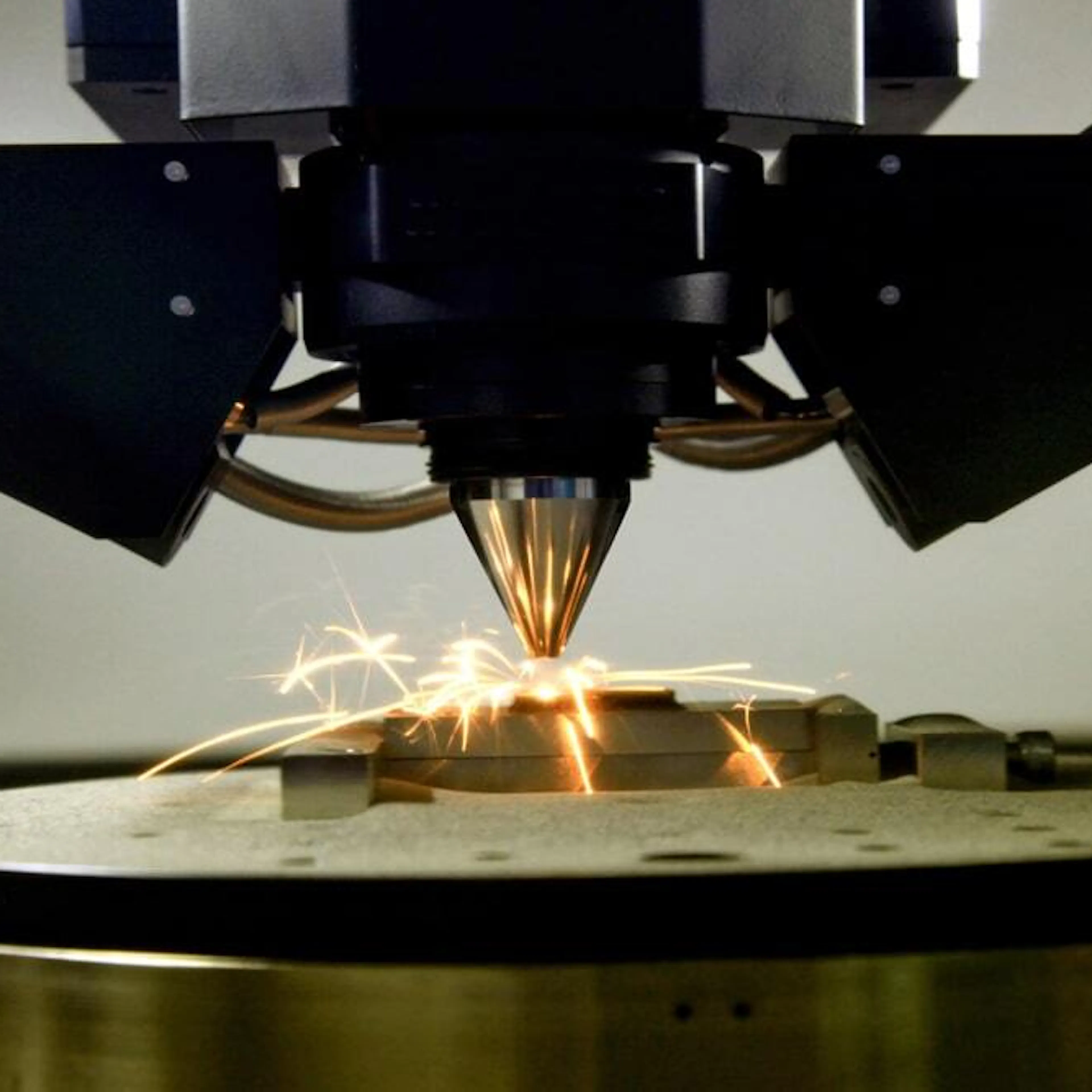

With powdered metal 3D printing, the metal powder for the first layer is spread out by the powder coater, or recoater, on the floor of the build platform. A high-powered laser or electron beam is then used to selectively bind together the material as it scans the powder. This creates one solid layer of the object. The platform is then displaced downwards by 50-200 microns while another even layer of metallic powder is distributed over the previous layer and the process is repeated.

Parts being made in a DMLS metal 3D printing machine
