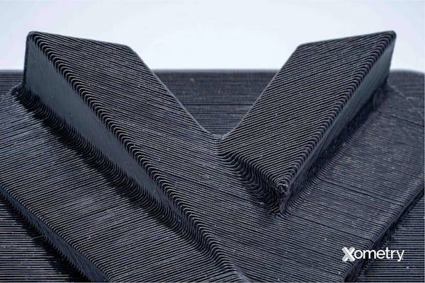

Close-up image of an FDM 3D printed part by Xometry.

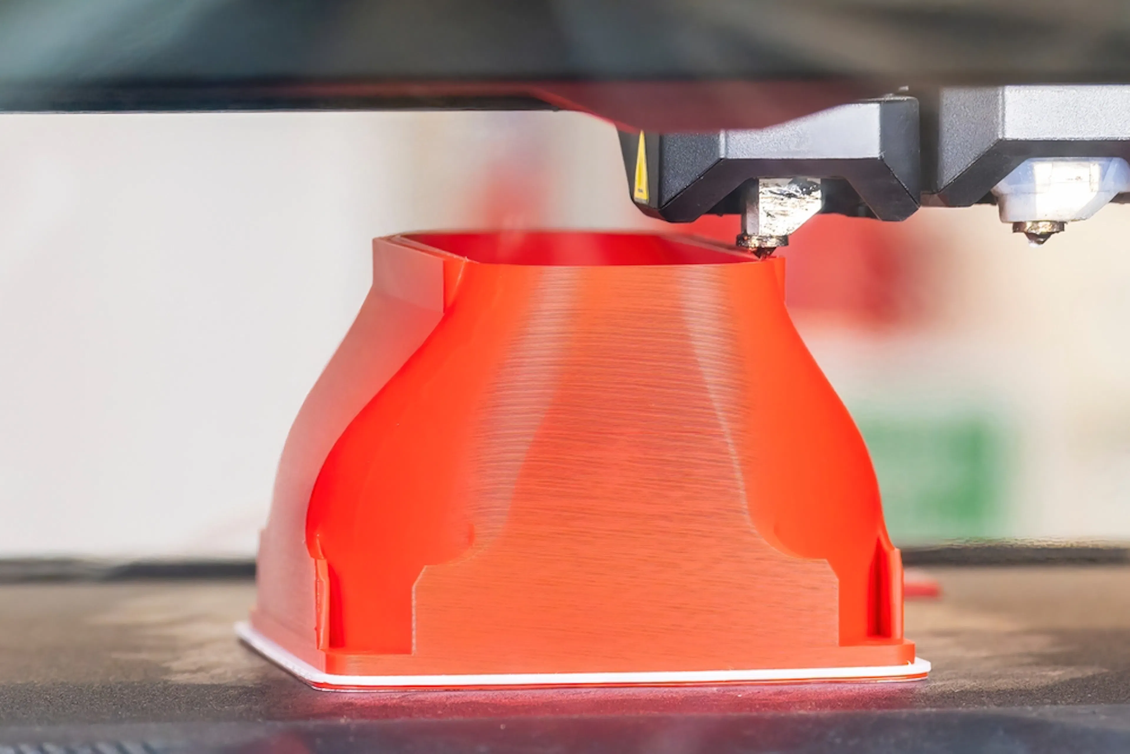

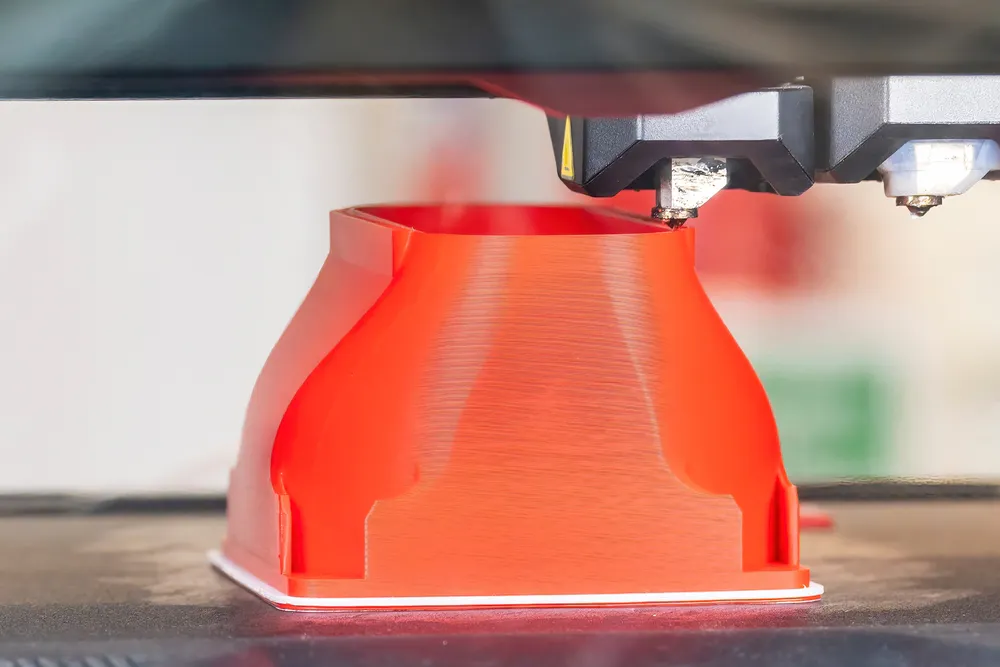

A filament 3D printer works by feeding a large piece of plastic filament from a spool into a nozzle. This is heated, melted, and liquefied before it passes through the extruder and nozzle, and released onto the build plate or subseqeuent layers. The nozzle extrudes the filament as it moves in a pre-set pattern one layer at a time until it’s finished printing the object. As the printed layers are deposited, the filament will start to cool and solidify. Since FDM is a relatively straightforward process it can easily be scaled up, allowing for very large pieces to be printed. For example, our machines at Xometry have a build volume of up to 36x”36”24”!

There are a few things to keep in mind when it comes to filament 3D printing. For starters, FDM prints often have prominent layer lines which can be unsightly. Although it does not require as many post-processing steps as resin-based processes like SLA, it can still be a slow building process, especially for large parts.
It’s also worth noting that support structures will need to be printed alongside the main model to keep it intact. You’ll have to then remove and throw away the supports, making the whole process longer, and also a bit wasteful. Perhaps the most frustrating thing, however, is its tendency for parts to warp while printing unless you have all the correct settings and conditions dialed in, which will likely take some trial and error to get just right. This is why Xometry uses industrial FDM platforms which are optimized for printing a wide range of materials with high reliability and quality.
