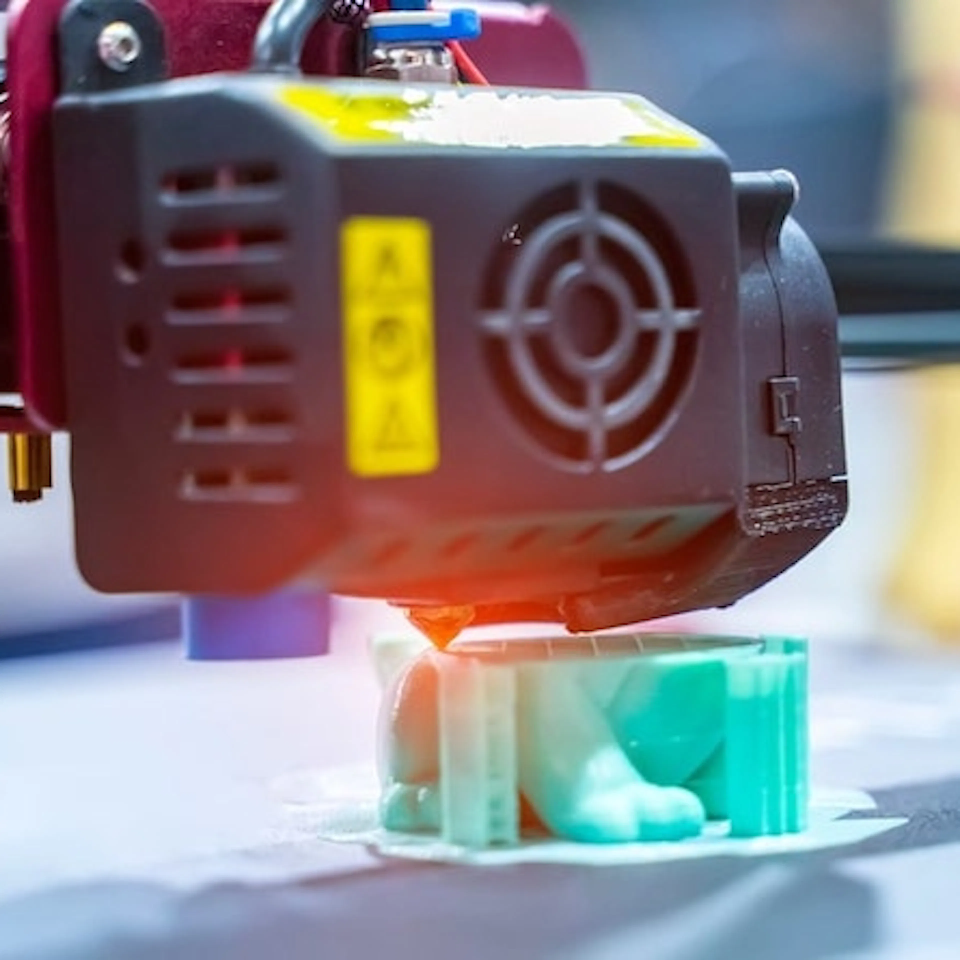

3D printer additive manufacturing and robotic automation technology. Image Credit: Shutterstock.com/asharkyu
Additive manufacturing refers to the process of creating a part by incrementally building it up via the addition of material. This material can be metal, ceramic, plastic, photopolymer, or even food! ISO/ASTM has categorized all the different types of additive manufacturing technologies into seven categories.
This article will describe how each of these types of additive manufacturing processes works,  as well as their uses, advantages, and differences.

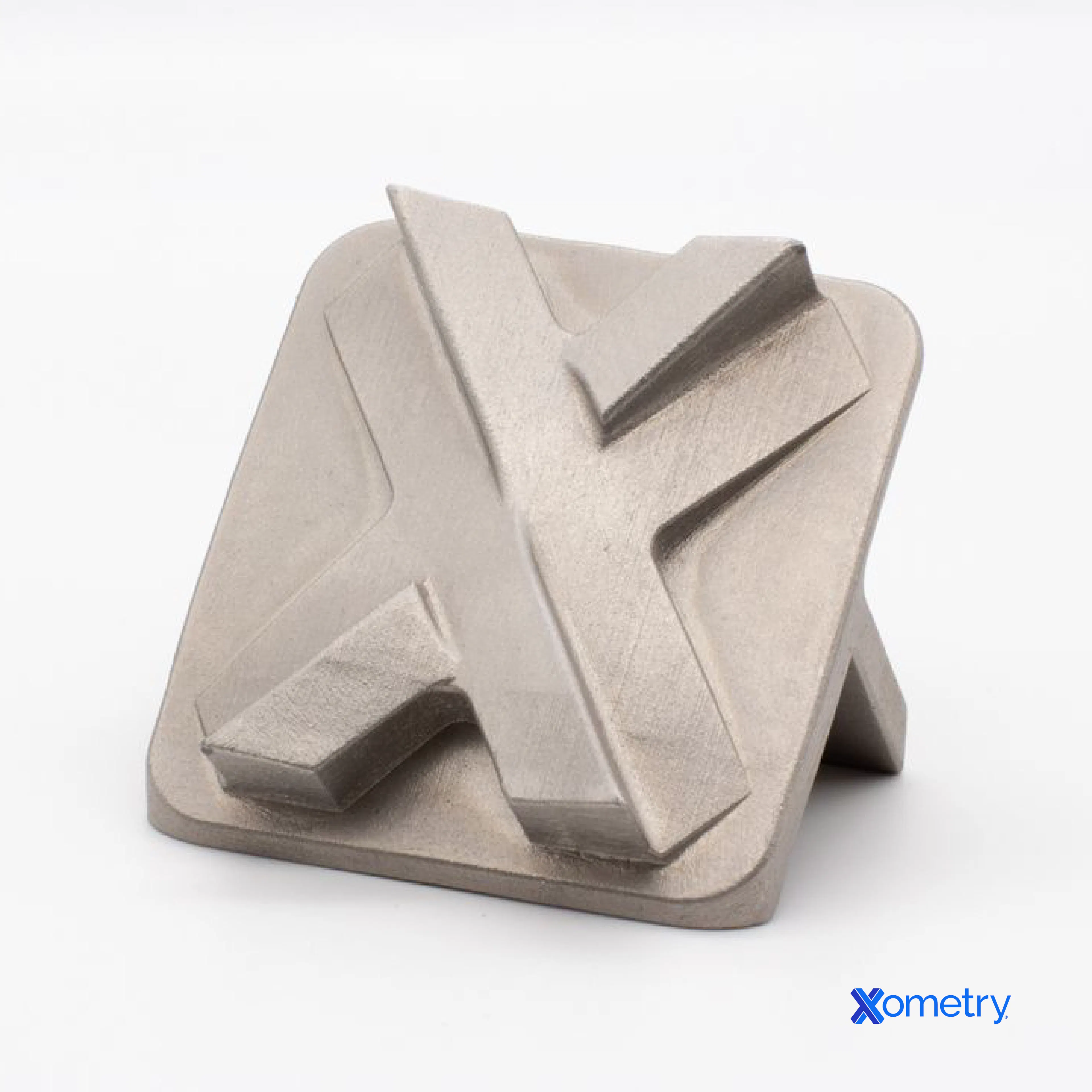

Stainless steel part made by Xometry via Binder jetting.
Binder Jetting is a powder bed-based additive manufacturing technology that creates parts by selectively depositing a binding agent onto a thin layer of powdered material. The process begins as the printer lays down a uniform layer of powder, typically plastic, metal, sand, or ceramic, on the build platform. A recoating blade is used to ensure that a precise layer of powder is distributed on the build platform. This is typically done by the recoater blade, transferring material from a powder storage bin next to the print area. The material in the storage bin is lifted, and the recoater blade sweeps the powder from the storage bin across the build platform at the required layer height. Next, an inkjet head moves over the powder and dispenses a binding agent over the powder in the shape of the part cross-section for the current layer. For full-color plastic parts, the binding agent also contains a colorant to create multiple-color parts.
The print bed then moves down by one layer height. The recoating blade distributes another layer of powder on top of the previous one, and the process continues. When binder jetting metals, the part must be sintered after printing to eliminate porosity and improve the mechanical strength. Alternatively, a low-melting-temperature metal powder like bronze can be mixed with the primary material. When the printed part is heated, the bronze will melt and fill the spaces between the primary metal alloy powder particles.

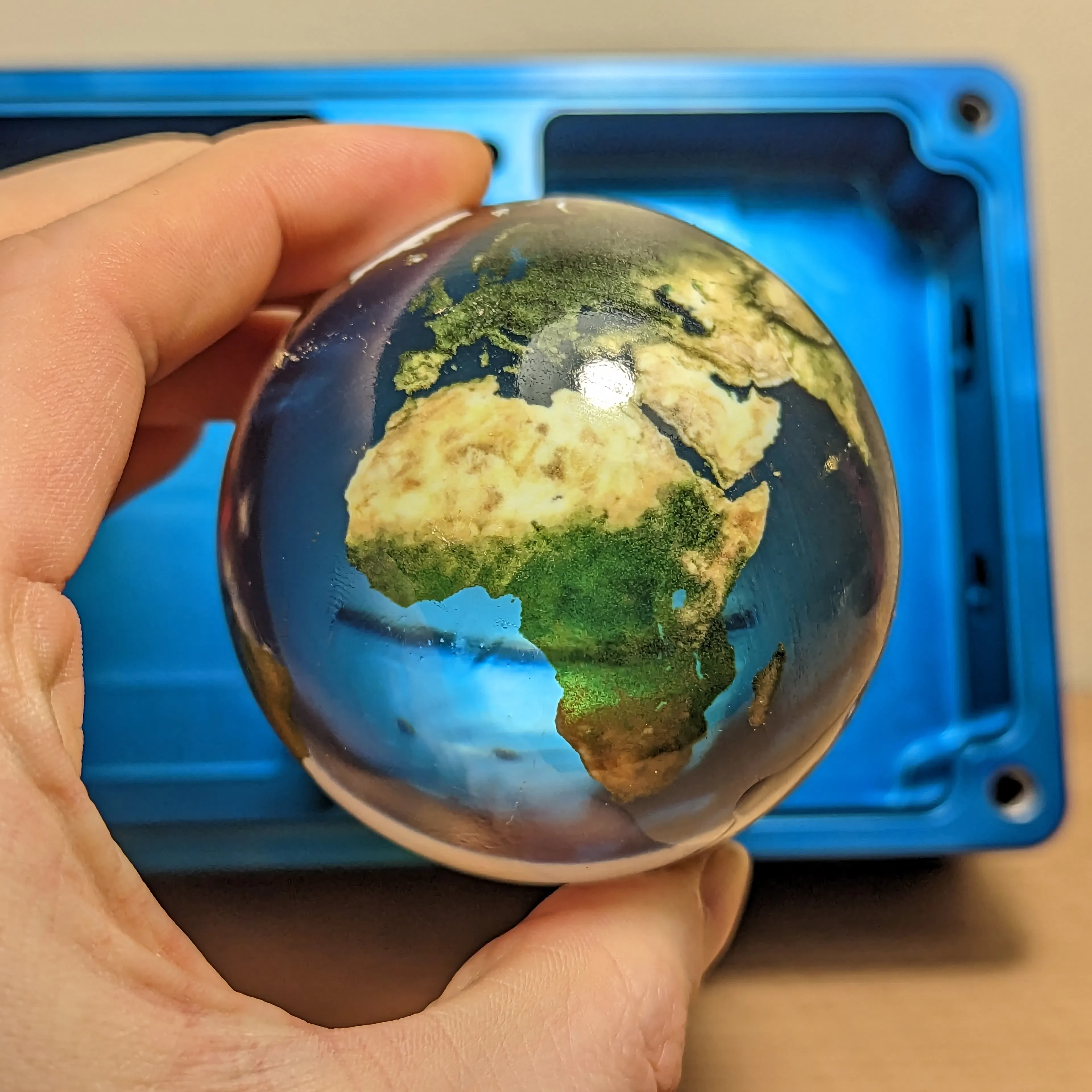

A full-color part with a polished and clear coated finish, made using Xometry's PolyJet service.
Material jetting utilizes a series of inkjet nozzles to deposit material onto a build platform, creating a part. This process requires the use of photopolymers as raw materials. It works by first depositing a layer of photopolymer onto the build platform. Next, a UV light source moves over the photopolymer to cure it. The build platform then moves down, and the process is repeated.
Since UV-light curing of the printed material is an integral part of this additive manufacturing process, only plastics, many of which are photopolymers, can be printed by material jetting. Support structures are required to print parts successfully by material jetting.

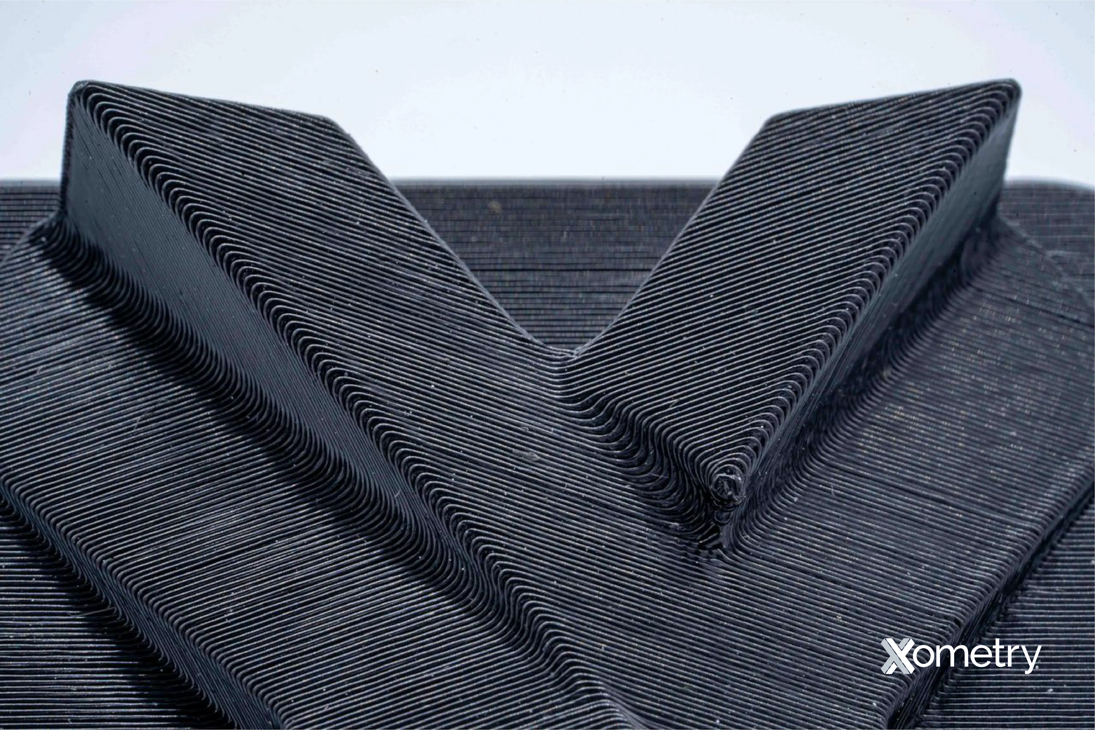

Close up of a FDM printed part made by Xometry.
Material extrusion is one of the most well-known types of additive manufacturing, mainly due to its adoption by the consumer market. Material extrusion is often referred to as FDM (Fused Deposition Modeling), or FFF (Fused Filament Fabrication). The process works by directing a plastic filament from a supply spool, passing it through a heated chamber, and then out of a print nozzle. As the material exits the nozzle, it is deposited in the form of the current part cross-section on the build platform. Once a layer is complete, the print heads move up by one layer thickness. The process is repeated until the part is complete.
Thermoplastics and filled thermoplastics are the most typical raw materials used with this technology. However, metallic powder/polymer matrix materials can be used to create metal parts. They must be post-processed in a furnace to develop their final mechanical properties.
