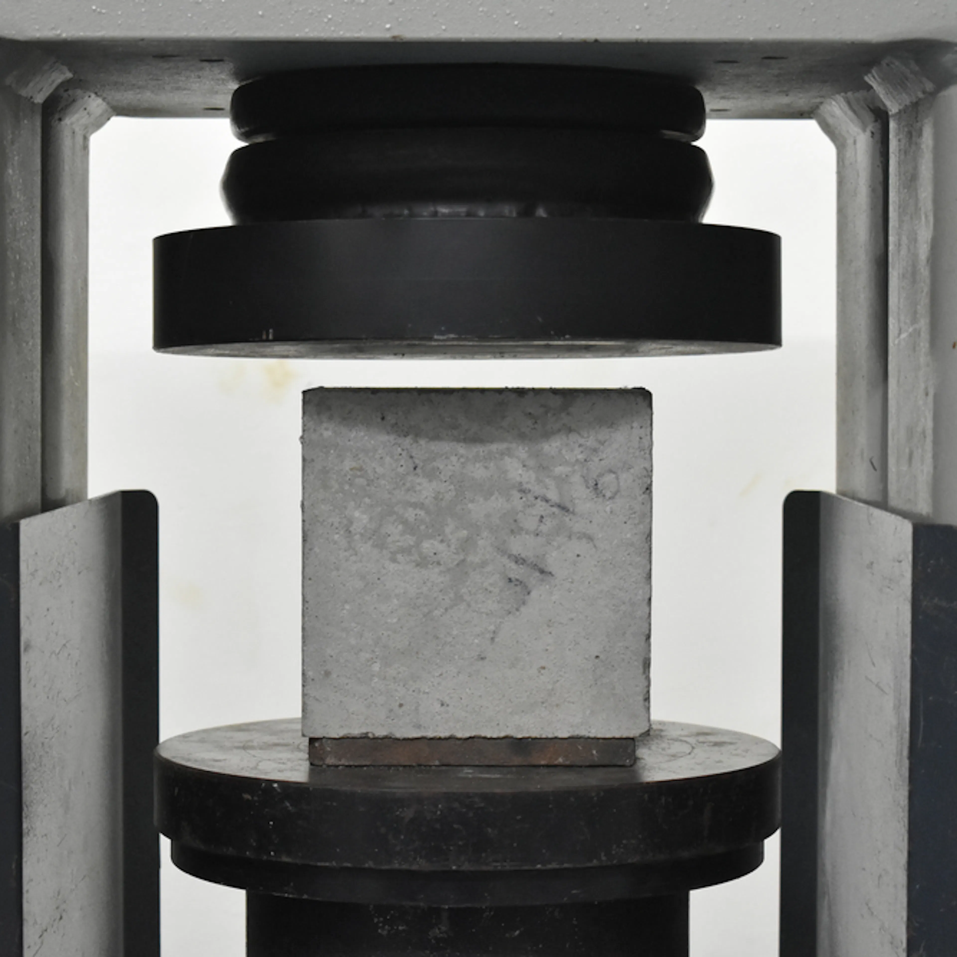

Concrete cube compression test. Image Credit: Shutterstock.com/Zubair Rashid
Compression testing is a widely used mechanical test that provides valuable insights into the behavior of materials when subjected to compressive loads. The test is essential in selecting the right material for various applications in industries such as aerospace, automotive, and construction. This article will delve into the definition, purpose, applications, and how compression testing works, as well as the steps involved in performing a compression test.

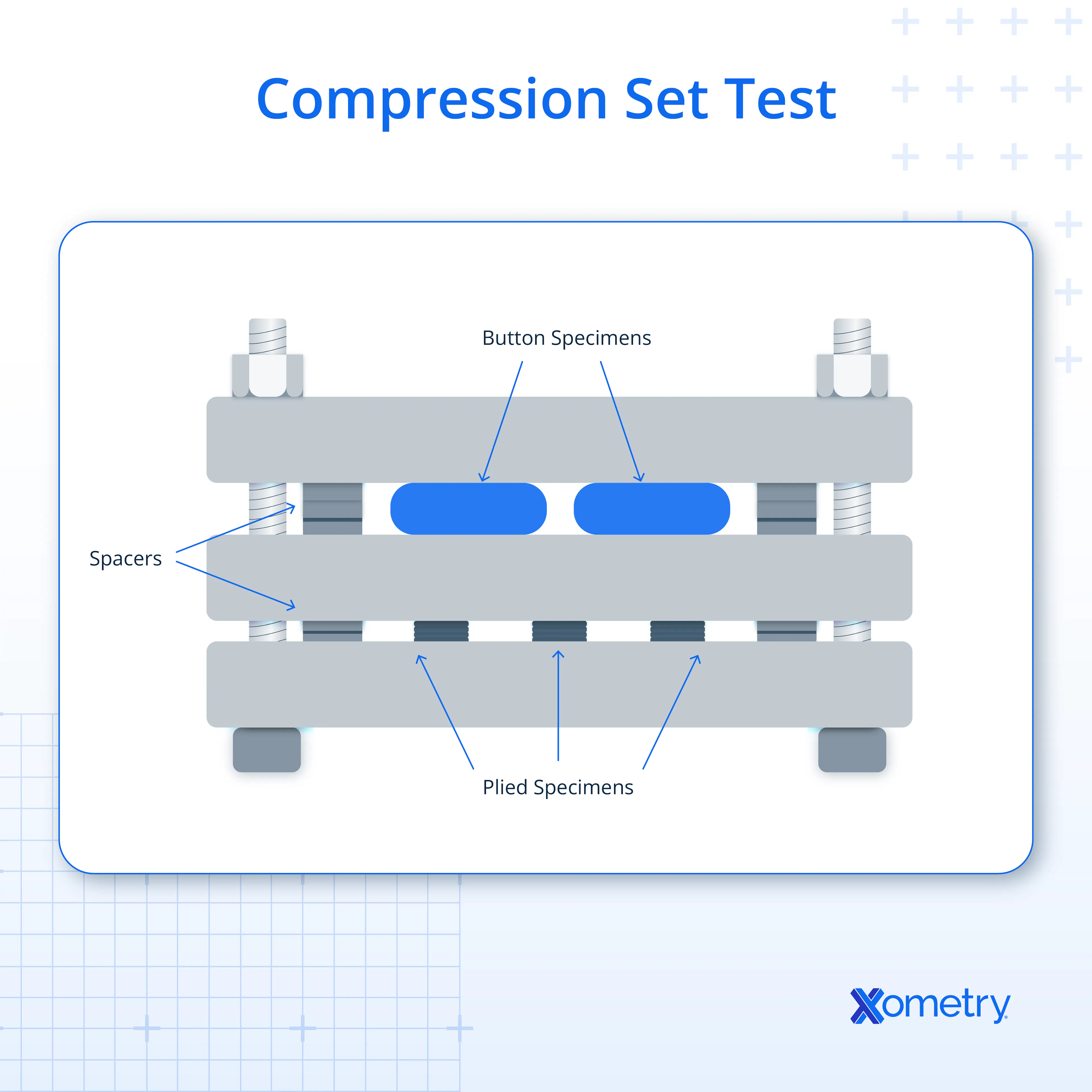

Compression set test
An illustration of a compression set test.

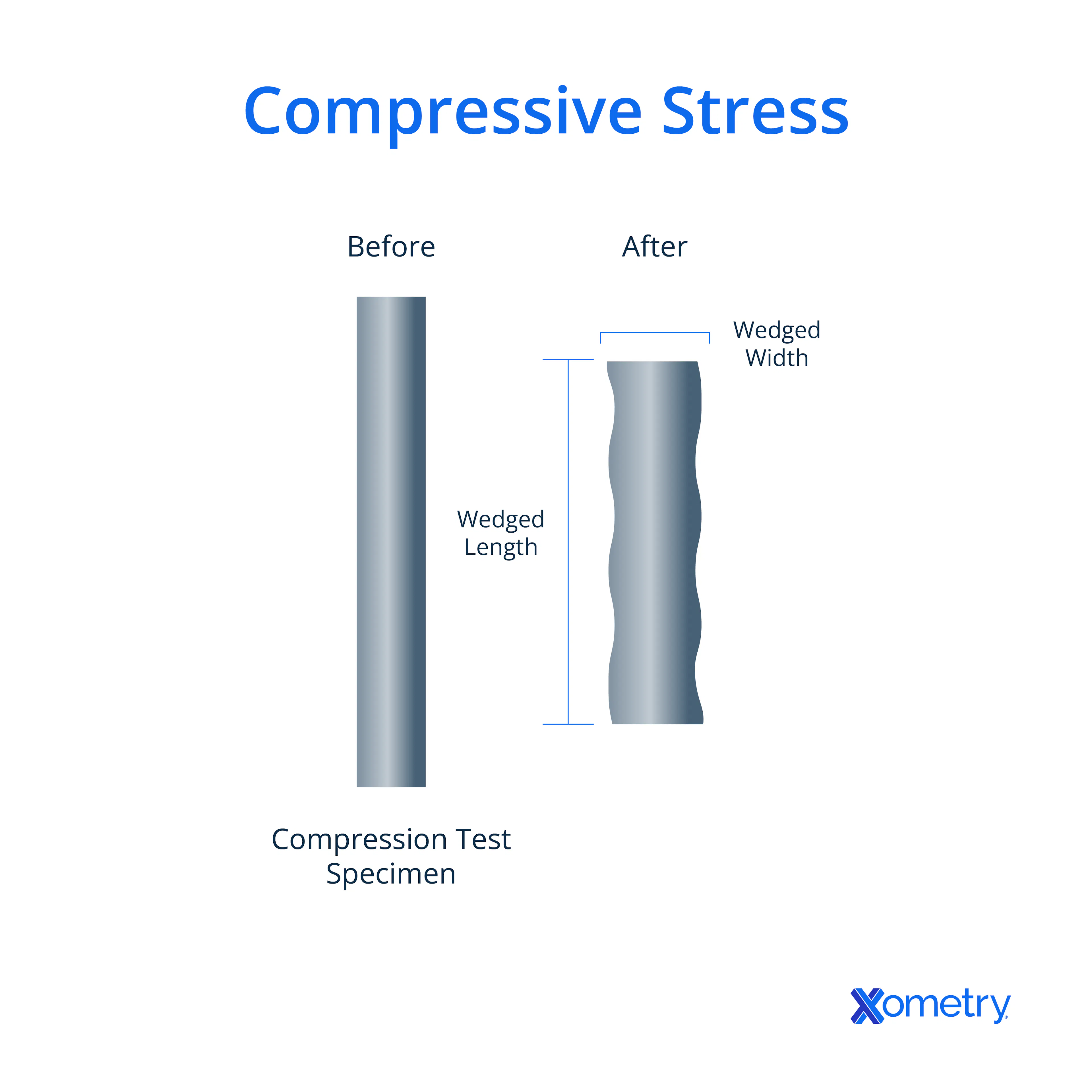

compressive stress test
An illustration of a compressive stress test.
