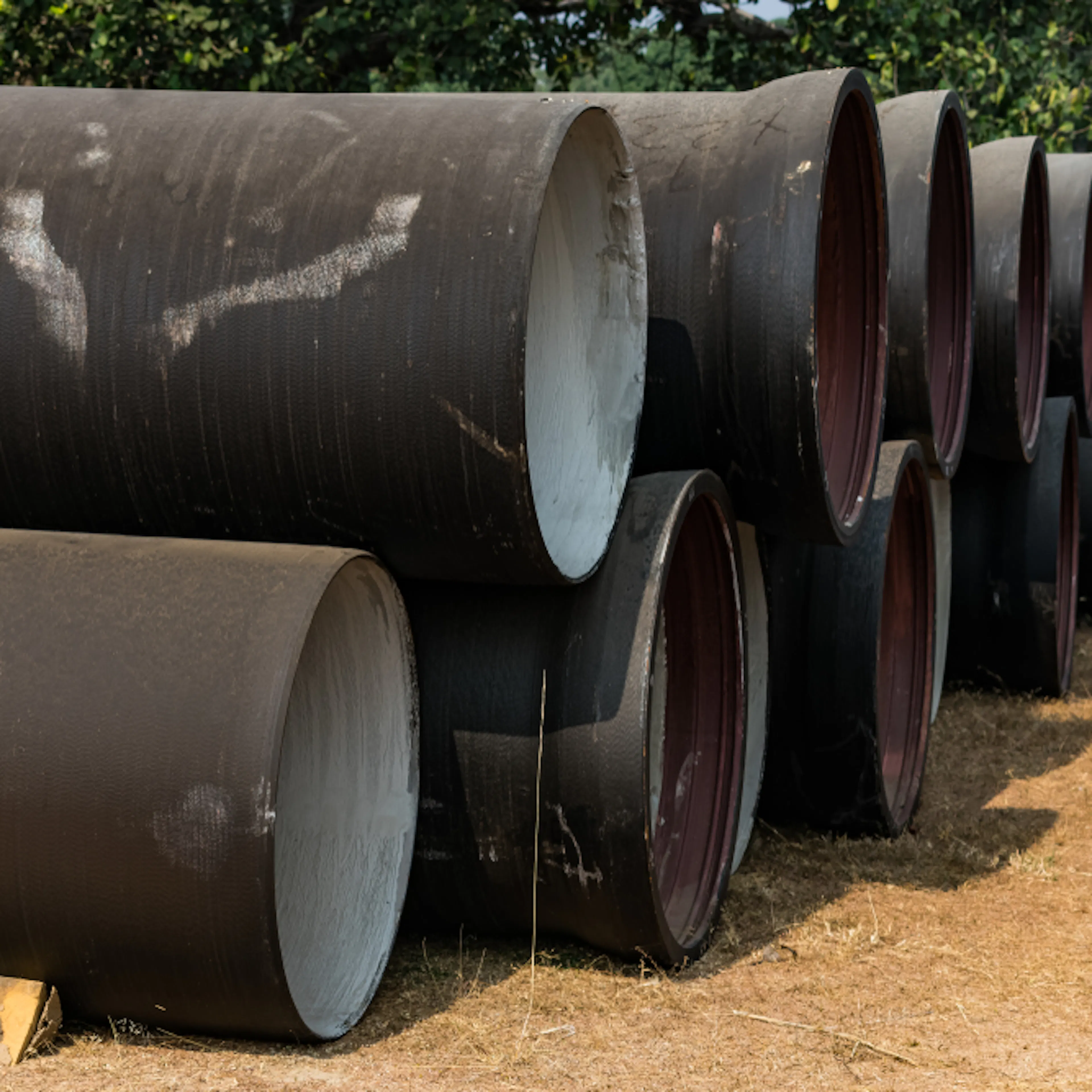

Ductile iron pipes. Image Credit: Shutterstock.com/mayank96
Ductility is a material's ability to undergo significant plastic deformation before fracturing when subjected to tensile stress. Engineers use standardized tests to quantify this characteristic. In these tests, a gradually increasing tensile force is applied to the specimen until it fractures or reaches a defined failure point.
