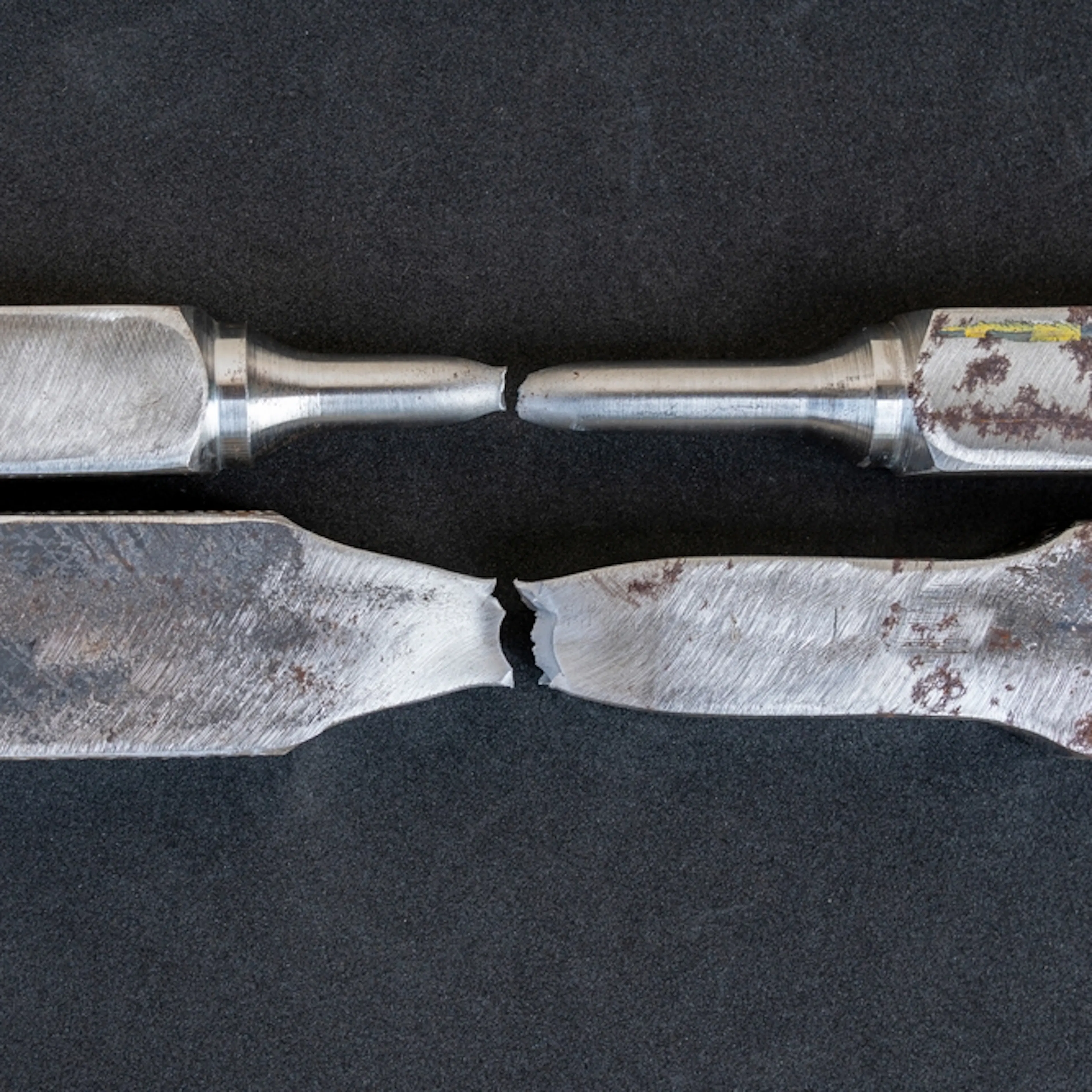

Learn more about how to measure this on various materials.
Tensile test for Young's Modulus. Image Credit: Shutterstock.com/Thaweesak Thipphamon

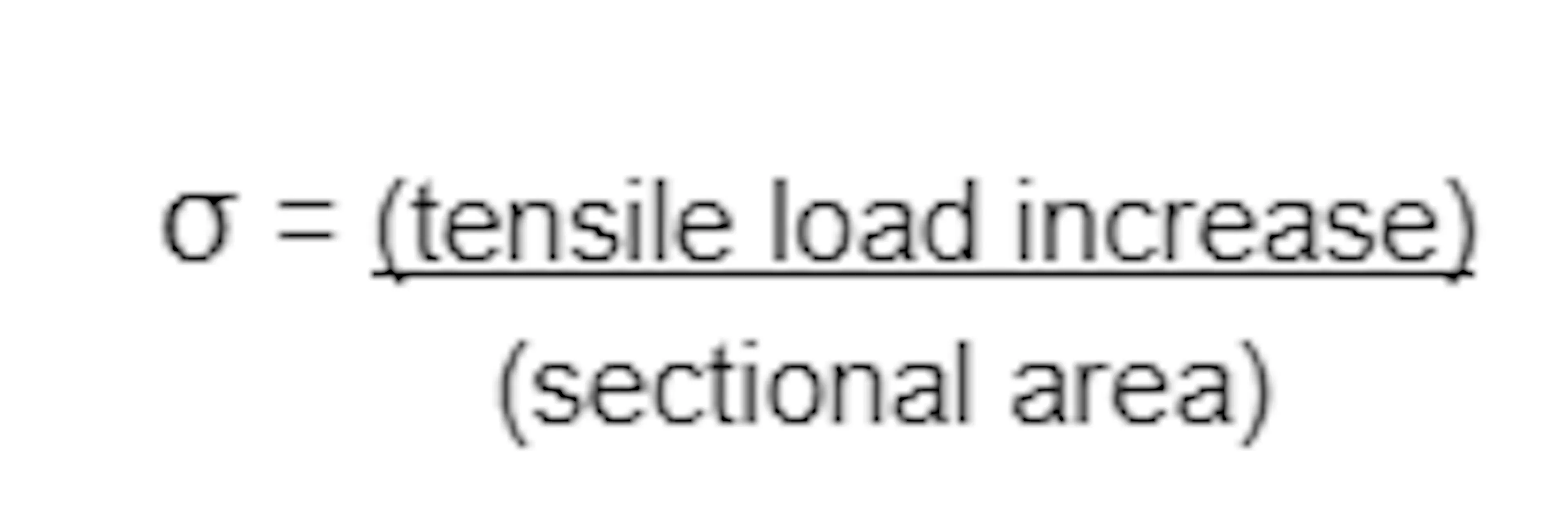

  • Stress, σ, is defined as the force per unit area. This is calculated by applying two load values to tension the strand under test and dividing the Δ load (the load increase) by the cross-sectional area of the strand:
Stress formula.
With dimensions in pascals or PSI

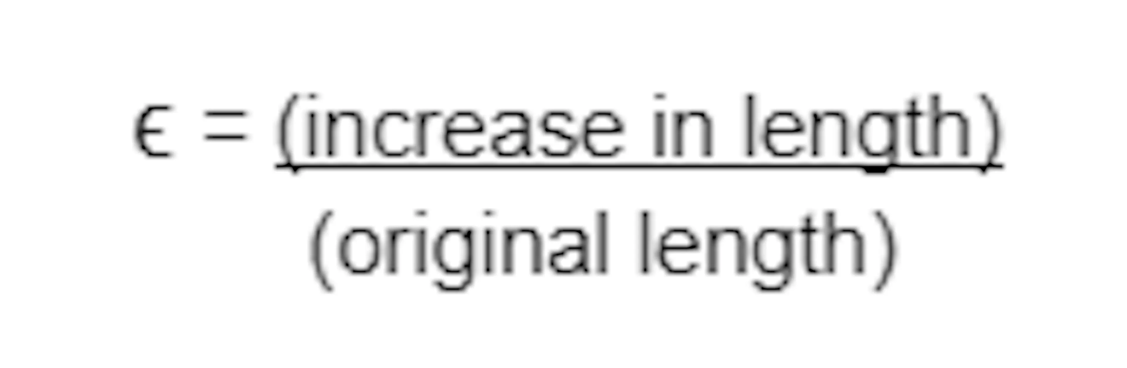

  • Strain, ϵ, is defined as the extension per unit length. Measuring the total length of the strand at the start load and end load gives a difference in length:
Strain formula.
